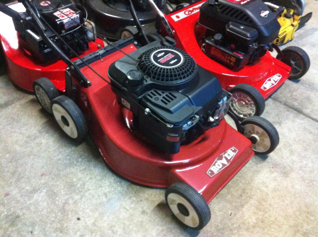

unknownVicta #56480 16/06/14 08:26 AM
Posts: 960
I've done a few of these but never sandblasting and powder coating.
A good scrub with a wire wheel on a grinder, a rub all over, etch primer, hi-fill, another rub down, undercoat and then finish off in 2 pac. they come up a treat, and far less expensive than sandblasting and powder coating.
Here's a few pics of some i've done in the past.
