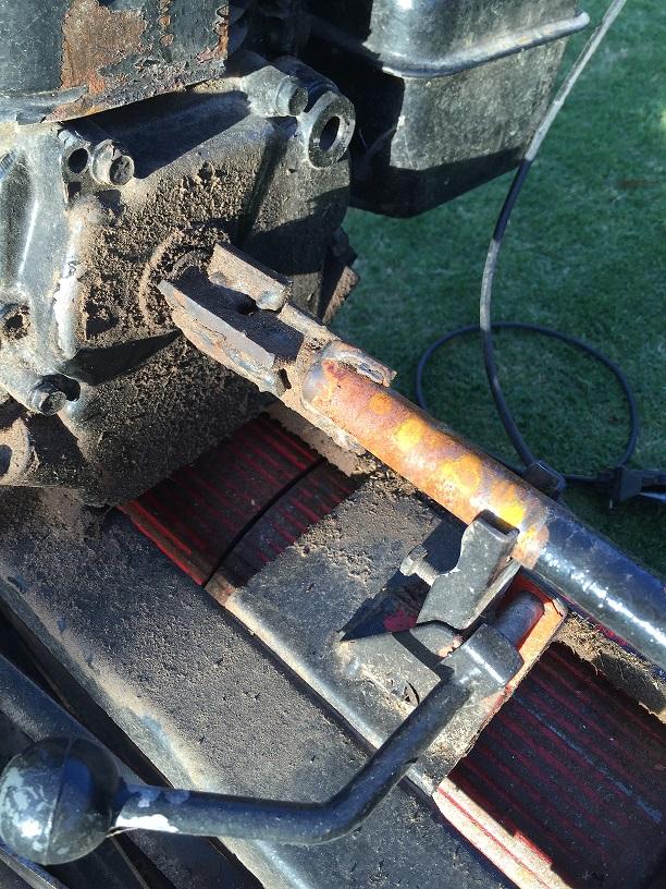

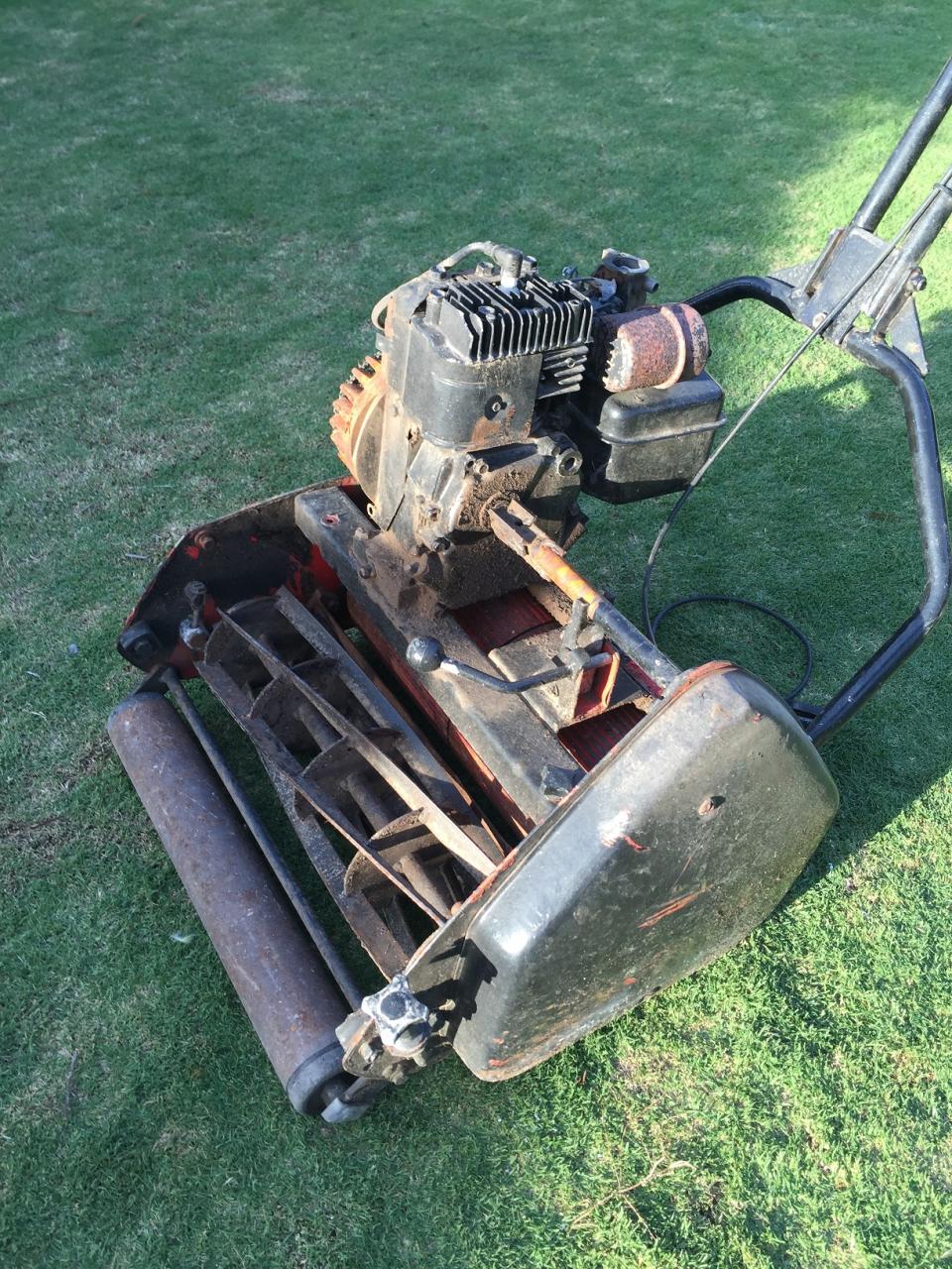

Attached are some photos. Have a laugh at the non-existing clutch housing and the galv sheet which I assume is a guard......to protect them from dodgy welding. shocked
As you can see, it's been hand painted black over the original colour Red.
Hi Corduroy,
Unbelievable !!!!!
Now I can say I've seen it all and can sleep peacefully tonight.
I've never seen such an attempt at bypassing a clutch assembly. It's a bit like welding a diff up for a skid pig.
Well enough of the shocks, so what you have is an early 1990's Rover Red. I'd say the engine is still the original unit but can now be rendered useless after you cut it free from the transfer shaft as it's crank is totally mutilated.
I guess my next question to you is, what is your ultimate goal with this mower ?
Only then can I advise you on the next step.
PS. Jack can you please put these photos in the "do not release as advise" file LOL !!
aaaaaaaawwwwwwww now c'mon there BB at least they tried to balance it !!!
MUST be what all the chunks of steel are for huh bigshock.
chainsaw Dave
Joined: Mar 2015
Posts: 102
Looks dangerous...That is a serious hack job welding the PTO shaft directly to the clutch drive shaft. You're looking at serious money if you decide on repairs. You'll need to go for a complete new clutch assembly (3 parts), including bearing, spring, cork, keys, a new clutch drive shaft, deflector (missing?), deflector clamp (missing?), catcher(missing?) and probably new engine crankshaft. Engine is not original? and it is also missing a fuel cap, air filter, air filter housing, flywheel cowling, recoil starter pulley, recoil spring etc. Can't really tell, but it looks as if the carburetor/governor linkages are toast too. Other issues will be worn bearings, sloppy front roller end caps and shaft wear. Only saving grace is a reel and bottom blade that might be in good condition for sharpening. I can tell you that a rough paint job (especially by hand) was almost certainly a way to hide any defects in this mower (of which there are many).

I understand where you are coming from as far as the amount of bits and pieces required to get this machine back into some sort of serviceable order, but as I have plenty of these in far worse condition then I could get this machine up and going in no time into a well running machine. I must admit I'm a tad perplexed at how you come to the conclusion that the engine is not the original. Personally I would hoik the donk back to the tip and find a suitable replacement, but for Corduroy before going any further I would check out the state of the rails and see if they are cracked, if they are then I'd use this one as a parts donor and bin the rest. Consider this xhall, at $30 you try and find any parts for these machines under that figure. If you only salvaged the reel and a few sprockets you've got your monies worth. Have you priced a bearing carrier lately ?

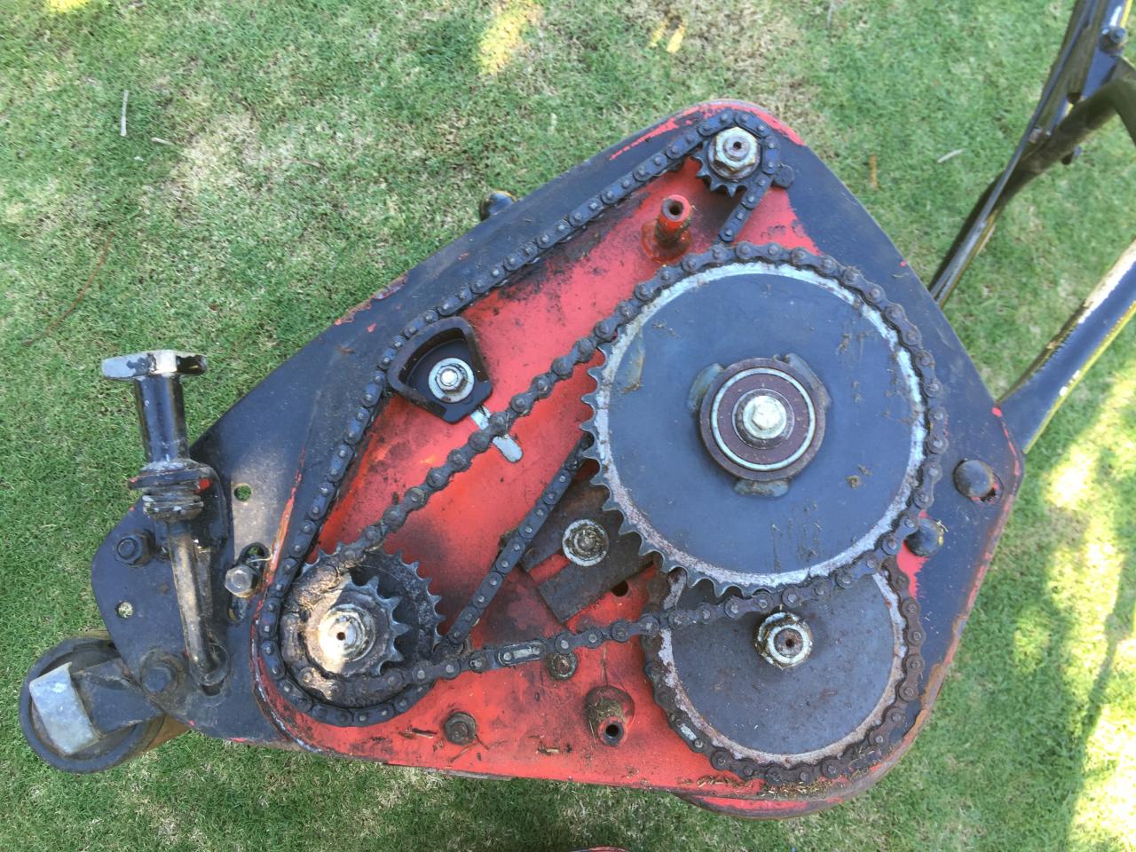

I'd like to see some photos of the drive train with the chain case removed.
Honestly I know it doesn't look good but sometimes after all the gunk is stripped off you might find a salvageable machine underneath.

The gears and chain appear to be in reasonable condition. I think the engine is the only part I'll be chucking. If anyone is in Perth, message me and you can have the engine for free....a lot of parts are missing though, fuel cap, air filter etc...

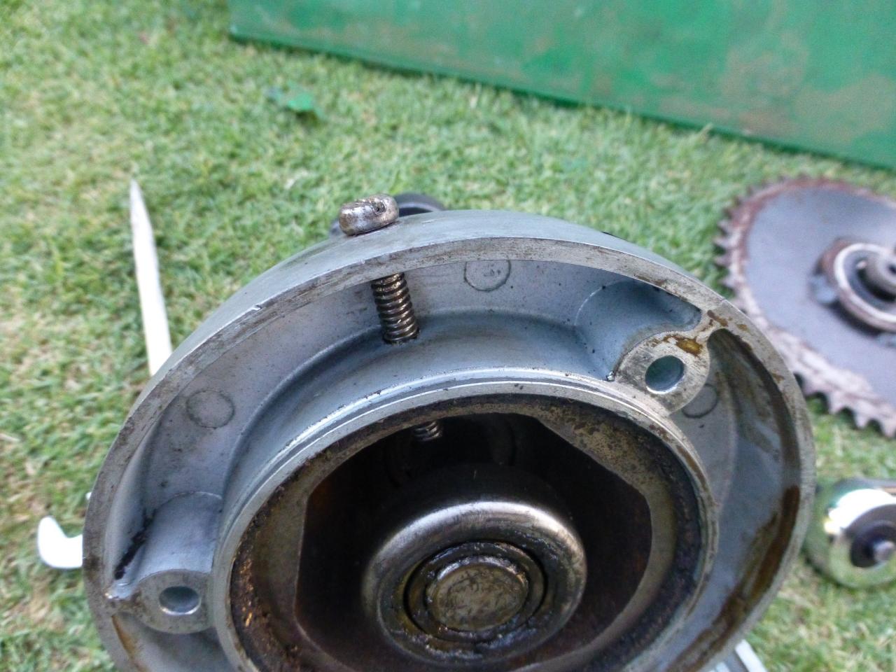

Finally, a picture of another persons attempt to stop the clutch from spinning from my last rebuild. If you have the right glue it is such an easy fix, rather than going to the extreme lengths to bolt or weld.

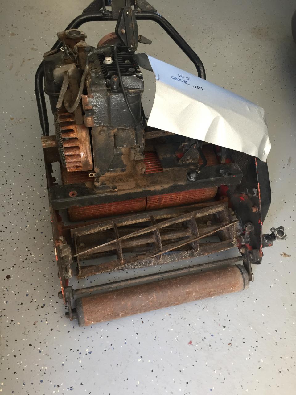

Hi All, A little late in updating....attached are some photos of my completed SB. Quite happy with how it ended up. Those with a keen eye may see a minor error.....
After
Hi Corduroy,
If you're implying that the Primary clutch lever should've been zinc plated and not painted black, then what about the power plant being Honda and not Briggs.
Regardless it's a credit to you and we rarely see a Rover Red rebuilt and in it's former glory. They were a vast optical improvement over that awful Kermit Green that they first used at Eagle farm.
Maybe I'm a bit biased as I like anything Red.
Red & white or Red , yellow and Chrome are one of the best marketing colour schemes and always attracts the eye.
Well Done !
BB AKA R45B at times.
