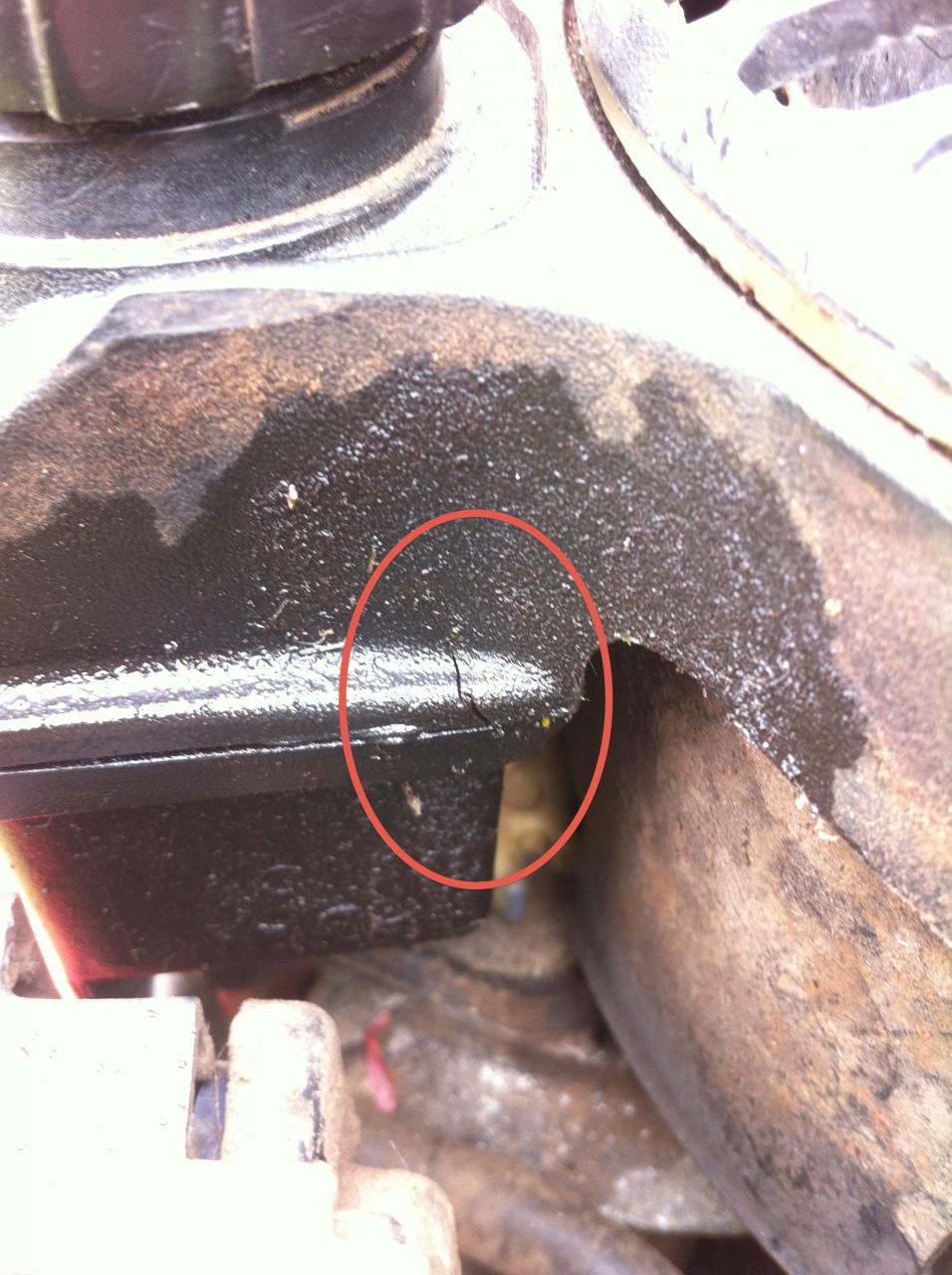

Here is a cracked tank on a B&S Quantum engine fitted to a 2001 Rover Premier Powerstart lawn mower I was working on yesterday. Note the fuel that has leaked out. It is surprising there isn't a recall in place for these tanks as they are potential fire hazards, which is not always apparent if the crack is covered by the plastic trim.
