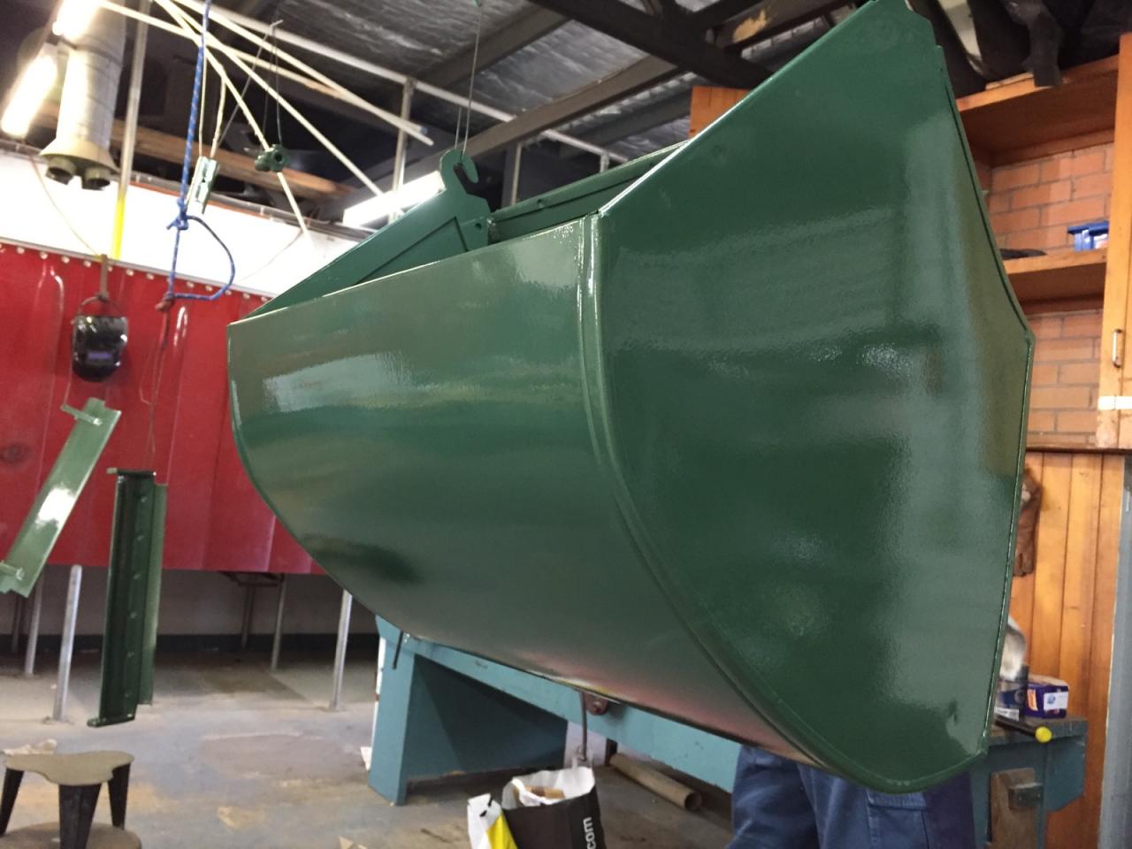

Hello again BB,
I hope you had a great Christmas and New Year break.

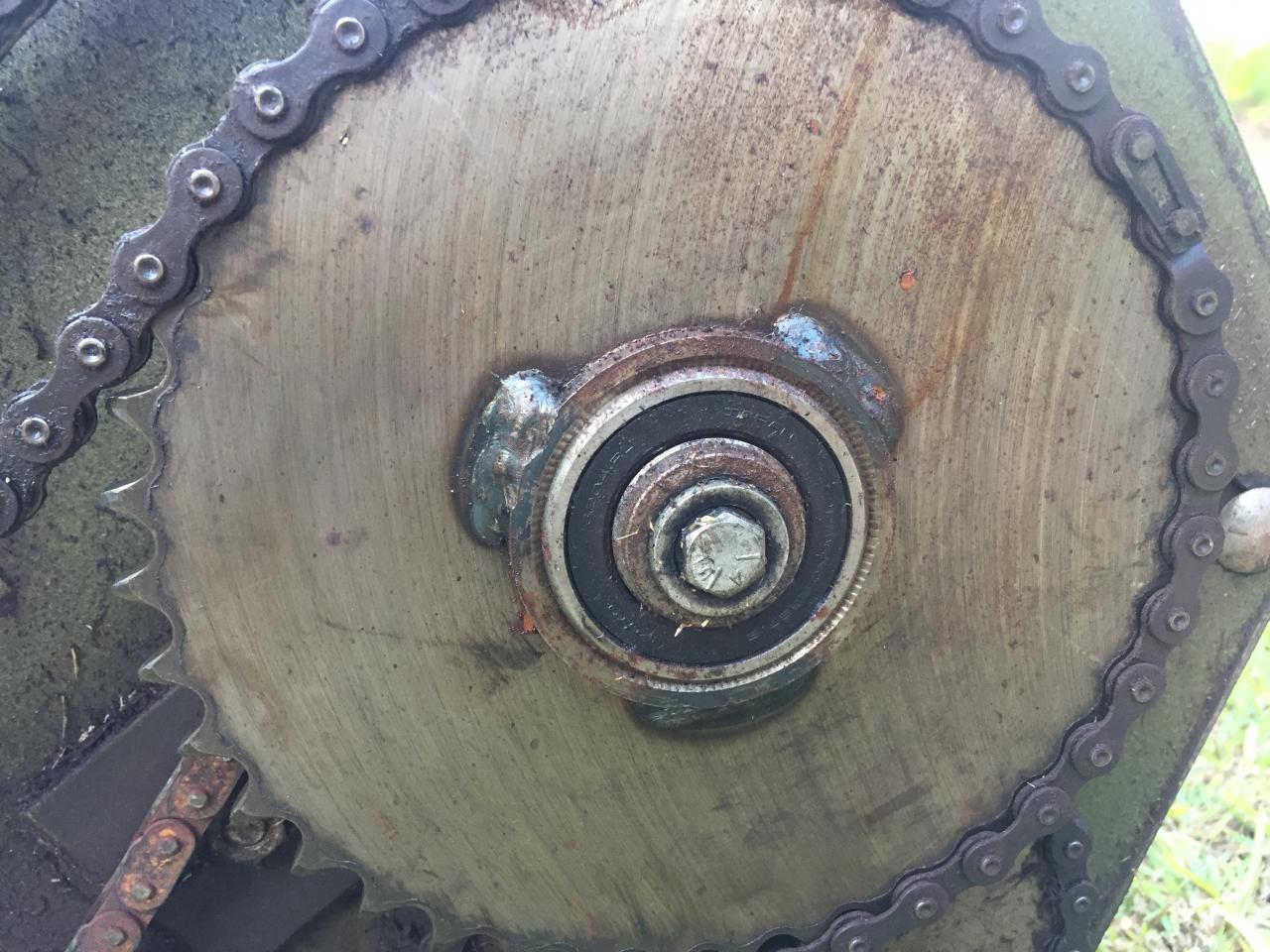

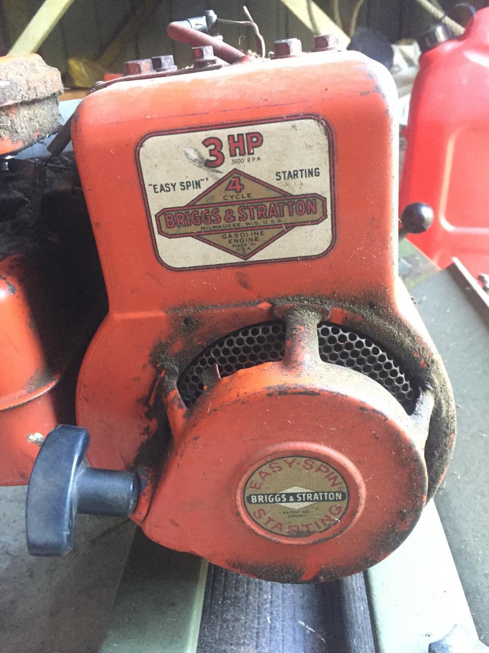

I got the 20 inch machine out today as it look like we may be able to move into our new house in late Feb, so I had better get a mower sorted! We're thinking of putting Aussie Blue Couch down because it stripes nicely.
Anyways, I had a look at the motor and I'm thinking that I'm best to just replace it. I like the look of the Honda motors that you can just 'swap' straight in. I have also seen that there are some 'Chonda' motors on eBay that you have recommended.
Here is what I found with the original B&S motor: [Linked Image]
The shaft is pretty badly damaged along with the inside clutch half. One of the head bolts is also snapped off inside the machine. Controversial.
I have 2 spare 17 inch machines here with decent clutch halves, so I'm thinking I will just be able to use one of those machines for parts? Do you have any advice for a suitable replacement motor for the 20 inch?

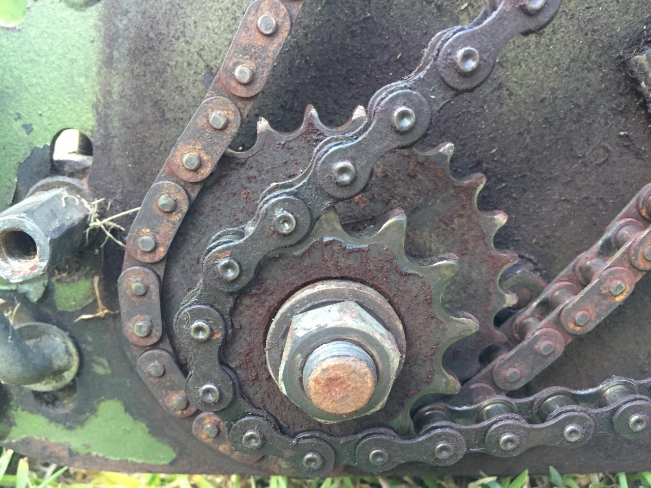

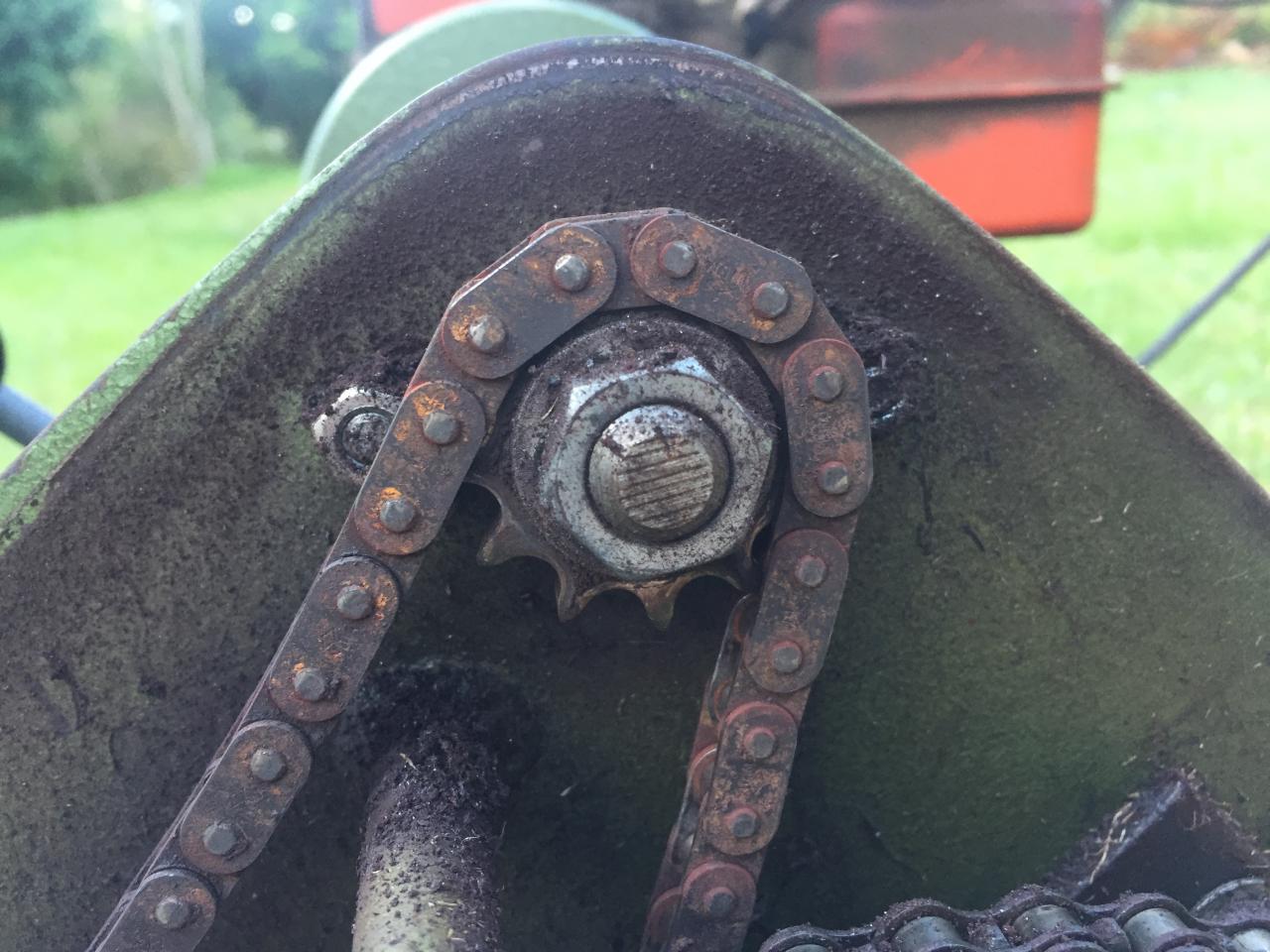

Here are some photos of the sprockets, reel and bed knife:
I'll be putting in the chain case for colour matching and then I'll be getting started with he paint stripping/sanding/paint prep. I think this one will be on the back burner for the next few weeks as I go back to work and we move in. I am hoping that it will be a much quicker/smoother process though now that I know the most effective and efficient ways to do things.

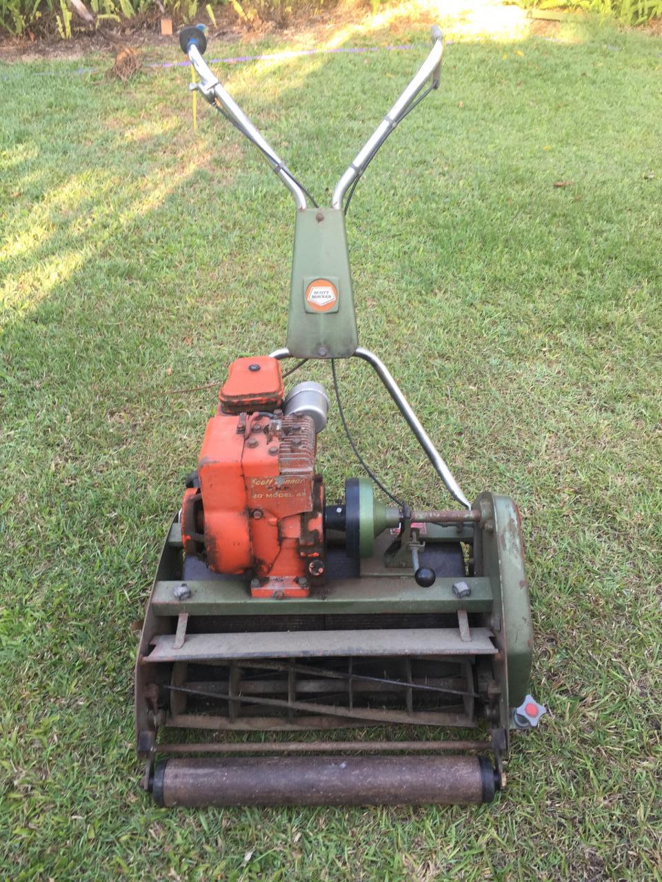

Hi Team,
It's been a while! We've just moved into our new house and the landscaping is about to start, which means I need to get a move on with the restoration of the 20 inch.
I have a few questions:
1. Does anyone know where I can source a stainless steel front roller with bearings? I have seen a few used in restorations, but have had absolutely no luck in getting one for myself
2. Has anyone ever had their rear rollers rubberised? Was this expensive and more importantly, was it worth it?

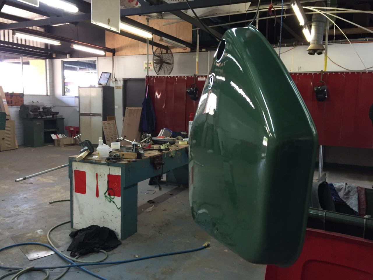

I'm going to organise for colour matching of the chain case and also take a few items in to be re-chromed in the next fortnight or so. It won't quite be a faithful restoration as I'm putting a new Chonda motor on it and may get some extra bits and pieces chromed. It'll be close though!
Hi Em,
Well it seems that I missed the original post in this thread, thus why I haven't answered it.
As far as paint is concerned could you please get whoever is doing the paint mixing for you to write down exactly what the tinters are and exact amounts used down on paper so that we can put it on the record as we asked these questions all the time.
A Chonda will be a good power plant for it and much cheaper than a Honda. If you do the routine maintenance on it it will last ages as they are pretty good now a days.
I had the bearing carrier tig welded as it's ally and not die cast as first suspected. It's stronger now than it was originally and also it was much cheaper ($30)It also required a slight process on the chaps mill as it had a slight twist in it from the breakage, thus now it has the bearing sitting totally square in the carrier.
I know a chap that does the rubberising of rear rollers but unless you are doing heaps of miles on concrete surfaces it's really not worth it as it aint cheap.
Your bottom blade is a beauty and will just need a light machining at the same time as the reel gets it's spin grind.
Your sprockets are all fine.

Long time no chat. Came across this article in the paper today. Wasn't sure where to post it. Been a bit busy so far this year so not much progress on the 20 inch but hoping to get to it shortly.
Hi Em,
Firstly good to see you are a financial member of the forum and enjoying all the benefits it brings. It's fantastic to have good people here.
Nice to see a shot like that in a major Newspaper.
For those unaware the machine pictured is a Series 2, 17 inch Scotty with a replacement Briggs & Stratton engine fitted. The machine was produced around 1978 and still going strong in a commercial environment, now that's saying something isn't it ?

Yes, I was pretty impressed to see it feature in the paper. Looks like it's missing a few parts though...

Alright - we're back on! Today I took apart the 20 inch machine. I think I'm going to approach this one a bit differently as I don't have much spare time when I'm working (currently on holidays for a fortnight though). I think I'll get most parts sandblasted rather than do it myself to save time. I've got a 6 blade reel with a bit of life left on it, but I'm thinking of getting a 10 blade instead.
I'll attach some photos of my progress.
I've found some rail fractures, so will use the gusset repair method as per last restoration. The ID plate is in pretty good nick, so I'm fairly happy about that.
I've got a bit of a question about the decals on this model though. You'll see in one of the photos that the handlebar decal is the Scott Bonnar shield, then the chain case has the older 'Scott Bonnar 45' decal (which I love). The chain case has definitely been painted again, so I'm guessing the previous owner must have switched it over. Am I right in thinking that the chain case decal should just be the plain 'Scott Bonnar' text one?
I'm having some trouble getting the rear rollers apart. I've taken out the screws that keep the 'inserts' together, but I can't pry them out. Anyone got any suggestions?? I've seen posts where people have had them totally dismantled, but I can't get mine to come apart!
I need to dismantle them as I'm going to get the rollers vulcanised with rubber. I've left them soaking overnight so hopefully I have some luck tomorrow.
I was originally set on getting the handlebars re-chromed , but they don't look too bad, so I think I'll see how I go just cleaning them up first. I've also got a new clutch half as I'm planning on putting a Chonda GX160 copy on it. I've got a brass thrust pad on it's way too - any ideas of what I can use as the fibrous washer that's meant to accompany a brass thrust pad?
As always, your opinions and feedback are appreciated!
