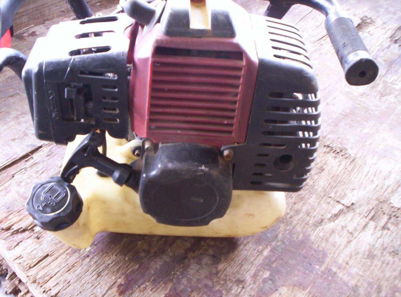

I have a 2 stroke post hole digger but it has no name on it. It has a carby problem because it has spark and will fire with a squirt of starter fluid. I haven't pulled the carby off yet but was wondering if there was anything to look out for?
Posts: 693
Have you changed the fuel pick up filter? Most times that is the problem rather than the carby itself.
Posts: 8,176
Likes: 232
Thanks Trev, I have cleaned the filter and it flows freely, but still no go, problem is I have no idea of the brand so I can't chase a new carby.
Joined: Jun 2014
Posts: 17
To me it looks to be a BBT post hole digger or something like that, most likely around the 62cc size engine. Though they come out in 52cc up to 88cc. Hope this helps.

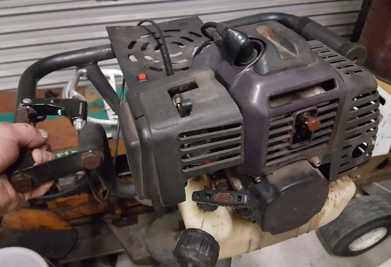

I just fixed up this... For a mate. I'll see him tomorrow & ask what info he has or knows..
On this one It has a decomp button (I think) (See pic #2) above the pull start... It has to be pushed in to start once it starts it pops out & away she goes.
Have a check of the primer bulb, when I took it off a small orange'ish rubber mushroom looking thingy fell out. I worked out that it had come out of its hole. This thing is like a one way flow valve, It has a almost invisible slit through the center of it so when the primer bulb is pushed it's forced through the slit & in to the carby. Check & make sure it's seated all the way. sits flush (no gap)..
And put on a brake lever for the throttle & the kill button

Thanks Paul, looks very similar, gearbox looks the same. Mate has 2 of them one a 4 stroke, which the clutch was slipping, I swapped the motors over and that seemed to fix the problem on that one but I would like to sort this 2 stroke one out, spark is great, compression is good, just doesn't want to play ball
