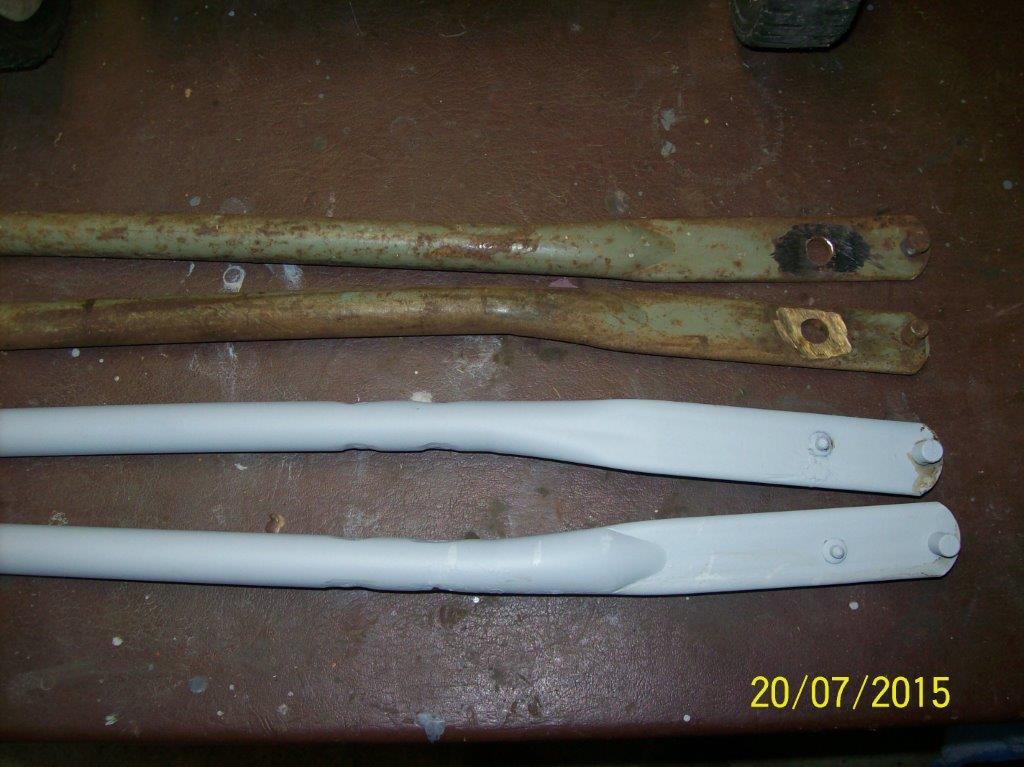

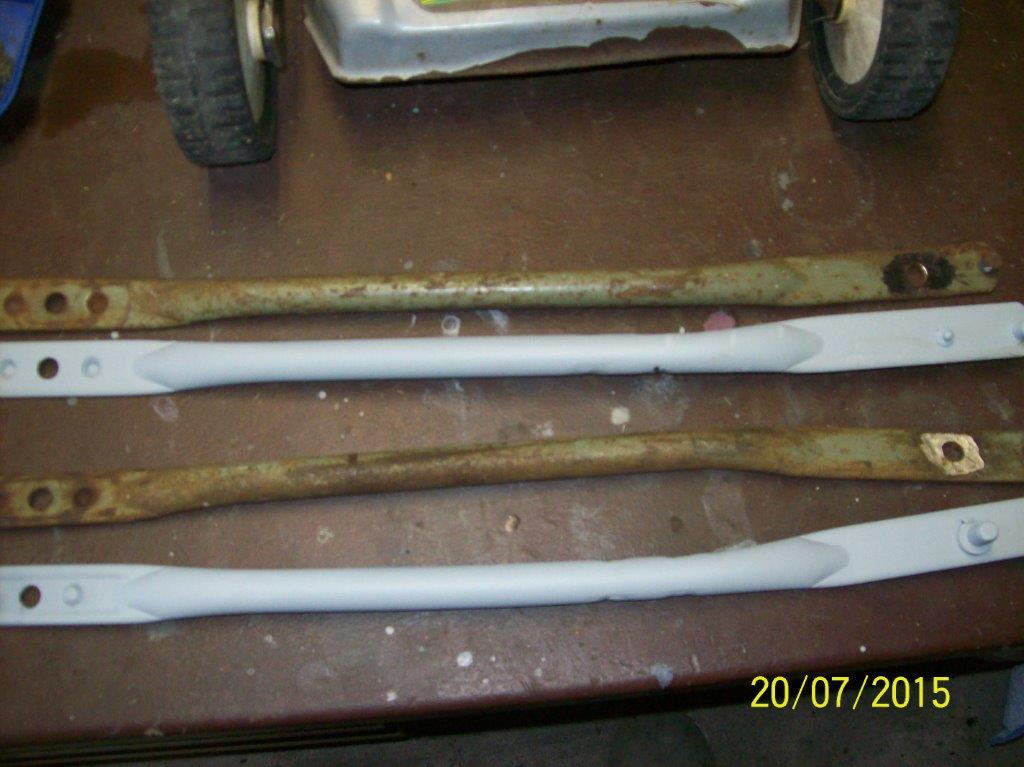

OK I hope this shows you what I'm talking about.The ones in the grey primer are the ones off the VC-125 Mark II.The green ones are the Impala 2's.
So as you can clearly see the two bottoms ones in this picture are bending in the opposite direction,and the top two are identical.
This is them sitting on top of each other.They are all facing the same way,but bending in the opposite way.
The top grey one has the flat side facing us,but all the other ones have the rounded side facing us.
You can see why I can't use the green ones as some fool welded a large rod through them that's why the holes are so big.

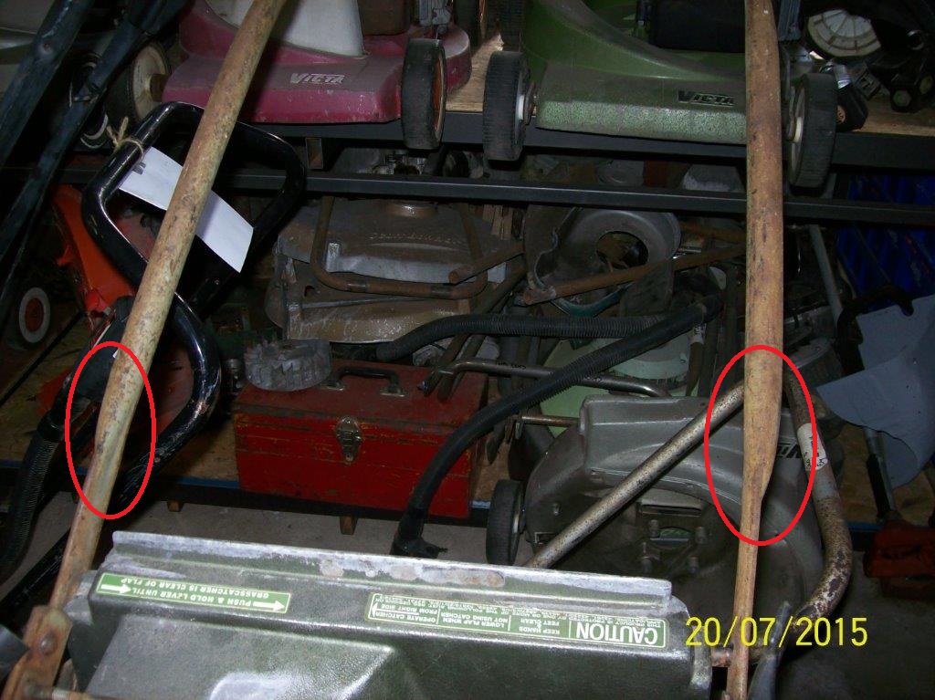

This is the VC-125 mark II's handles on the Impala base.Just note where the flat surface is compared to the rounder area of the handle is.Pictured here in the red circle.
Here you can see the Impala's handles with the flat surfaces facing together and the rounder part away from each other.The VC-125's don't go that way.
In-fact that's how they are on the VC-125's,except the Mark III.
I guess the only ones to have this handle set up is the Impala 2 & 4's and the VC-125 mark III.Which is going to make it very difficult to find one.
