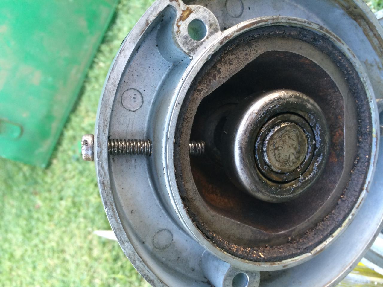

Below is a picture of the bolt. I removed the nylock before taking the photo. Being a small hole I don't think it will cause vibration issues and at worse it could let in dirt. Due to the cost of these I will find a way to plug it up before I paint it.
Hi again Corduroy,
Wow! I have seen some "tenants improvements" but I have never seen that before... WTF
He has drilled right through the clutch cone, (which is cast iron) to obviously lock the whole clutch in the engaged position.
I would guess that the clutch was out of adjustment and was slipping (or grabbing) and this nut and bolt was his 'fix'!
Corduroy, what you will need to do now, is to remove the bolt, remove the bearing (it should be in the other (inner) clutch half anyhow); check the serviceability of that bearing, (replace if in any doubt)...check the engine clutch spring (if its still there, it may be missing)
Next job will be to remove and renew the cork, it appears to be well past its used by...
Next is to inspect the clutch cone for any damage caused by the drilling. The outer champhered face needs to be free of any burrs or anything that can catch on the cork during operation...perhaps a very slight countersink of the hole in it followed by a sand or bead blast to restore its surface to as new condition would suffice. You could then mask-up and paint the cone. wink
I can step you through the adjustment procedure once its all back together, to give you back a functioning cutter clutch once more. wink

Yes, I agree that would have been the reason. I have had clutch slip on my mower before but would never go to that extreme. As you know you won't be able to stop the reel from spinning. I have two kids so a spinning reel poses a safety risk when you take the catcher off.
Thanks for explaning all that. I have replaced the cork pad before so I am familiar with the setup.
