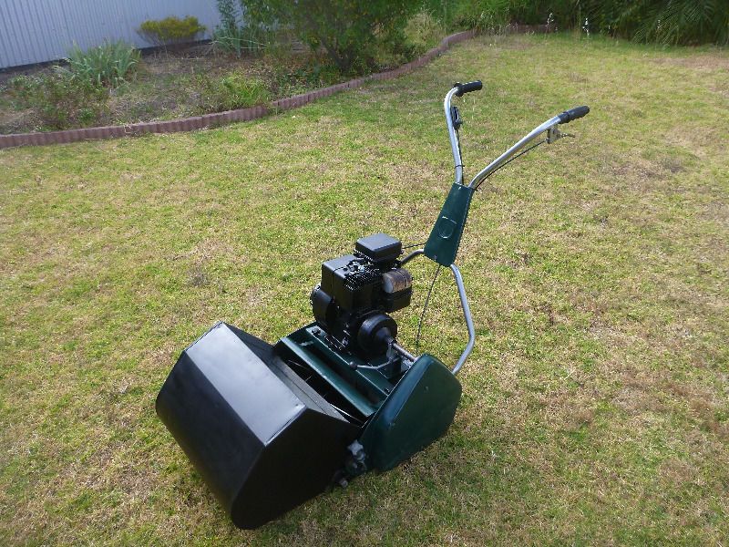

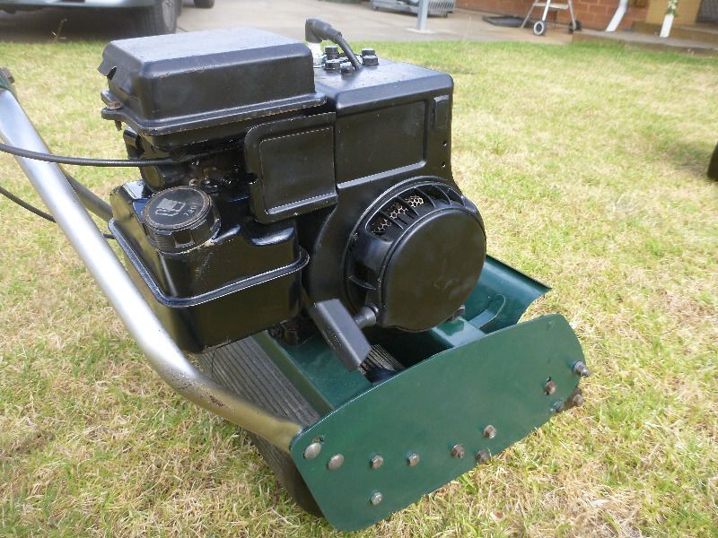

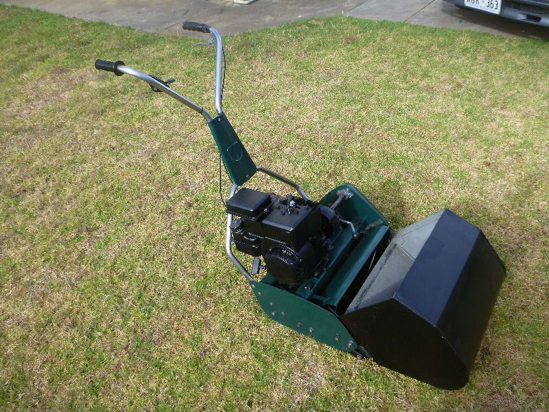

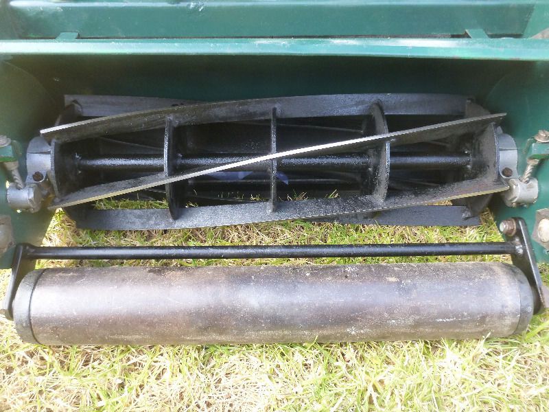

I'm planning on having a look at this mower on the weekend; ($550 - is there anything from these pics you can tell me?

In the meantime, my observation from the photos is that this looks like a sound machine.
Most importantly, this machine appears to have a newly sharpened reel and bottom blade.
The reel appears 'straight' (no bent blades).
It has a non-original fabricated grass catcher with good serviceable life.
The engine is a replacement one (I think).
If you intend buying a powered reel mower then the Model 45 is a safe choice.
It was/is Australia's best domestic reel mower and its design has passed the test of time.
I do not see any alarm bells in the photos you have given us.
More information will follow from the expert(s).
Hi OCDirt, and a warm welcome to the forum. It is nice that you have asked for some advice before purchase, and to have you aboard. We all like to learn new things and tinker here. wink
My thanks to CyberJack for his observations and I will add mine to them....
This machine is a 'Series 2' Model 45 with the twin rail engine deck, (which are prone to fatigue cracking under the engine mounting points) but that is a prob easily fixed. wink
This machine appears seller refurbished and the Briggs and Stratton has been replaced, in my opinion by a later model, it would be handy to have the complete string of numbers (Model, Type and Code) that are stamped into the metal air cowling of the Briggs for which we can get the date of its manufacture.
I would also like to take a peek into the chain case on the left hand side of the machine (looking from the rear) to check the serviceability of the chains and sprockets, as to replace the worn ones would prove expensive. wink
All in all, it appears to be a nice tidy refurbished machine...the fatigue issue would have been addressed before repainting, if indeed it had one, and the cylinder reel has a lot of 'meat' left on the blades for regrinding in the future. grin

From your pictures, it looks to me like it's had some repair work done to the front rail around the engine mounts. I would have a close look at that to make sure that it's been done right. I agree with Jack and Darryl that the engine doesn't look original. For some reason the air cleaner cover and fuel tank cap look to me to be older than the cowling. If a newer cowling has been swapped onto an older engine, that will make dating the engine much harder. I'm really only guessing though. The main considerations will be the condition of the chains and sprockets, as Darryl has mentioned, and how the rest of the machine runs and presents overall.
Thanks, Michael
I agree with rolla 16v that there are some suspicious marks on the front rail near the inboard engine mounting point. You should look closely at the underside of the rail to see if it has been broken, then welded up to repair it. If that has happened the frame alignment could be in doubt. The engine-side clutch half has set screws rather than a captive cotter, which may mean that it has been replaced. Failure of the original captive cotter clutch half seems to be a common cause of cracking or fracturing the front rail, so it may be that the machine's history is starting to unfold before our eyes. Coupled with the replacement engine and catcher, and whatever doubts there are about the possible alignment problems in what may be a broken-and-repaired frame, this does not strike me as a very original or high-quality SB45.
At $550, if the chains and sprockets turn out to be new, and the engine was bought new as well, adding in the approximately $200 the aftermarket catcher would have cost, the price is in line with the cost of materials to carry out the refurbishment. However it is very important that the frame alignment is correct after the welding repair that seems to have been carried out. The reel looks to have a reasonable amount of life left in it, though it seems to have had at least one heavy resharpening operation, and I can't see the bedknife to see what condition it is in.
Hi grumpy and ODK members,
In my opinion, it is very hard to tell the condition of a machine, especially frame alignment issues from photos. I believe that a thorough inspection of the machine, in person, before purchase should be carried out, where possible...if not, it could be a case of caveat emptor.
If the front rail was cracked and professionally repaired, there should be no alignment issues, and the bottom blade would have been ground at the same time as the reel, and if found unserviceable, has been replaced, I would imagine, as they have replaced other components. wink
This machine may have had a hard life, but one thing is assured, they are a robust design, and if repaired and correctly maintained, will last a lifetime. wink
I agree, Deejay. The trick is to verify that the work has been expertly done, before buying the machine. For me that would involve taking a good look at the suspect rail, especially from underneath, and talking to the seller about how the repair was made. A workshop would or should have set the frame up on a flat surface and checked it repeatedly for alignment while welding it in very small increments.
