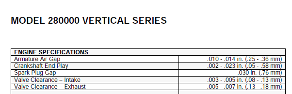

Here are the required clearances:
The Intek is an unlovable engine in my opinion, but with careful maintenance as prescribed it can give good service, though it may require occasional repairs.
