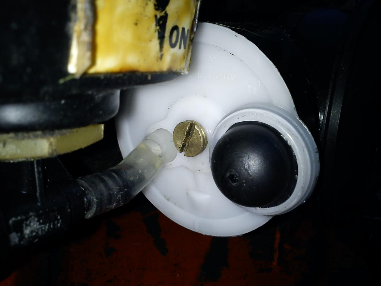

As an aside I notice the jet screw has no 'groove' 'man':-) which it should have right? for an 85cc?? Anyway it ran well enough before so I've ordered needles and other stuff and can't find a 'Groovy' jet anyhow so when the needles arrive I'll let you know how it goes.
Here's a picture of jet screw head on new primer cap.
Theres also no little bit of gauze over the jet hole, I took the plastic tube out and there is no obvious taper to the hole either.
