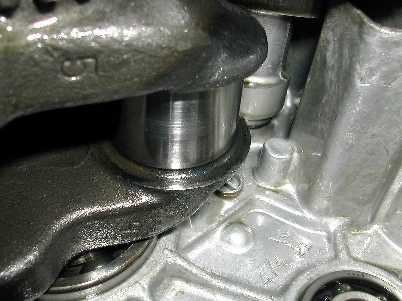

Have piston out & am inspecting cause of knocking under load.[Linked Image]
That engine has replaceable bearing shells, it doesn't have an aluminium connecting rod that serves directly as a bearing material. Presumably the connecting rod is steel. Most likely you do not need to replace the rod, just the bearing shells. The upper shell looks as if it has worn through its babbit or trimetal layer, in the center.
I can't judge so far whether you have a problem with the condition of the crank pin. There seems to be some scratching in the center, in the area that has been in contact with the backing metal of the bearing shell, but I can't see whether it is serious. If you can feel any roughness or striations around it, or detect any circumferential scratches, it would be better to use one of the other crankshafts.
How many hours has the engine run? So far it looks more like a worn out bearing than an abused one.
The cause of the knock from a big end bearing is slack. The most accurate way to measure the slack is with a product called Plastigage. It is just a piece of small diameter plasticene-like material. You put a bit of it in between the connecting rod and the crankpin, and assemble the big end, torquing the big end bolts to the correct tension. Then you disassemble the bearing and check the width of the squashed piece of plasticene against the gauge that comes with the kit. It tells you how many thousandths of an inch of clearance the bearing had. From memory (big end bearings seldom wear out these days) you can hear annoying bearing rattle at 0.003" clearance, and if you have much more than that it sounds as if it is about to break something. It is impossible to maintain a proper oil film in a loose journal bearing, especially with splash lubrication.
Incidentally I see the engine has a pair of counter-rotating balance shafts, to reduce vibration. The larger single cylinder Briggs engines tend to have either a reciprocating weight, or a pair of shafts, to do the same job. Large single cylinder engines produce considerable vibration unless you do something to counteract it.

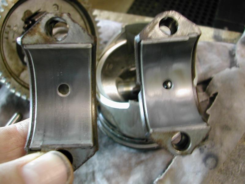

Joined: Feb 2011
Posts: 510
Thanks for your words & time Grumpy.
I realise it is hard to comment from your distance.

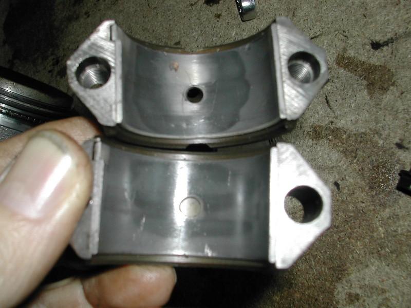

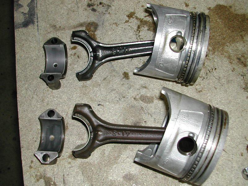

The images below show the 2 pistons, the bottom one is my spare.
The connecting rods are mumbered differently, not sure about that.
The image of the bearing shells are off the spare aswell.
They are damaged/marked as you can see.
I used my finger nail to try & pick up scratchs on the crankpin.
It was smooth as a babys you know what in places, but I did feel ever so small grooves with my finger nail in other places.
Think I will buy a new connecting rod.[Linked Image]
Mark, the bearing shells can easily be pushed out of the connecting rod, either with the point of a knife or sometimes with the tip of a screwdriver. They are only held in place by the slight springiness of the steel backing of the shell, and the small tang at one side of one end of each shell (just above and to the right of your thumb in the last picture). Replacing the connecting rod is unnecessary unless it is defective - normally you might or might not replace the bearing shells when you put an engine back together, but at this point I am not sure I see clear evidence of enough wear on your mower engine's big end bearing to cause a significant noise. The wear pattern on the upper shell of the engine from your mower is assymetrical, indicating a connecting rod misalignment, so it would be worth while using the other rod in that engine. Correcting the misalignment by bending the rod is possible but not recommended for the inexperienced. I also see you have steel rail oil rings, which seldom wear enough to pass oil in any normal lawnmower's lifetime. We should now look for other causes of your knock. One possibility is a loose pulley on the crankshaft extension - the double pulley that drives the blades and rear axle. Another possibility is a problem in the cutter shaft bearings. As I said, without hearing the noise it is a bit difficult. Did the noise occur if you revved the engine with the cutter and wheel drive clutches both disengaged?

I think you have done the right thing, and there is a good chance you have fixed your knock - I can't tell from the limited evidence that has been posted. I'll try to clarify what is going on, Mark. Look at the upper shell of the big end bearing of the rod that was in the mower. It appears to be worn through to the backing on one side, and the wear pattern does not even reach to the other side. This means the connecting rod is bent: the gudgeon pin hole (or little end) is not parallel to the crankpin hole (or big end). As a result big end lubrication has been a bit poor, and equally importantly, the contact force has been concentrated on the outer edge of the bearing shell, causing excessive bearing pressure, and physical contact with the crank pin at times, leading to wear. Compare this with the bearing shells of the other engine: the wear pattern there is just about ideal, except for not extending all the way around the shell. In other words that rod is not bent. The bearing may have done a lot of work and gradually accumulated some normal wear, but it is still a healthy bearing.
What we don't know, is whether the failing, unhealthy bearing that was in your mower engine, has already generated enough slack to be making a loud noise. The only way to find that out would be with Plastigage: because the rod bearing has now worn tapered due to the misalignment, it isn't completely practical to measure it with a micrometer. So, you have made the right move by replacing the bent rod with the straight one from the other engine, and temporarily using the bearing shells from the other engine's rod. (They were already in the rod, and are therefore now in the engine.) If your knock was from that worn, tapered big end bearing, this should fix it. If the knock was external to the engine, of course it won't fix it, but you will still have fixed a significant fault in the engine. One day, when the engine is in need of overhaul, you could fit new bearing shells, but it doesn't seem an urgent issue to me. Now you can start the engine, and see if it runs properly and quietly. If it does, but there is a knock when you put it back on the mower, then you can find the external problem causing it. In the meantime, while isolating the cause of the knock you will also have fixed a developing problem in the engine, so your time has not been wasted.
To get the smoky engine ready for service you need a good rod for it. I suggest you should not fit the bent one from the original engine. If the bearing shells are still in the rod from your remaining engine, you can check the wear pattern and see how it looks. You might post pictures of the shells here: it will improve this thread, and who knows, we may be able to help you figure out how things were going in that engine during its lifetime.

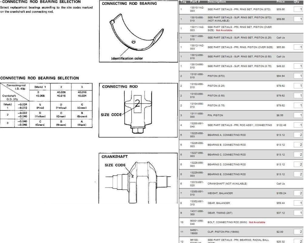

Joined: Feb 2011
Posts: 510
Thanks, great stuff.
Have researched bearing shells to add to this thread. (you must get the right ones).[Linked Image]

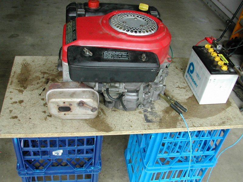

Joined: Feb 2011
Posts: 510
Engine fired first start & ran fine, no load, nothing unusual heard.
I wont be able to fit this engine to ride on for a while, to test it under load.
I will report back in with results when I do.[Linked Image]
Thanks Mark, it sounds as if at a minimum, you have extended the period until that engine will need an overhaul. If the mower is now quiet, you've fixed your problem. Are you going to overhaul the smoky engine right away, or put it aside until you've got the mower working again? If you overhaul it, it will be useful to this thread to show us what the big end bearing from the spare parts engine looks like, and whether you decide to use it to build your spare engine.

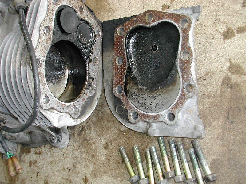

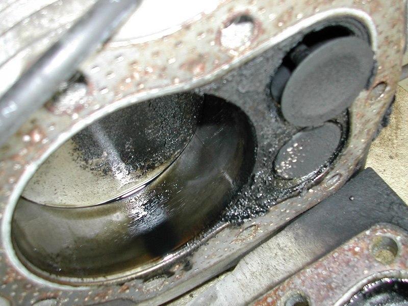

Have started to strip engine that was hard to start & blowing smoke.
Do not know the history of this engine.
I would like to try & breath some new life back into it.
I have a new set of rings & some gaskets, life is good.[Linked Image]
The bore seems to have some vertical marks, which might suggest that the engine has been run without an air filter. It doesn't look too serious, but the marks will need to be honed out and of course the rings replaced. The piston may have matching marks, which doesn't necessarily matter much. Are these old pictures? I thought you put that connecting rod in the engine with the knock and the misaligned rod?
I suggest you take a look at the valve seats, since it was hard to start. It's easier to do these things while it is in pieces.

Grumpy, no these are not old pic's, The con rod & piston I used previously were out of my spare engine that was in pieces.
This is a complete engine that I have opened up for the first time today.
I have heard it running when I bought it, it blew black smoke & was started with a small spray of assist.
I will check the rings for matching scratches.
I will hone the bore & replace the rings.
The valves are another story, I have only just got a lapping stick & paste, I have watched a few U tube videos, thats the extent of my experience here.

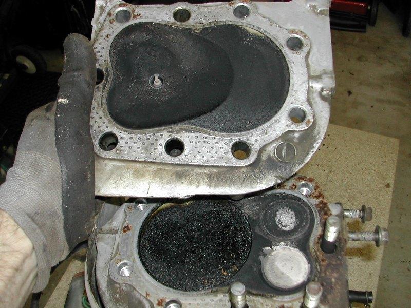

Here are the images of the smokey engines bearings to compare.
Great stuff, I set aside this weekend to sort out these engines so I dont have to push my super 24inch 2 strokes as much this spring, I will be able to sit down & mow.
Thanks for your words & help this weekend, another week of work & I will attack this engine again.[Linked Image]
The wear pattern on the bearing shells looks nice, they should be good to go back in. The exhaust valve seems to have been leaking a fair amount, and the intake valve seat has black areas too, so they both need lapping. Remember, the most important objective when lapping is to ensure that no trace of lapping paste gets on the valve stem and finishes up in the valve guide: that would ruin it immediately, and cause a problem.
The balance shafts, and of course the camshaft, have to be timed correctly when you put them back in. There are timing marks on all three gears in the balance system (the one on the crankshaft, and the ones on the ends of the balance shafts). There should also be marks on both camshaft timing gears (one on the crankshaft and one on the camshaft gear). Don't feel certain there will be, though: I have a GXV120 that had no timing mark on the camshaft gear. Fortunately I checked before I dismantled it, and made my own mark.
Note that black smoke is not oil smoke, it is petrol smoke caused by rich mixture. The engine does seem to have been burning oil, though, by the look of the top of the cylinder in your pictures. When you take the piston rings off the piston, you can check the ring gaps to find out how worn they are. We can talk about that when you get that far.
