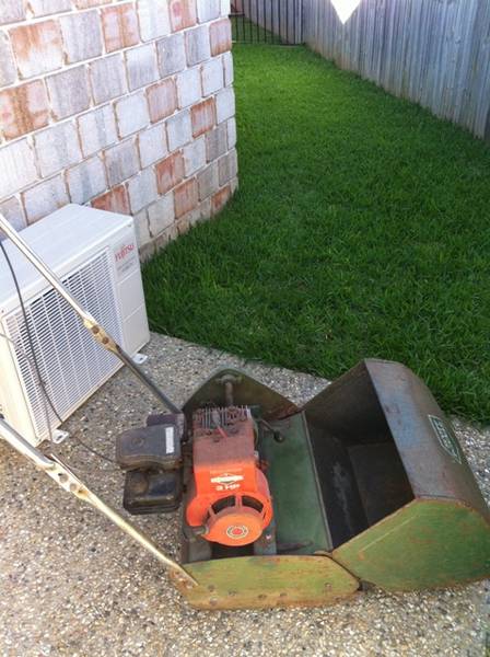

Here is a pic of the SB when I first bought it, Im not sure what year it is but I think its from around the 1975-1980 range. I have 2 SB one is my dads which I am not going to touch as everything on it is completely original it has a 2.5 hp B&S on it and it is what I have previously been using as a working mower. I will post some pics soon with the parts stripped. When I do I will get some close-ups of the cogs etc. as I am not sure if they will need replacing or not.
Hi WalterP, and a warm welcome to the forum. It's great to have another Scott Bonnar Model 45 owner aboard. grin
As this thread is already a mixed thread with Jamskin2 and Manch, I would ask you to start a new thread for your restoration in: Forums > Restoring and Customising > Reel-Type Mowers. This will be then create a good archive of your resto. wink
Could you please post some more pics of your Scotty.... from different angles; one of the cylinder reel, one with the chain-case cover removed, and a close-up of the sprockets where they are not covered by the chain.
Also, can you please post the complete string of numbers stamped into the air-cowling of the Briggs. This will allow us to give you its date of the engines manufacture.
Just from what I can see, I suspect it be a slightly earlier machine that the date range you have posted, and is unusual that it has Scott Bonnar "Lawn King" handle bars fitted. Your pics will help confirm an approximate date of the chassis manufacture and that, with the engine date, will help narrow that down. wink
Looking forward to your next posts, Once again, :welcome:
Just a correction on the original part of this thread and that is that "Manch's" Model 45 was never fitted with a Briggs & Stratton as suggested by someone here. Manch's mower was fitted with a HK25 Kirby Lauson. The evidence is that the Briggs 3HP unit could not be fitted with those handle bars as the tank would've been in the way, also going by the twin brass ID plates that are fitted to the chassis, SB were not using B&S engines at this point in time. They were Kirby's across the whole range. When SB changed to the Briggs units they had to modify the handle bar to clear the large tank that was fitted to the 3HP powered units.
Hope this clears that matter up.
