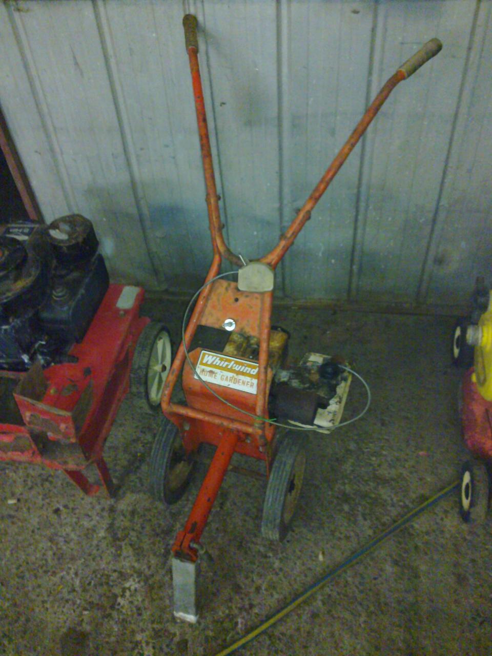

I have a whirlwind tiller here, 8ci briggs motor. Well 2 of them actually.
Its made by masport, sticker on it says so, i would assume that parts are available??? Same as an older 'home gardner'

Ummmm theres not much to take a picture of.

Nothing to see, its just a box of parts and a skeleton.

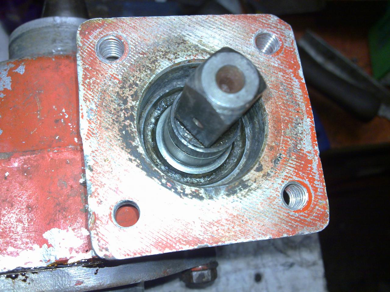

OK got it apart.
Bluffed my way through it.
Input shaft seal had let water in.
Was seized in the bushing.
Its got gunk in it.
Gears OK thank goodness.
I suppose the first thing i need to know, how critical is the clearance between the bush and shaft on the input??? Will I have to rebush it?
Bearing is still OK.
I will get 3 new seals for it. Probably spedi sleeve to go on the nose of the input.
Can i buy the correct thickness gasket for the side housing??? Or will i have to find some paper and cut my own. The gasket paper i have her is way thicker.
What oil is it meant to be filled with???
Cheers, Bob.
Bob, the shafts need to have good bushes/bearings because that is what holds them central, which is essential if you hope to make the oil seals work. There is a good chance the water entry happened because the input shaft oil seal couldn't cope with the loose (worn) bush. The bushes/bearings also control the proper center distance, and therefore meshing, of the worm and worm-wheel. So, you need to replace what is worn out.
I have no idea whether you can buy a gasket, but if you go to Repco or somewhere similar you should be able to choose a suitable gasket material, and cut your own.
The type of lubricant you use in gearboxes depends somewhat on the operating speed of the input shaft. If it runs at engine speed (3,000 rpm) that is out of the ideal speed range for grease, and requires oil. In general, thin (low viscosity) oils are only used when there are hydraulics involved, or an inherently weak mechanism. Many car gearboxes use SAE30 oil just because the synchronisers cannot handle the drag torque caused by heavier (SAE90 usually) oil. Other, better gearboxes use straight SAE90 oil. In this case, for a simple worm gear running at 3,000 rpm, SAE90 sounds about right. If it was only 1,000 rpm, you'd probably use SAE140.
The next issue is to inspect carefully for any copper/brass/bronze parts in the gearbox, or any sealed bearings. These items cannot stand hypoid gear oil (commonly called Extreme Pressure, or EP). EP oils have substantial amounts of sulphur added to them, to act as an anti-seize compound between sliding metal parts. You can recognise the sharp, unpleasant smell of oils containing sulphur. If you have no copper-based alloys or rubber parts, you might as well use ordinary EP90 automotive rear axle oil: it won't do any measurable harm, it's much easier to get, and it helps keep the worm from seizing onto the wormwheel (there are high sliding velocities involved, and sometimes extreme conditions when something digs into a water pipe and tries to lock up the tiller).
Having said all that, why not ask the manufacturer what lubricant to use? That is the safest, and usually the easiest, way.

Theres 3 bushes, either brass or bronze. So i will have to use different oil.
I got seals.
2x 460481N
1x 460467N
And the spedi sleeve kit CR99076 This was nearly $35.
Im going to put it together without seals and see what sort of slop that input shaft has.
If need be i will get it machined down and collared or get a bush made up.
Cheers, bob.

Theres measurements in the instructions. I will linish the end of the shaft up a bit and put the speedi sleeve on it. Probably cut the front lip off the seal as the seal and sleeve are pretty much the same size. The front lip on the seal does not even touch the speedi sleeve anyway, its like its over size.
The two side seals i got are like old as the hills. Same sizes but different brands/styles. Imperial sized seals.
Ive got some Oil here. SAE 80-90W, says GL5 too. Would that do the tick??
Ive also got SAE 90-140. No mention of the EP/Sulphur.
Its old shell oil. I bought it up for $5 a 4L container from a servo years back. Got 4 of each. Still on the 1st container of each. lol.
After the speedi sleeve is on and before the seal goes in i was going to add some oil up in the gap between the two.
Same with the side seals.
Just want to be sure that they are not dry especially that input seal as i can not see much oil working up through the bushing to lubricate it.

David, it would be much better to clean out your fuel tank and carburetor to get it running properly again, rather than use starting fluid. The fluid is likely to harm your engine.
If you post the long string of numbers from the cooling air cowl on your engine, I can tell you some details about the engine and give you a link to the B&S overhaul page for your carburetor. We can help you with any questions you have along the way, too.
Joined: Dec 2009
Posts: 125
Thanks Grumpy - talk about stating the bleeding obvious ! I got the complete B&S manuals on CD I bought when I needed to overhaul the engine on the ride on - never thought of using for the digger blush Guess as I could get it started never considered a problem - better take some time out and 'sharpen the axe'
PS anyone know if you can still obtain the weight for the front - never had one but sure would help keeping it in the ground.
Short of finding a machine thats got one that comes with it, id say theres little hope.
Not sure what the new ones have, if they have it with minimal fuss you might be able to fit a new one. The machines are now Metric instead of imperial.
The weight just sits on there.
I would keep an eye out for an old Vice or something thats a big heavy lump of cast Iron or steel. Drill a hole and put a pin or bolt through so it will go down in the hole on the front.
Make up a saddle over the tube at the back.
Of course lead would work too. Some old flashing or similar. You would melt and cast it into whatever shape you like. Or just wrap strips of it round the main shaft but that might not get the weight forward enough.
Not sure what you mean about the double width??? Was only 2 rows of blades the standard thing???
The one this thread was about had 4 rows of tines. The other one that Dad has at his place (older going by the motor) only has 2 rows of tines.
