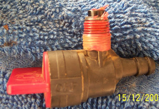

I'm not happy with the length of the fuel line, I want another 10mm so that it completely covers the barb fittings, there's a small leak at the fuel tap as the hose dose not go all the way on.

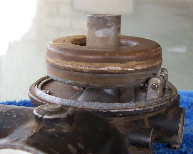

OK, I have finally got the fuel hose sorted out and left it to see if the fuel leaks out. and it does!
from around the bowl gasket and look like also from where the air filter "tie down" rod comes down through the air intake into the bottom of the carby body.
now when I look in to the air in take I can see fuel in there so I guess that means that the whole needle/float thing isn't doing it's thing.
So what's next? do I buy the carby kit and hope that replacing all that fixes the problem?
https://www.outdoorking-forum.com.au/index.p...mp;cPath=193_195_203&products_id=334
Nathan
With your flo-jet carburetor, if the mower is on level ground fuel can't come out from the float bowl gasket (i.e. the gasket at the top of the float bowl, not the one at the bottom of the float bowl) unless the carburetor is flooding. That can only happen if the needle-and-seat are leaking. If fuel is entering the carburetor body, the fuel level has to be up above where the main jet passage enters the body - which is way too high. So, you have to attend to the needle and seat.
Remove the carburetor, dismantle the float bowl, and look at the needle and seat again. If the sealing surface at the end of the needle is perfect you probably have one of two things: misalignment of needle with seat; or a damaged seat. Check that the spring-clip attaching the needle to the float arm will slide along the arm to allow the needle to align itself properly. Assemble the float without the needle and make sure the float will lift up freely past the needle-closed position. If those points are OK, try to get a magnified view of the seat. It may be a bit rough, which would make it leak. If so, there are two possible cures: replacing the seat, and trying to lap the old one in-situ. Quote from manual:

If you look at the illustration above, you will see that the seat is a hollow cylinder: the seating takes place on the inner corner of its end-surface, so it should be a perfectly square corner (see just below the note 'press flush'). With normal wear a small conical surface would develop on that inner corner due to contact with the needle's conical sealing surface. The worn, conical part of the seat should be even all the way around. The simplest way to fix the leak would be to lap a clean conical surface, but if it were the least bit out of square, it wouldn't work. Similarly it must be quite narrow: the force applied to the needle by the float may not be enough to seal over a large area. I guess that is why B&S just say replace the seat. However if you damage that square inner corner of the seat the slightest bit while installing it, you've wrecked it. Hence the screw that goes through the inside of the old seat must be retracted so it does not protrude at all before you start pressing in the new one. It is the kind of job that is pretty easy for someone experienced, and pretty difficult for anyone else.
You said you've examined the conical sealing surface of the needle, and it is good. The slightest wear on that conical part of the needle has the same effect as wear on the seat. Unless it is pristine, replace both needle and seat at the same time.

pulled it out and to my untrained eye I can't see any problem so needless to say it is probably buggered :-)
There is an old-guy's trick that you could try. Once upon a time I bought an old 850 Mini in lousy condition. It very slowly flooded its SU carburetor at idle, but was fine (for a tired old Mini) when in motion. I fitted a new needle and seat, with no effect on the problem. I therefore swallowed my pride and went to see an old guy who ran a carburetor repair shop. He took the carburetor top, turned it upside down, slurped on the fuel-line connection, then blocked it with his tongue, waiting to see how long it took to lose the vacuum by leakage. It lost the vacuum fairly quickly, and seeing that it was a new needle and seat, he unscrewed the seat from the body and reinstalled it with liquid sealant on the thread. After that it would hold vacuum properly. Didn't flood either.
My point in this long story is that you could make the same test, and find out whether your needle and seat will hold vacuum. If it doesn't you can probably find out why by doing other tricks, such as sealing each possible leakage path in turn with a drop of oil.
