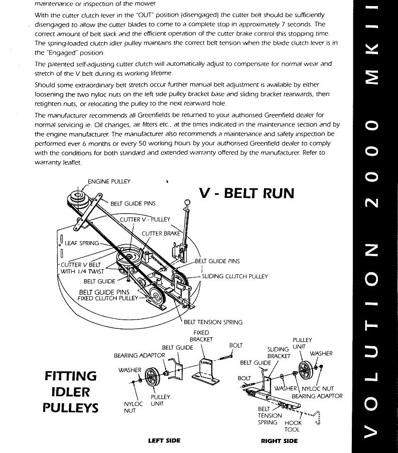

Does anyone have a diagram to make sure we have the belt running the right way through the pulleys? We can only find diagrams for the engine belts not the cutting deck belts. Just want to make sure that's all.

Hi Highlands Piper,
This diagram is from my evo 2000 mk11A 34" manual, I'm not sure if it is the same as yours or not.

Thanks very much for that! Will see if that helps!

One step at a time, firstly lets see if that diagram is the same setup as yours, so we know we are on the same page.
Try and take some photos of the machine and the cutting deck and post them, so that we can see if we can spot a problem and offer suggestions, because at the moment we are shooting in the dark without them.
