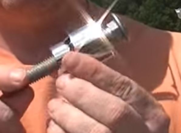

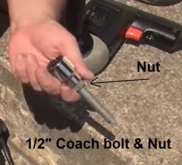

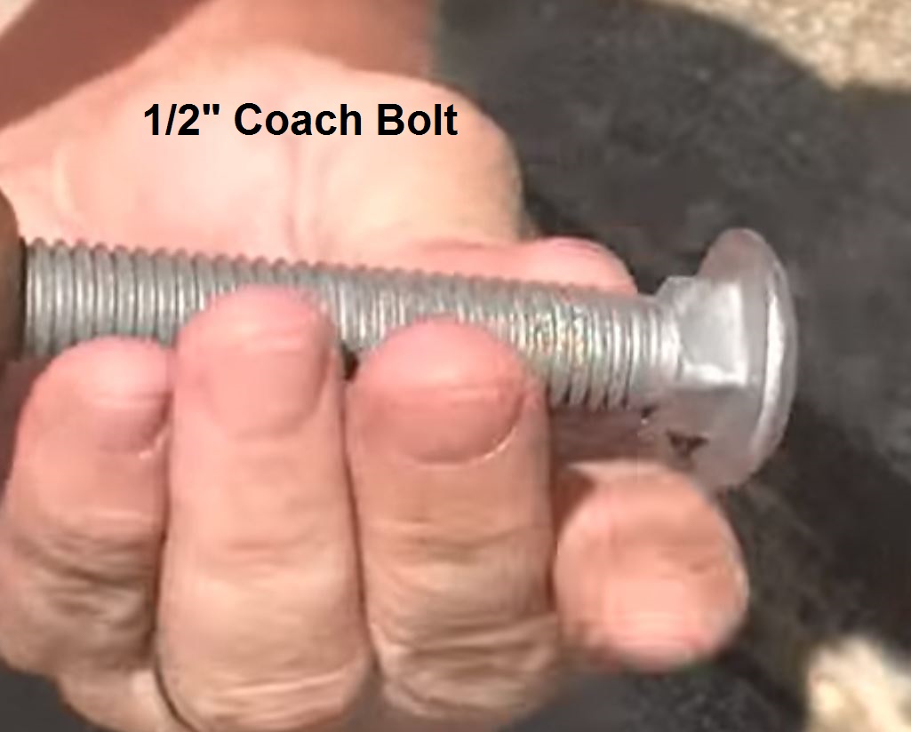

Hi all,
Also found this on the net (YouTube still images)
Don't know if i'm game to try this though, taking about OHS.....!!
Use a 1/2" Coach (Cup head) bolt & nut with a 1/2" drive socket the correct size, grind the round bolt head down so its fits inside the socket.
The square part of the bolt fit the square end of the socket.
cheers2John

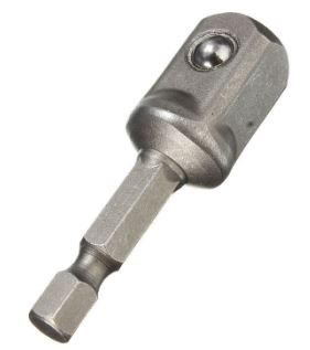

Use a 1/2" Drive Drill Adapter like this one.
