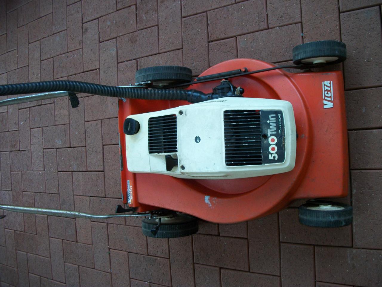

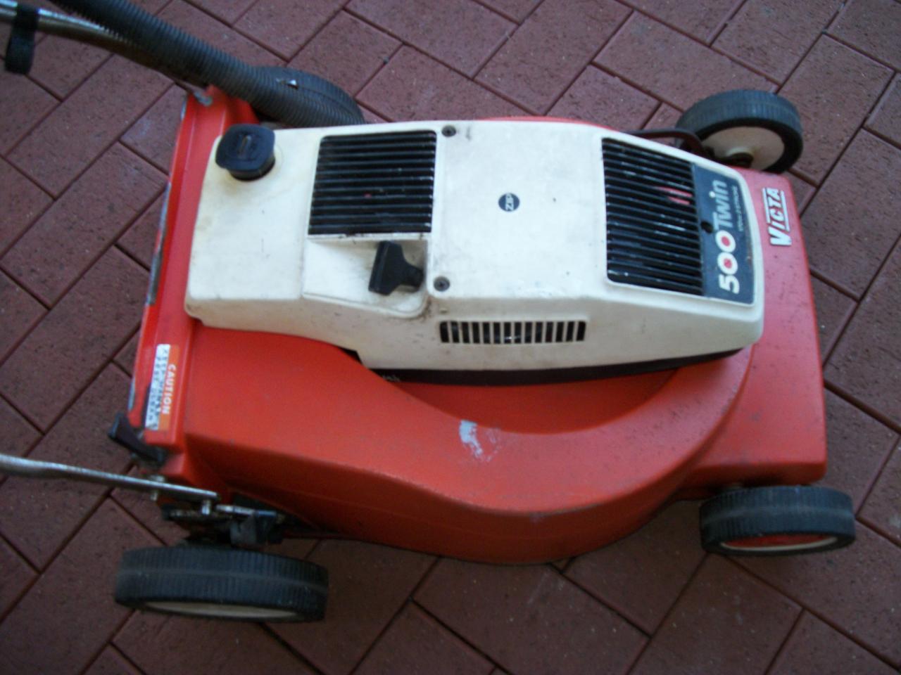

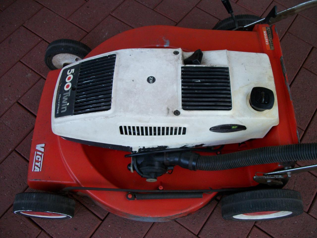

Bought this mower for $30 off gumtree. Bloke said it didn't run but I just thought it would be carby problems as has the dodgy plastic carby. Would like to get it running and restore it as such an unusual mower. Seems to have a good spark. Rebuilt the carby (though not an expert on this - got the info off youtube). Fuel is definitely getting into the engine as fuel was dripping out of the muffler after about 15 minutes trying to start it (thought it would have at least fired) and spark plug was wet with fuel. Tried aerostart in both cylinders but still not even firing. Hasn't fired once! Any help/suggestions please???
Awesome find for $30 I'm impressed.You seem to have found the first version of the twin and from what I can see hasn't been updated at all.So it most likely has never been serviced.So your got nearly 40 years of running to deal with.So you need to check everything to make sure it is working.However due to it's age and the fact it hasn't seen any service (me personally)straight for the jugular.I'd crack the crankcase and have a look inside first.You won't hear me say that very often but considering what it is and the lack of servicing that's what I'd do first.There were many problems with the first version it could well have cracked rings.See how you go but that's what I'd do on this occasion.

Mowermechanic; What Blumbly is referring to is that Victa found lots of faults with the twins when they first came out - one of which is the easiest NON update to see - they fitted a heat shield infront of the carby as they found fuel was evaporating in the lines. Machines without these updates are very rare but usually in good condition I have found as they really weren't used for long before the owners gave up on them (I know - My uncle rushed out to buy one in '74, threw it in the bin in '74 and bought a new machine). There were lots of horror stories.

Not the best photo but if you look infront of the carby you'll see the heat shield (A smalll piece of steel riveted onto the base) I referred to in the above post.
Also don't judge the amazingly dirty mower - that's how I bought it.

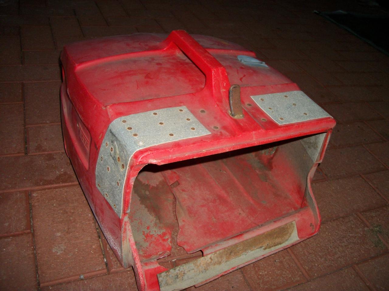

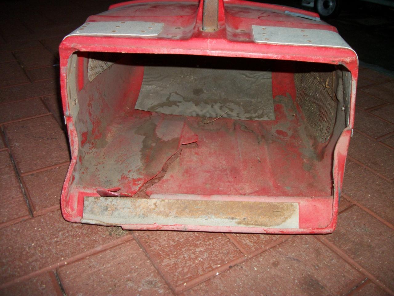

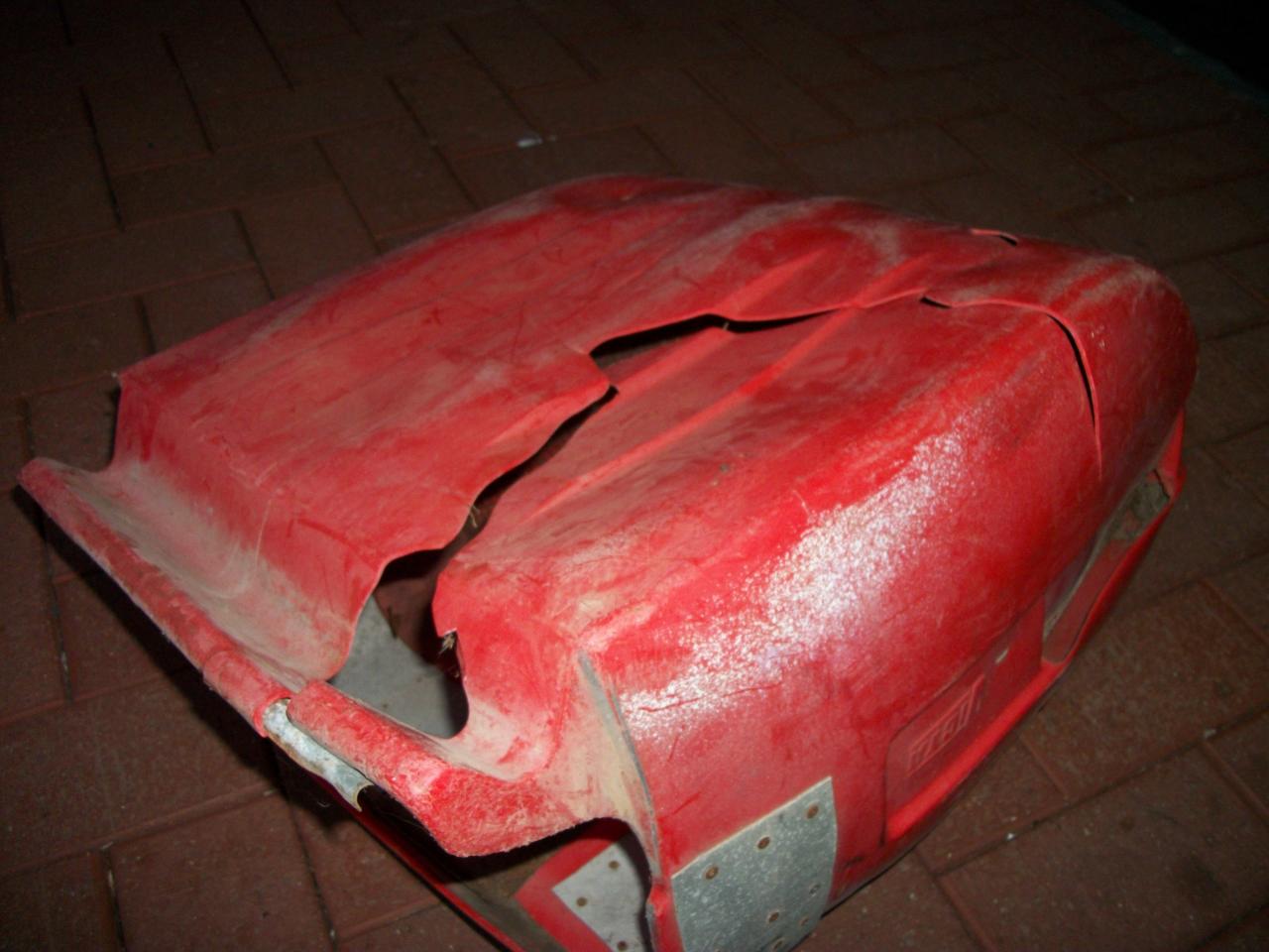

Any way on a different subject I have uploaded some photos of the catcher for this mower which is in need of some repair. Obviously already has had some repairs done before. Any suggestions as to weather this catcher is repairable or if new ones are still available?

WOW. Your mower certainly has not seen much work if it still has the plug cover ...
If your looking for a catcher I am selling one on eBay now (New old stock).

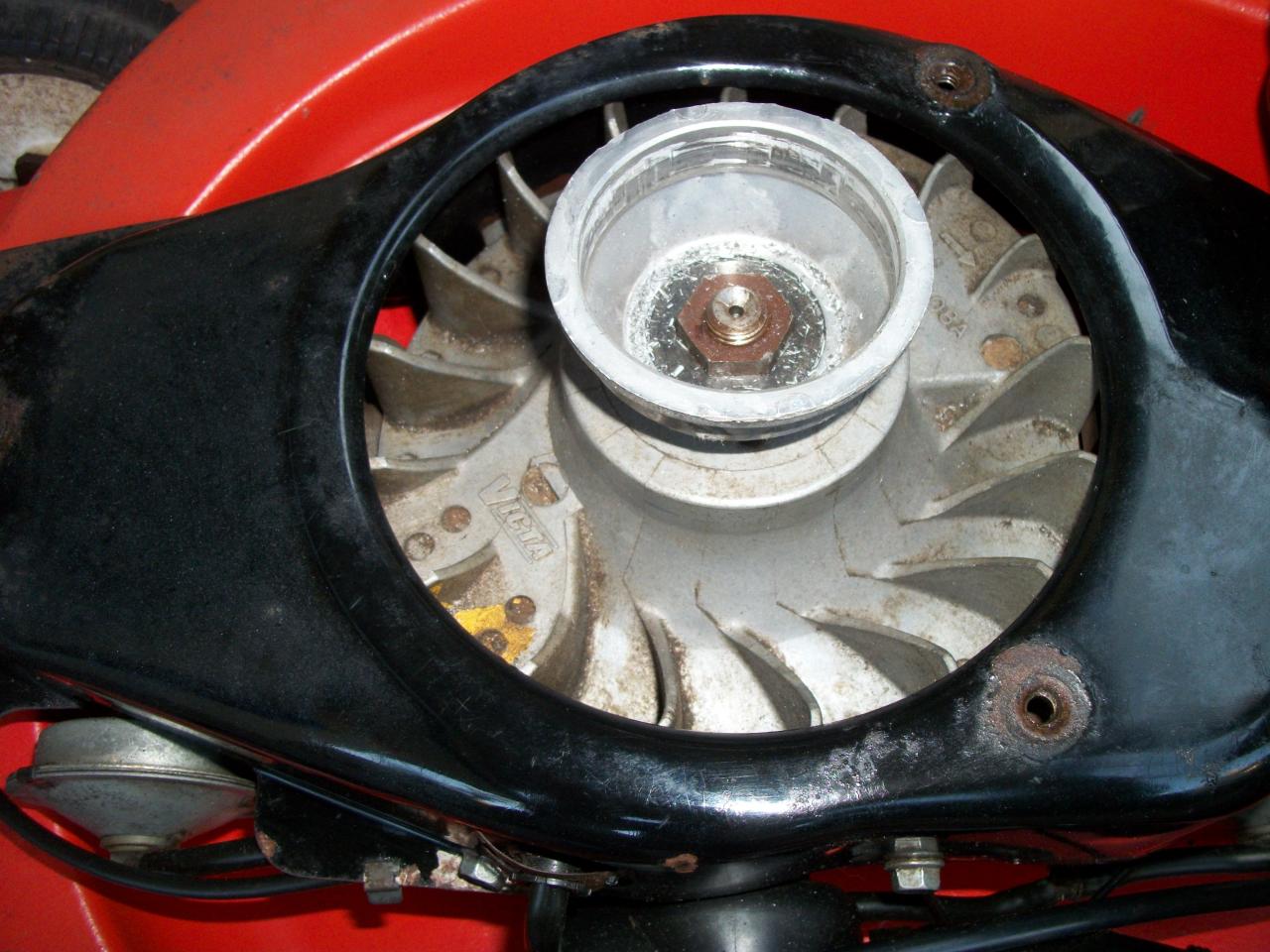

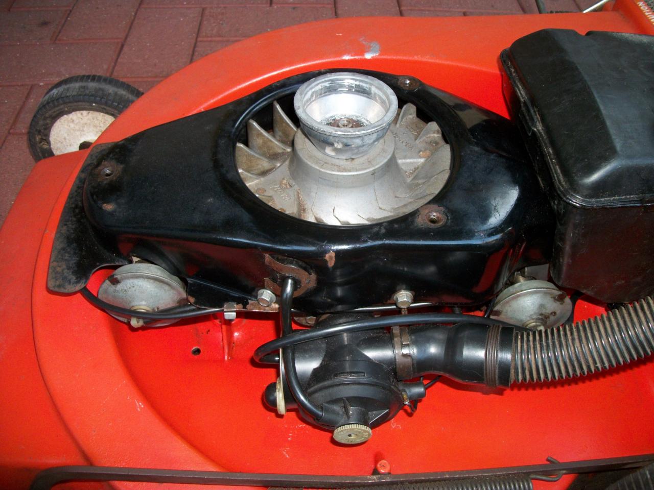

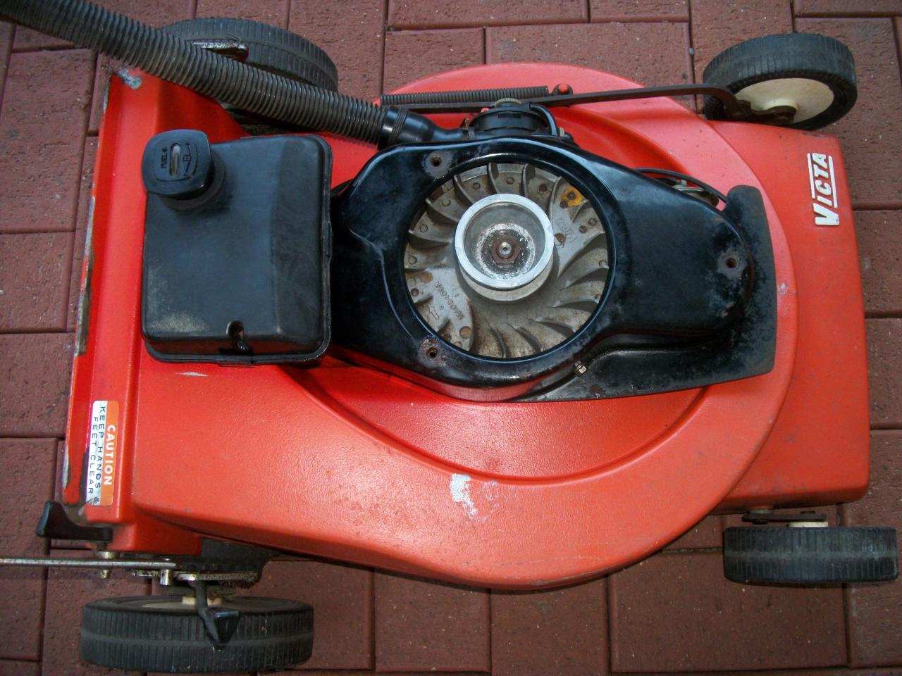

Have uploaded a few photos. Flywheel came off real easy. Points look good. Gave them a clean up. Would anyone have any suggestions on what else I should do before I start putting it back together?
Thanks for any help.
Posts: 715
seanw
mate i usually fix things with a hammer but do you see the rusty parts on your coil pack and the flywheel in your last two pics, give em a bit of clean with some sandpaper or something abrasive. you have to get the twin going. make them shiny. good luck mate

What Sean said. Clean up the coil and magnets with fine sandpaper.
The kill wires in the back of the carby aren't installed correctly (First photo). That could easily be killing your spark. Make sure the first wire (Fits straight into the carby and is moved by the cam inside) has a new rubber boot on it and the kill wire that slides in the side (The one you can see in the photo) fits nicely in one hole and out the other. If you have never dismantled and reassembled a G4 carb get on youtube and search victa g4 carby. There are a few good videos that will show you how to do it.
Short of that I cannot see anything you need to fix. Have you checked the points gap? You will need a feeler gauge (Again if you have never checked a points gap search youtube).
Let us know how you get on.
Pete
and to be sure , clean under the coil and all other bits , goood clean contackts are always a good thing
