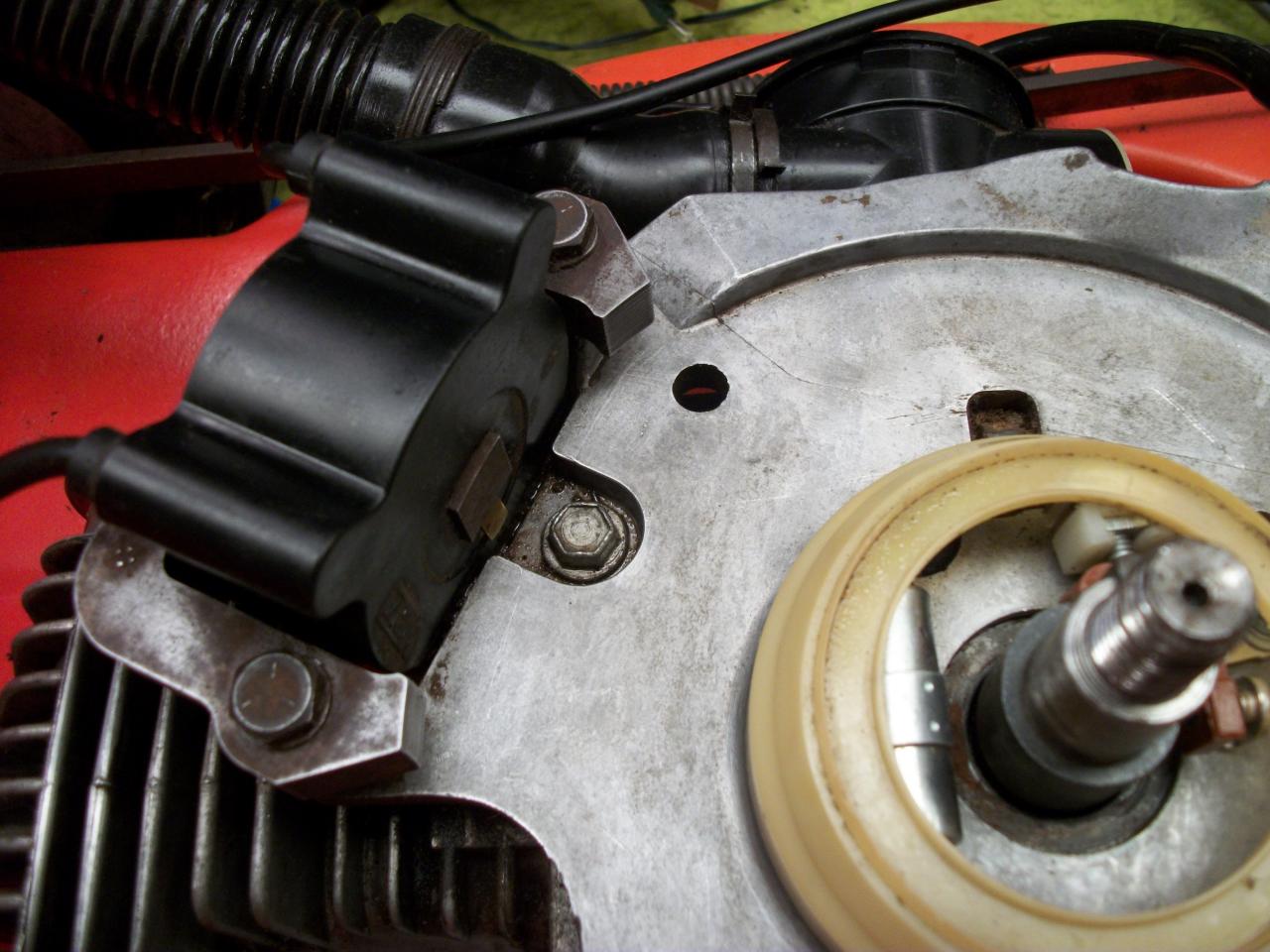

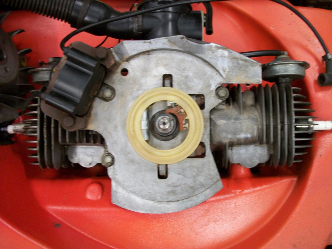

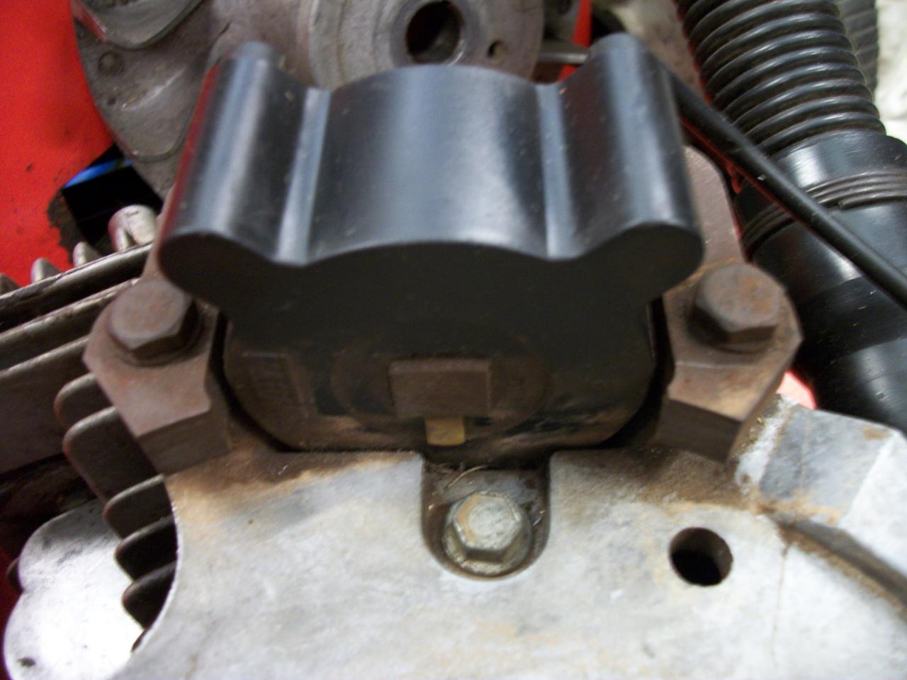

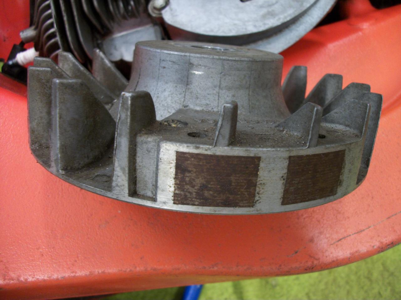

Joined: May 2015
Posts: 26

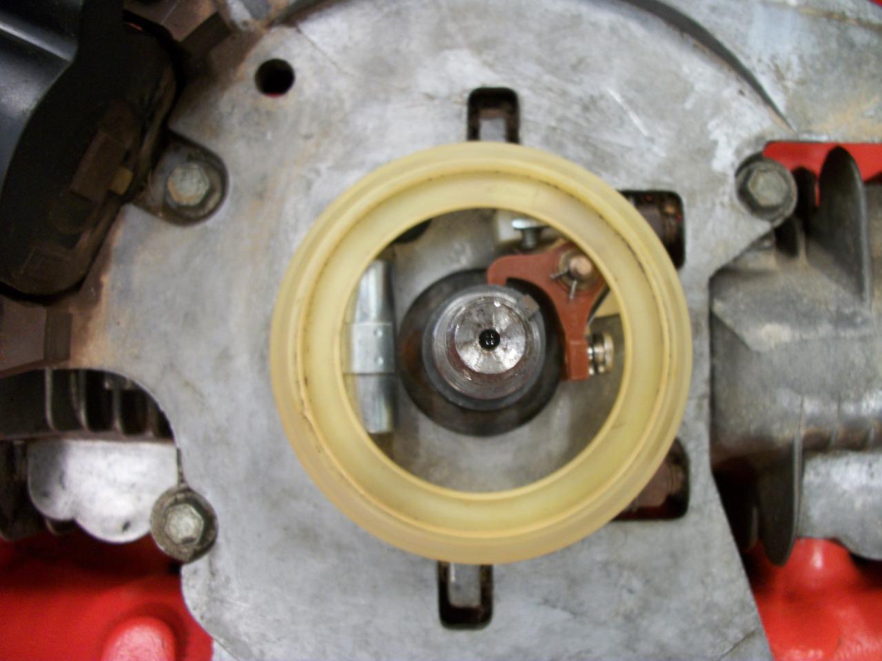

Have uploaded a few photos. Flywheel came off real easy. Points look good. Gave them a clean up. Would anyone have any suggestions on what else I should do before I start putting it back together?
Thanks for any help.
Posts: 715
seanw
mate i usually fix things with a hammer but do you see the rusty parts on your coil pack and the flywheel in your last two pics, give em a bit of clean with some sandpaper or something abrasive. you have to get the twin going. make them shiny. good luck mate
motorwannabe
Posts: 325
What Sean said. Clean up the coil and magnets with fine sandpaper.
The kill wires in the back of the carby aren't installed correctly (First photo). That could easily be killing your spark. Make sure the first wire (Fits straight into the carby and is moved by the cam inside) has a new rubber boot on it and the kill wire that slides in the side (The one you can see in the photo) fits nicely in one hole and out the other. If you have never dismantled and reassembled a G4 carb get on youtube and search victa g4 carby. There are a few good videos that will show you how to do it.
Short of that I cannot see anything you need to fix. Have you checked the points gap? You will need a feeler gauge (Again if you have never checked a points gap search youtube).
Let us know how you get on.
Pete
and to be sure , clean under the coil and all other bits , goood clean contackts are always a good thing

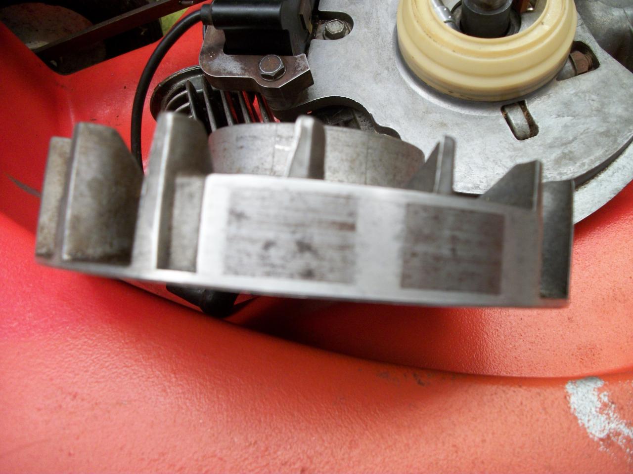

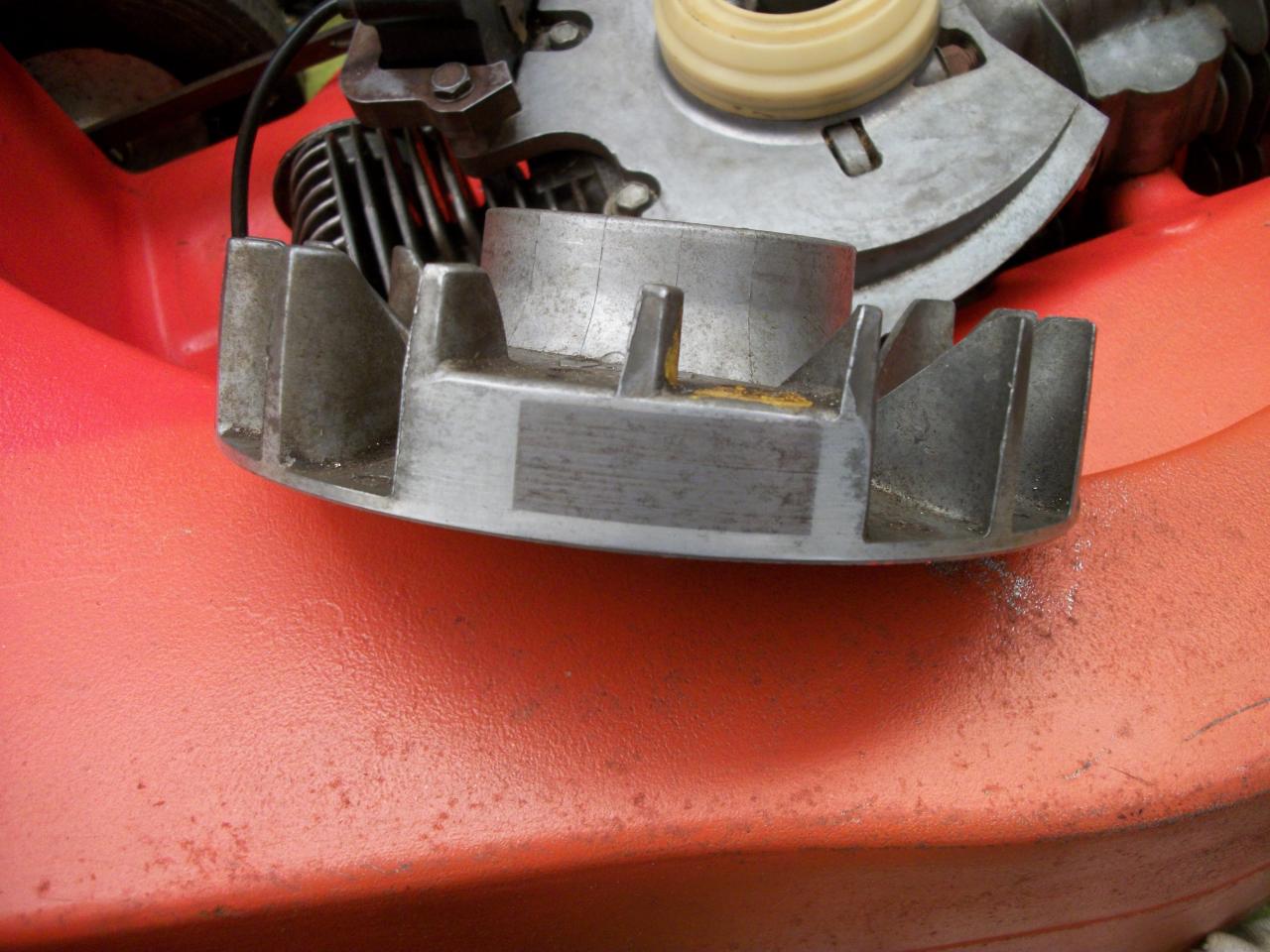

Joined: May 2015
Posts: 26
Cleaned everything up as can be seen on attached photos. Cleaned and checked points. Brand new plugs. Put back together. Tried it but spark seems to be worse than it was before. Very weak and intermittent. Tried to start it but as suspected a waste of time. Absolutely nothing despite a liberal dose of Aerostart. I'm at my wits end with this mower! Very disappointed with this weekends results. Wheeled it out of sight for now! Maybe magies toast? Any suggestions on where I should go from here?
Cheers and thanks in advance.
Posts: 715
seanw
sounds like you flooded it mate. are you still pull starting it? if so pull the front plug out and get someone to put there hand over the spark plug hole and see what comes out when you pull a few times. use a drill. dont over prime twins as need less priming the cylinders fire at the same time. good luck
