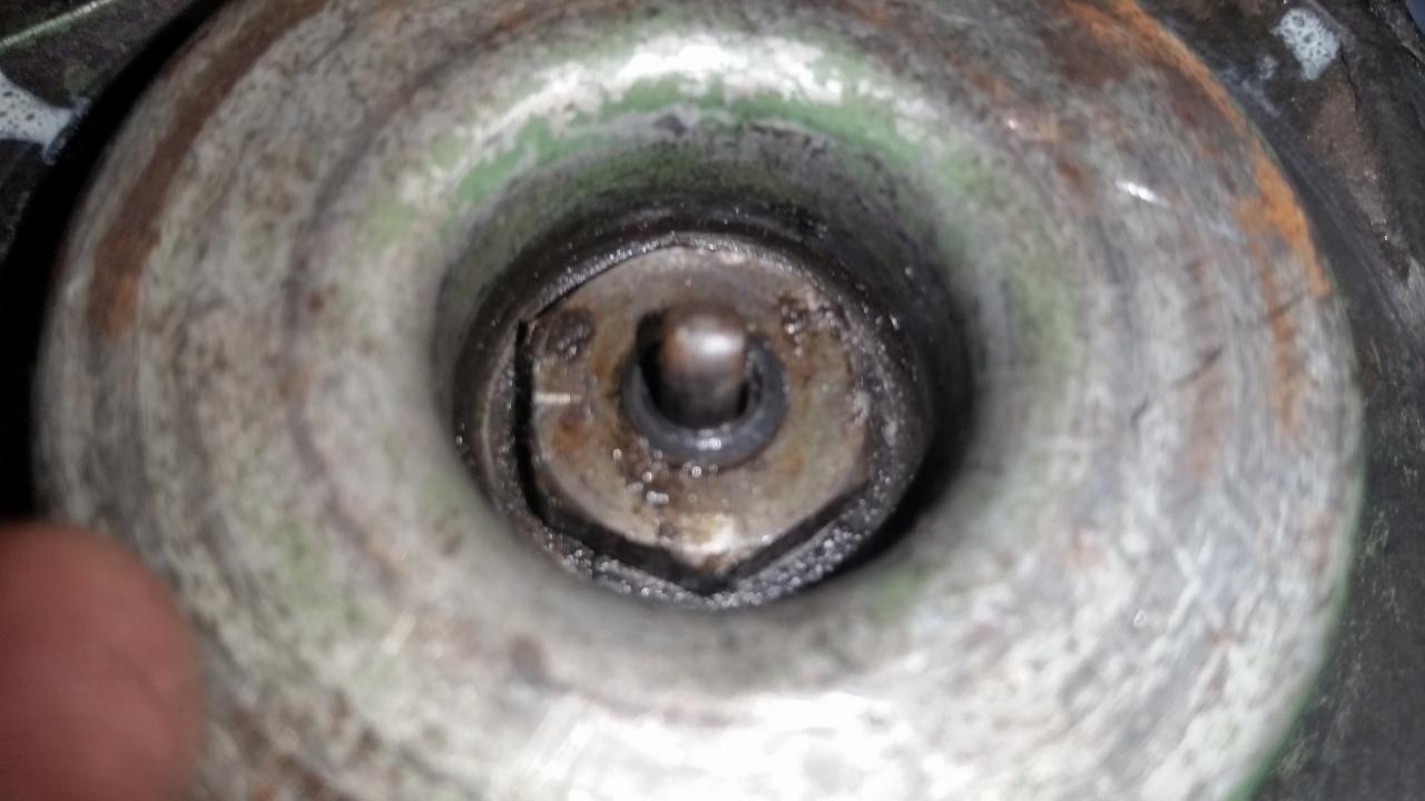

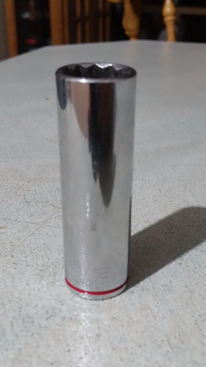

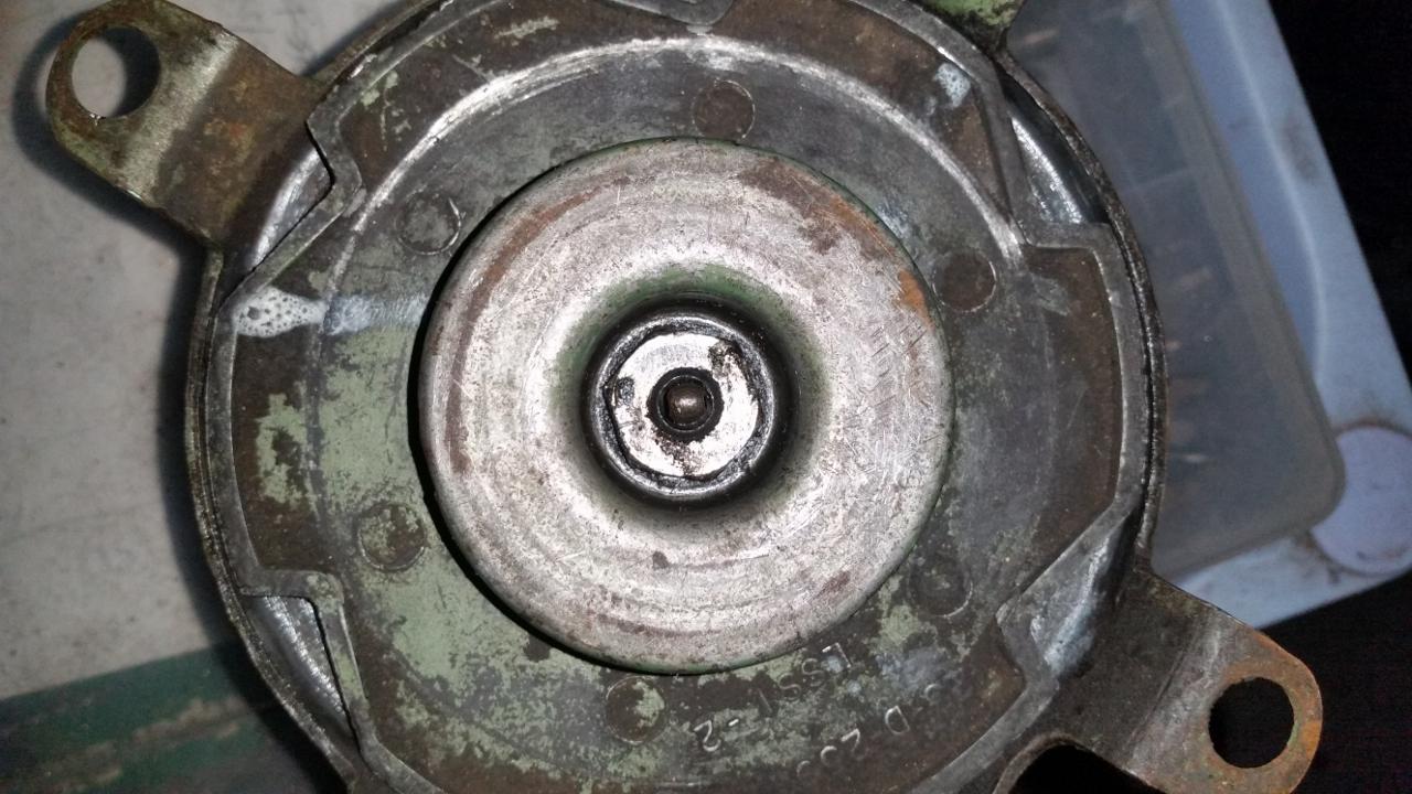

They can be pulled apart..
There's a nut on the bottom, you will need a certain type & size socket to get it off. I'll post a pick of the socket tonight.
I had to replace the spring in mine.
Paul
Such is life.......
Hi all Contributors
There is a Victa service guide (No.34) on this starter. Click:-
https://www.outdoorking-forum.com.au/forum/ubbthreads.php?ubb=showflat&Number=67519
Posts: 310

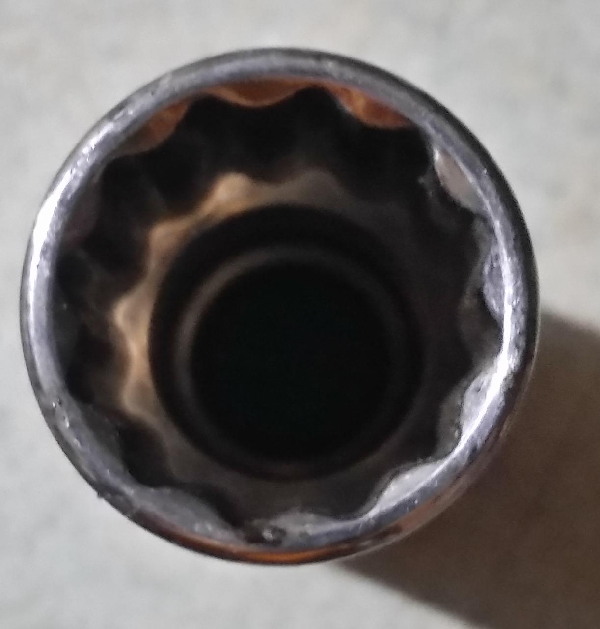

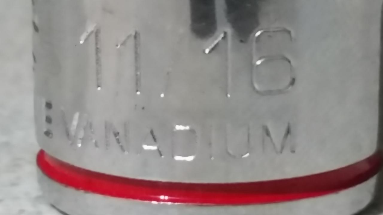

here's some pix.. because the space where the nut is very tight, the socket wall needs to be thinner than a normal sockets.... size 11/16
Paul
Such is life.......
An 11/16" tube spanner will do the job, too.
