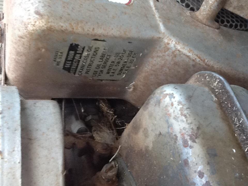

Yes, the part you've removed is the cooling air cowl. If you look closely at the cowl you'll find a very long string of numbers, broken into three groups, called the Model, Type and Code. If you post the numbers, we can tell you quite a lot about the engine.
Now you need to brush out all the leaves and dry dirt from around the fins and the ignition unit, before cleaning the outside of the engine in detail with solvent. Once the engine is clean, the next step will be a compression test, but we can talk about that when you've done the cleaning.

Is this what you wanted Grumpy?
I have cleared all the dry dirt, grass clippings and leaves from the outside of the engine, would I now need to head into a hardware store and pick up some spray degreaser? If so what brand would you recommend? Once I have got that would I then have to spray it all over and wipe off with a rag?

Yes I did here they are. Sorry it took a while.[Linked Image] The numbers from top to bottom are: 61202 0144 01 6806211.
I see that Rolla16V interpreted those numbers for you already, so you have the information. Spray degreaser can be used for cleaning your engine, but you will still need to use a paintbrush to shift the dried out oily sludge. You can use kerosene instead of degreaser - it is nearly as effective, and a lot cheaper. Once all the dirt is loosened up most people use something like a hose or a pressure washer to blast the oily residue off. Be careful not to spray the air cleaner though, or water might get into the engine.
