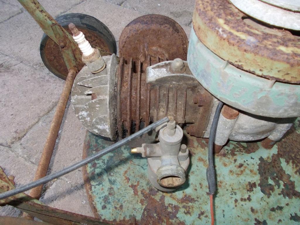

I purchased this today.

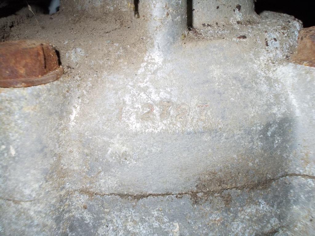

I think its a model 1 Rotomo, would anyone be able to tell me the year it was made and what parts are correct/incorrect?
The numbers are 1 2727
It is seized.
What would be the best way to get it free
Thanks
Scott
Well by the engine number it is a Model 2 not a 1.Although it does look to have a model 1 throttle control on it.Also I think I see a cigar fuel tap on there as well.Year would be 1956-57.As far as an easy way to un-seize an engine....sorry you'll just have to pull it apart to see what has seized up.No easy way to free it up.really best just to find out why.

Is 12727 the build number? As in the 12727th Victa produced?
Scott
What a little beauty Scott! Early To Mid 1956...Shes A very early Model 2 running the model 1 chassis. Every thing I can see appears accurate. You will need smily face choke (red Victa print) Model 2 Badge with 18" (both digits exact height),metal cap and fuel tap(this one is accurate Rotomo,but is for a later version). Thats it!
I Would need to see the engine parts stripped in order to determine accurately the barrel and head style,to see if these parts also carried over from the model 1 as well as the chassis.
Its my opinoin this is factory correct,as alot of the early models around the transition between model 1 and 2 often got leftover parts from the Model 1. This is especially common of the brass nut carby,barrel,head assy and chassis.
Chassis model 1
Throttle model 1
Barrel and head (unsure at this stage)
Carby Model 2
Engine model 2
Muffler model 2
Fuel Tap Model 2(late) Model 2a,Model 4 Automatic.
Top hat (unsure as I cant see the Images,if the chamfer on the top edge is barely visible its a model 1,if its prominent,then model 2.
Can clarify the unsures with better images smile
An Awesome little Rotomo Scott,Id dearly love this one...Well scored.
No its the 12,000TH "Rotomo" Produced smile Not the 12,000 victa..But a very early example none the less.
*Additional*
Because of its very early number,there is also the possibilty of it having the model 1 badge. Your choice As it could never be proved since its missing. smile

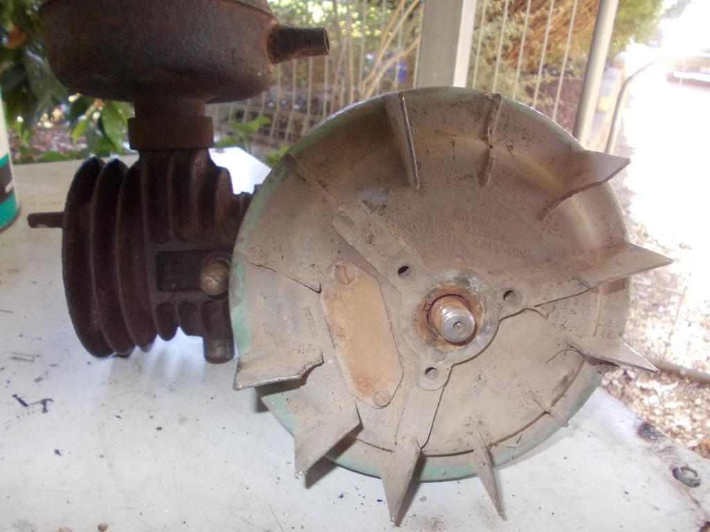

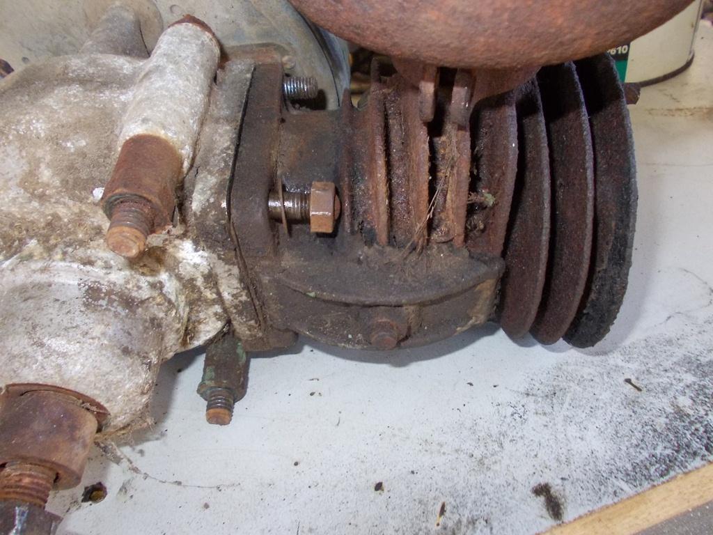

This is where im at with the engine.
Engine is off the frame.
Got the head off, broke a few bolts.
Got the cylinder free.
The pistion is seized. Looks like water has been sitting in the cylinder.
Iv tried tapping it with a lump of wood, and am now soaking the piston in engine oil.
Anyone have any advice?
Scott
Two Choices...Scrap it! OR Cut the piston out and see if the barrel is salvagable. I highly doubt youll get this one free,as the Piston will be as good as welded to the barrel. If its a Model 2 barrel you shouldnt have any trouble getting another. If its a Model 1,then you will need to try and save the barrel,as they are harder to get.
Get the barrel loose and see how much damage is done to the internals of the crank case from the water,they may be corroded as well. If they are good id get another barrel,rebore and piston kit and start fresh. Spilt the crankcase and take remove the halves from the crank and put them aside so you can work on removing the piston without damage to the "Important" Casing.

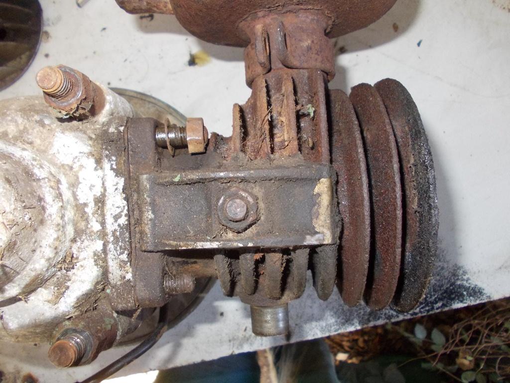

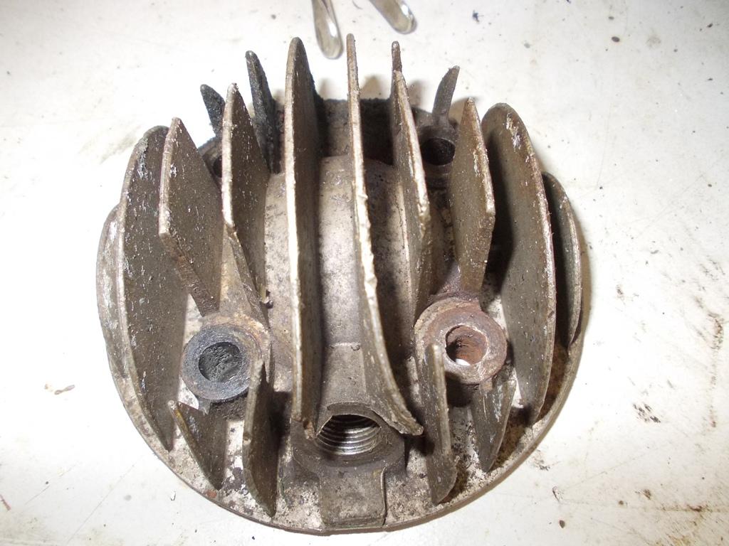

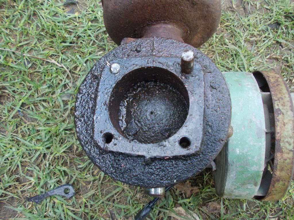

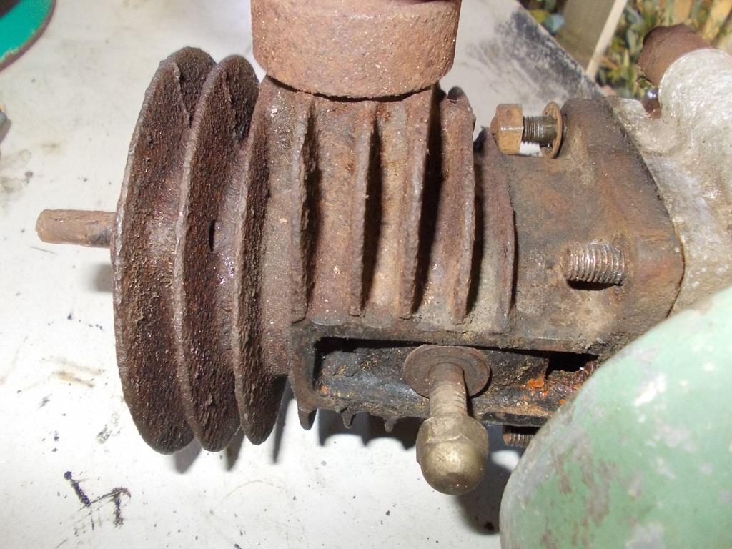

Hi All,
Here is the head and cylinder.
No luck trying to twist the the cylinder and hope the cylinder will come free, just started to twist the conrod mad
Can you buy new conrods for this engine.
Iv seen new victa 18 pistons on ebay and all around the place, will these fit this engine?
Tryed to seperate the 2 halves of the crank case, it is loose but will not serpeate.
Whats the go?
Here are the pictures.
Scott
you took out the barrel studs ? or tried with the still in , double nuts if there is room or studs will hold the cases together . remove the studs and it should come apart the bolts that hold cases together i think are only studs too , if same as later 18s ? maybe corroded around them so be really carefull not to break the case with numbers ! bigshock
Im confused...Ok,So the crankshaft is turning? You pulled the barrel up over the studs yes? Your not trying to turn the piston in the barrel,you will damage the conrod,your just trying to get the barrel free from the crankcase smile Just relift the barrel over the studs. Remove the 4 crank case bolts completely. Remove the blade boss and seperate the 2 halves. BUT. You need to take the flywheel off,coil plate cam and blade boss or your wasting your time,and risking damage to other parts. Clear everything away.
The images show me that the barrel is definately a model 1 as is the head(full model 1 engine) You now need to be very careful as parts dont come easy.. Your main aim is to get it apart without damaging anything but the piston. Just do it step by step and ask questions whenever you like:) read the process in the victa book,should be pretty much the same as the steps for the later 125. And NO the conrod isnt readily available,and rarely sold seperatley from a complete engine.
