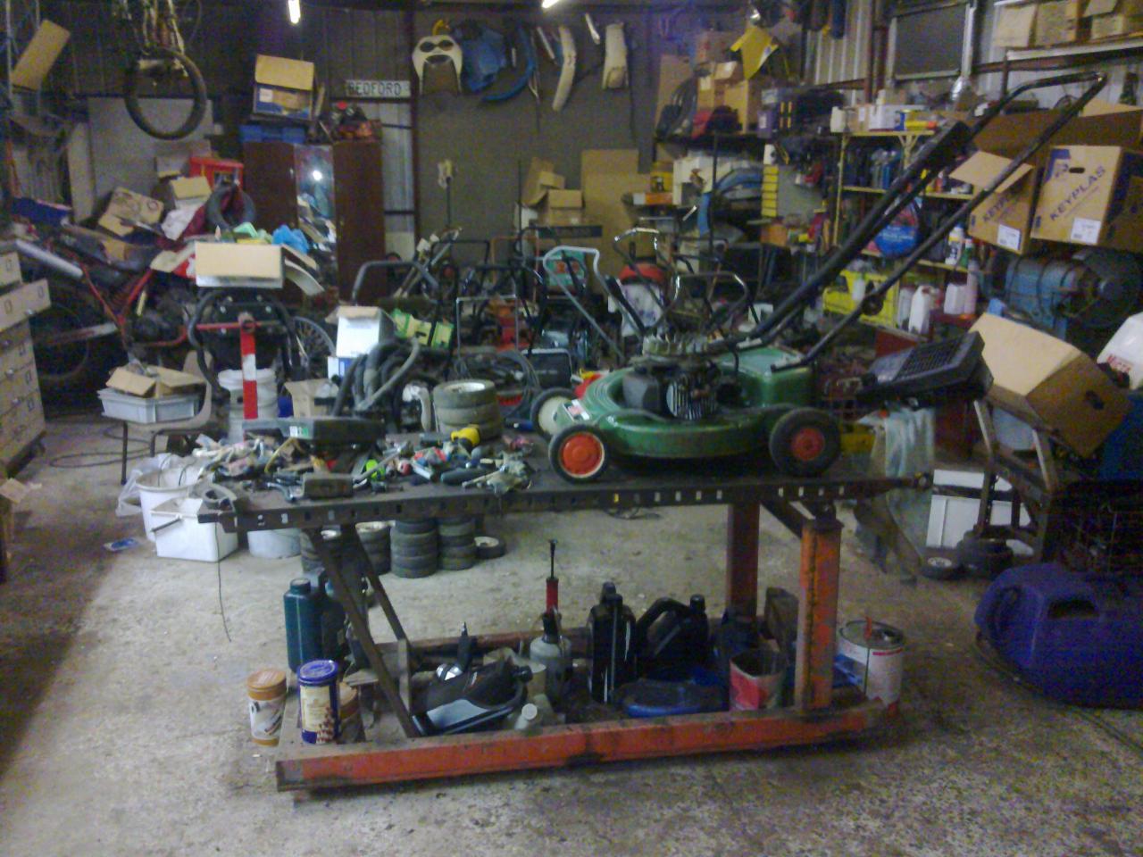

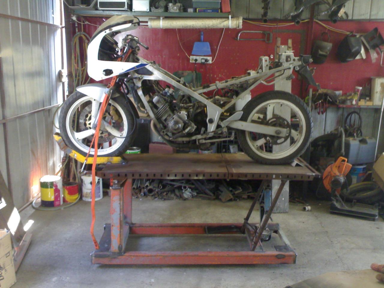

Mr Davis #24317 15/06/11 07:49 PM
It looks like this without all the stuff on it.
Wow wish my shed was still that tidy.
Over kill for fixing mowers but thats not what i made if for.
I cant squat down for very long, so working on the ground is a pain.
Table is probably a touch low, well it is with my back the way it is at the moment.
Theres a 4" square bit of redgum under the front of the table, i just put that beside the mower and tip it on its side to get underneath. Only had one kiss the concrete so far. Some are a pain to get sitting up on thier side.
Can hang bits on the wheel thing at the front. And also sit the front of mower up on there to tip the motor back to suck the oil out. Or clean the deck and push the mower forward and hook the handle under the wheel track to get at the underside for mowers that cant be tipped because of oil or fuel spills.
Mr Davis #24325 16/06/11 01:47 AM
Bob, for me it would need a way to keep the mower wheels from moving (either fore and aft or sideways) while working on it. Same with the back wheel of the bike. I would also want a way to secure either bike or mower while leaning either way at a fairly extreme angle. Will it take a 4-wheel bike?

Yeah you guys are right, the mowers do tend to roll a bit. But theres ways around it.
Height up, roll it right back till the wheels drop off and the back of the mower sits up on the yellow channel.
If you want it on the deck of the table just drop it to eat dirt and it wont roll back.
Its not wide enough for a 4 wheeler Grumpy. Its made from 1 and 2/3rds of what i think were inserts for what would be a stormwater/curb pit lids.
Just wide enough for a wide cut push mower. 20" rover, 505 Victa, super 24, MTD bigwheel 23".
