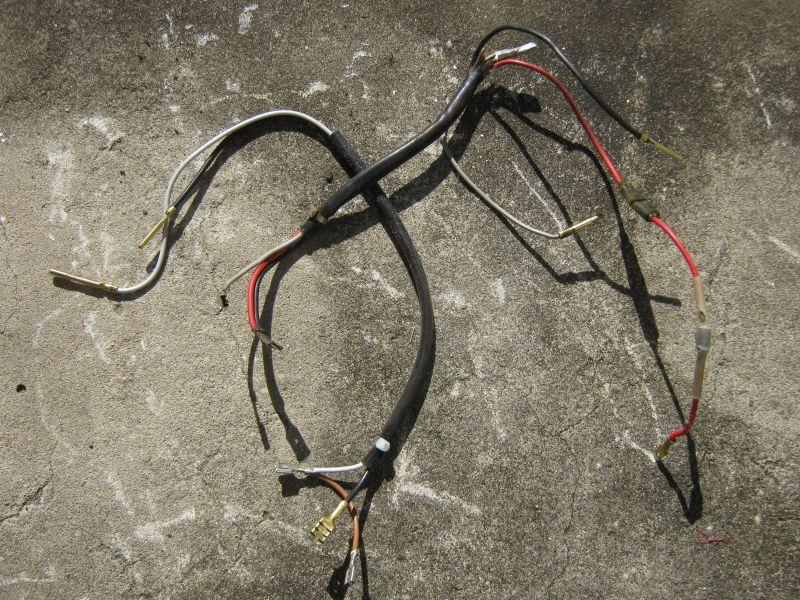

Anyway, the old lead assembly with 2 cut-off (kill) needles needed replacing as the wires were worn-out. Whilst trying to fit them back, I snapped off the top of the longer pin.
A quick search on this forum gave me: https://www.outdoorking-forum.com.au/forum/ubbthreads.php?ubb=showflat&Number=23596 (great! thanks Mr Davis), however I didn't want to hijack that thread by adding my queries & 2 images there....
Looking up p23 of Victa spare parts manual at the local mower shop, I found that I needed part MA05670A, standard lead assembly, not the keystart version (MA05683A). Ordered it only to find the brown cord much shorter than the old one.
First photo = new MA05670A lead assembly on the left; with old one on right. The old lead assembly's third cable is red-covered and has a set of connector & something (diode?) outside the zone of piston head top. The new lead's brown cord (bottom of the first photo) ends within the underside zone of "ignition coil assembly".

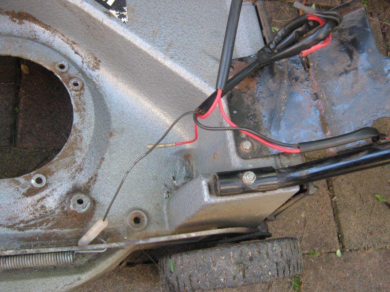

My other photo shows the other cables attached to the Victa mower frame. There's a keystart at top of the handles but we've never used it. No battery at all. Just manual yanking.

a) Can I still use MA05670A lead assembly and cover up the short (brown) cable's connector? With two cut-off needles inserted at rear of the carby, and leave the lower red cable (2nd photo) from the unused keystart unit unattached (not to the covered up brown short cable?
b) If no, then what is the part number of the correct lead assembly I need?

Depending on what ignition coil you have the new loom will work fine, If you have one with the ignition module mounted under the carburettor you will need an older ignition loom, otherwise if you have the ignition coil with the module built in this new loom will work for you.

thanks for replying to my first post here. I think my coil is the older version, however I'll just put up a new photo here. Can I confirm that if my coil's the older one - the short brown cord needn't be hooked up at all, just the 2 cut-off leads off the new lead assembly / loom? If so, I'll just snip the brown cable off.
ta, A
that appears to be the newer powertorque engine with the ignition coil that uses the internal ignition module, you are right to cut off the short born wire from your new loom and pt the new wires into the carb.
Make sure you use new rubbers on the carby end as it makes putting them in a lot easier.
I think the short brown wire on that loom is meant to go to an earth. Not sure only ones ive seen have just been the two straight leads.
If it were the loom for the old type extrenal module the loop would be at the other end.

In this photo, the black wire is the earth. It goes up to the unused Keystart unit next to the throttle. The red wire (at the right of the photo) is the one that used to be connected to the 3rd wire of the loom. My old lead assembly had 3 long wires, the new one has 2 long & 1 short, which ought to be hooked up to that right-side red connector. For now, this brown short wire is not connected to anything.
