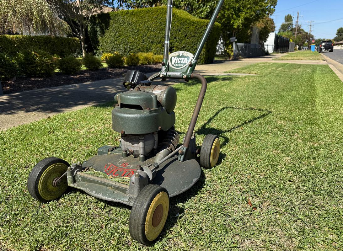

Hi there! I've been a long term lurker, this is my first post.
I've been into mowers since I was a teenager, I'm now 38 and still obsessed! My passion is for Victa's, mainly because my grandfather had a green Victa VC Mustang, which he gave to me, and I still have running to this day. I've since owned countless Victa and other branded mowers as part of my business and as a general hobby.
Yesterday I picked up a Victa 18 that had been used as a showroom display for I'd guess at least 30-years. This is easily the oldest mower in my collection and my first interaction with these OG Victa's.

As you can see, she needs a little work. I would love to restore it to showroom fresh, but.........................then I wouldn't be inclined to use it. My goal is to just get it running so that I can use it as an occasional novelty.
The engine hadn't run in decades, and with fuel leaking from the fuel tap and carb bowl, it won't be for a little while longer yet. My first step was the remove the carb and assess what I needed. With it removed, out of curiosity I gave it a shot of starting fluid to see if it had spark, to my surprise she came to life.
So, the plan is to clean and rebuild the carb, rebuild the fuel tap, clean the fuel tank, then sort out the intake side of things. The choke lever on the dome-type air filter housing has broken, the rubber tube completely perished. I've since started ordering parts and I look forward to seeing where this project goes. For context, I have never rebuilt a carb before, let alone working on a machine this old. So, I'm learning new things.
Would love to hear what you think and what I should look out for.

Hi DFB,
Welcome here where we love our 2 strokes. No surprise that it fired up, they are amazing machines that changed the way the world cut grass/lawns all those years ago.
Good luck with the resto, they look amazing when brought back to when they left the factory.
Those wheels you have there are worth a kings ransom, be careful with them
My parents bought one exactly like that in probably 1963/4, first and last thing they ever bought on HP, Mum was horrified with the interest they paid on it it scared her for life. How times have changed, they were about 54 pounds and I think wages about that time were about 5 pounds a week

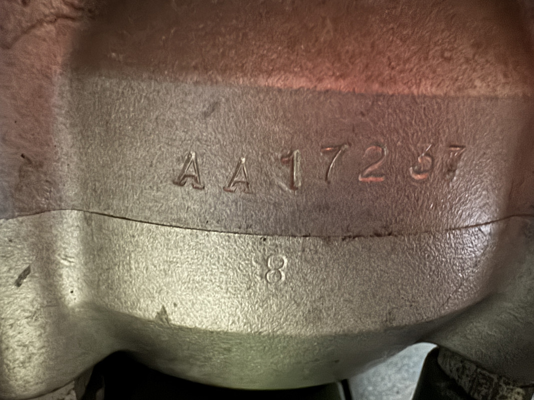

After doing a bit of reading, am I right in assuming this is a 1957 - 1961 model 5?
These are the numbers on the engine, which I can't make much sense from....................
[Linked Image from i.postimg.cc]

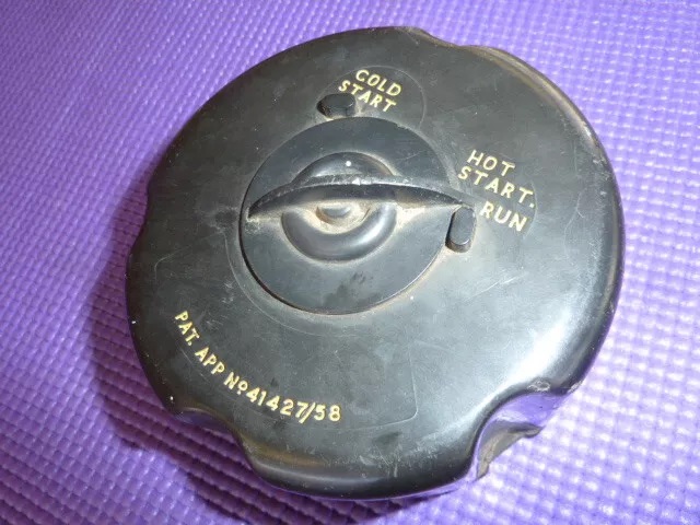

Also these engine don't run right without the snorkel connected to the carby and the air filter housing, they needs the restrictor in the
lower half of the air filter housing too.. This is mentioned also in the manual.

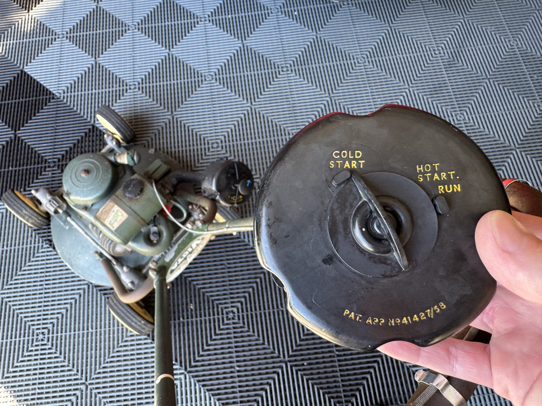

Thanks so much! That workshop manual helps a lot, very much appreciated.
Mine has the short pod style choke/air filter. One of the lower tabs and choke switch is missing, the rubber hose turned to dust. The machine came with a replacement hose but it doesn't quite look right. It also came with a filter but its horrid, the manual says you can't clean it, so I'm not sure what I'll do there.
I did order a long tube and filter housing, so hopefully that will work with this engine?

I'd just clean that original filter with the compressor and air gun DFB and see how it looks after a clean ,some
people just use a pit bike filter etc.

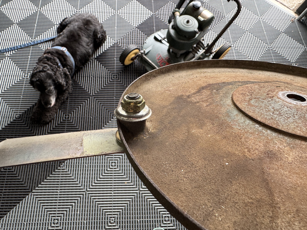

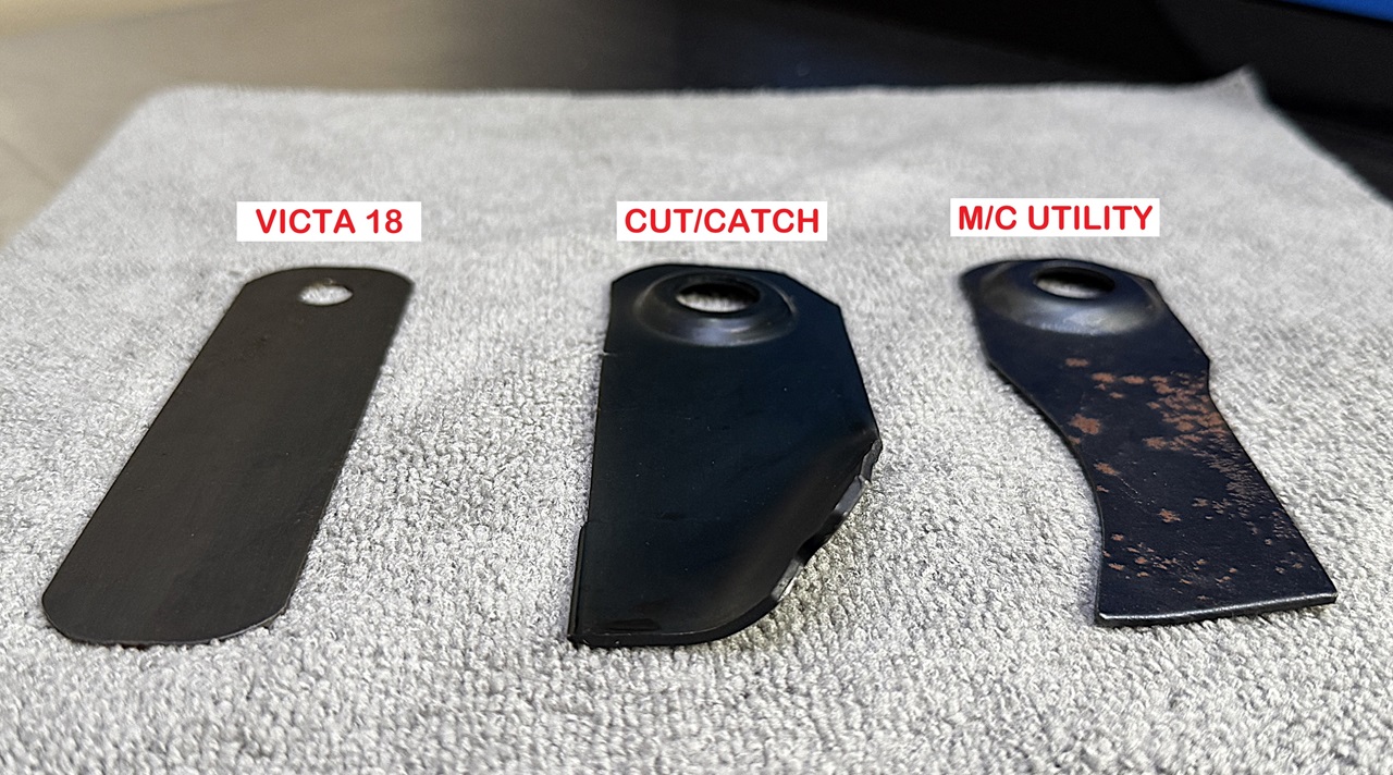

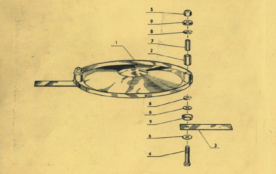

What are people using for blade bolts on these blade carriers?
I have a set of replacement blades, but they didn't come with hardware.

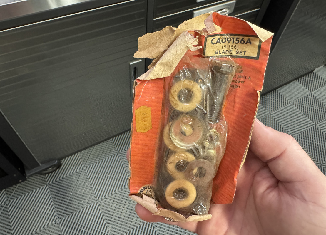

DFB #120727 22/01/25 10:10 PM
Joined: Sep 2015
Posts: 2,727
Likes: 220
SENIOR TECHNICIAN & HISTORIAN
Go to a bolt shop and get some high tensile bolts with lock nuts DFB or buy original Victa bolts for $30. that were 58 cents. shocked
For $30. you could buy a complete mower with good blade bolts.
1 member likes this: DFB

New aftermarket snorkels are available online. I'd be keeping that original filter housing if I were you they are hard to find with the VICTA logo, the later version didn't have the VICTA stamped on it.
The blade carrier you have pictured was used on the earlier rotomo model, the special had a different blade carrier.
For some reason, the disk I removed from the mower was earlier 3B design. Doing some research, I came across the following thread, seems some early Specials came with the older disk and blade arrangement.
https://www.outdoorking-forum.com.au/forum/ubbthreads.php/topics/11511/re-18-special-blade-disk.html

Starting on the Victa 18 this morning, I fitted a replacement blade disk in anticipation of getting the engine running. I'm waiting for a set of bolts to arrive, so the blades will go on later.

I also had a play around with the choke selector on the original pod filter housing. For this, I cut the leg off the choke, drilled out the circular piece then inserted an 80mm M4 bolt, locking it in place with a nut and washers. I then double-nutted the bolt about halfway down to set the correct height and installed the refurbished choke into the housing. Next, I installed another nut to help lock a small doorknob in place for the selector. I then orientated the choke into the lower housing and marked the knob for direction. I'm just waiting for the correct size tube and I'll give it a whirl. The reality is, the engine is starting pretty easy without a choke.
https://www.bunnings.com.au/pinnacle...B&gclsrc=aw.ds
https://www.bunnings.com.au/taskmast...-knob_p0132795

The Victa cut grass for the first time in decades....................
I had two passes by today say how cool this thing is, and like a proud "grandson" (it's just too old for me to be its fatherly figure), I couldn't help but proudly agree. It's not perfect, it's go a few battle scars, its noisy and kinda dangerous.......................but oh-so full of character.
So, while there is some tinkering still left to do, but I'd consider this old Victa recommissioned!
2 members like this: MowingManiac, QSR

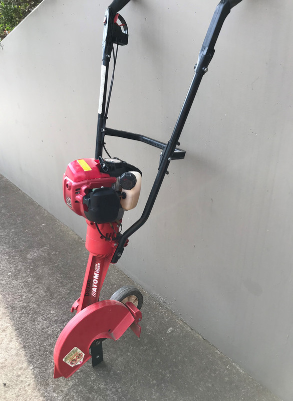

I toyed with restoring it because I usually like things to be perfect. But for some reason, I think there is charm to be had here so I decided to just get it running. If I had restored it, I'd then be inclined not to use, which would defeat the purpose of buying it.......................I just like the sound these things make.
The street, byproduct of living in a country town. And the edges, credit goes to a Atom Edger..................the only Honda engine in my fleet.

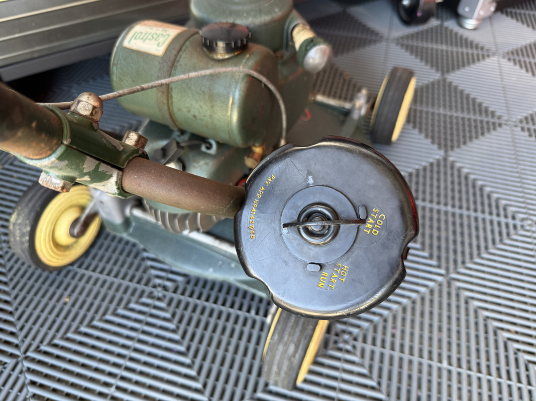

Fitted an inline fuel filter on the Victa 18 today.
I tried to get these locally, but my options are limited with small engine shops, and the one I went to of course doesn't bother stocking these very common Briggs & Stratton ones. Once again, online shopping to rescue.
These are a 1/4-inch barb Sten's branded aftermarket filter, OEM Briggs is hard to find in Australia. There are two types of these bi-directional filters, the white ones are for engines fitted with a fuel pump, the red ones for gravity fed fuel systems.
It obviously looks a little out of place on such an old mower, but it's at least functional, unlike the rope material used on the fuel tap submerged in the tank. I've been focused on getting this mower to a usable condition, so the filter makes sense in this application. I actually mowed my back lawn with it the other day and came away very impressed. For such a small engine, its got bags of grunt to rip through heavier growth.

I can't believe how hard it is to buy a replacement / alternative air filter for these.
I came across this video in my searches, and went looking for the Mann C88 filter, but it looks to be NLA.
After sifting through countless filters online, I came across this Baldwin PA1834 which on paper suggested it would fit.
https://www.filterdiscounters.com.a...rj6s2QcJh1MVz2qs#product-additional-info
These are the original filter dimensions -
Outside Diameter – 90mm
Inside Diameter – 40mm
Height – 60mm
These are the Baldwin dimensions -
Outside Diameter – 89.7mm
Inside Diameter – 50.8mm
Height – 50mm
So, I took a punt and placed an order.
My heart dropped when the outer diameter was just a shade to big to clear the indents on the filter housing. A little gentle persuasion on the outer rim of the filter with a hammer and it was fitting nicely. Just like in the video, there is a height difference between the old and new, so I used an foam tyre dressing applicator as padding, which I traced and cut to fit the central intake.
The new filter fits snuggly in place, just at the right height. My main problem is the broken tab on the lower filter housing doesn't hold the cap in place firmly to help seal the filter to the base. I'm still looking for a replacement, so had to resort to cable ties to hold it down. Not my usual style, but it will work for now.
I then went and cut the back lawn, which I had let grow a little taller than normal to test out the performance of the engine. Nothing beats a 2-stroke in heavier conditions, I just love how they sound when under load and powering through thicker growth. It's also interesting not having a traditional engine governor, the engine speed regulation is purely on the user. Not sure the neighbors appreciate the noise and smoke these engines make, but I'm having a ball! Actually, I'm surprised how well these mowers cut, the finish left behind is superb despite the lack of a catcher or a directional deck design or blades.

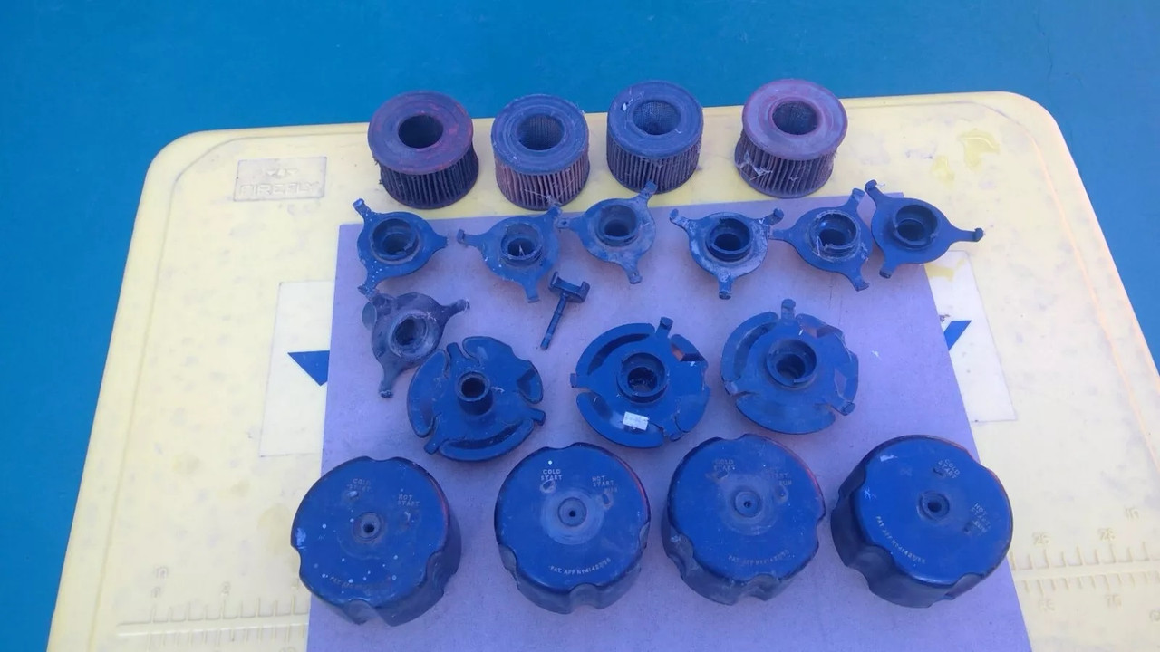

Early in my searches, I came across a collection of them on eBay that the seller was asking $230 for. Every piece was damaged, all were missing the switch. Silly money. I guess they could be repaired in some form, but again, there was only one of the actual choke insert, which is needed for the engine to run properly at full throttle.

A couple of "finishing touches". The funny thing is, when I started this project, tracking down certain parts was somewhat difficult. Then as I was coming to the end, parts started to appear out of thin air................typical.
Firstly, I managed track down a full set of blade bolts, cup washers and felt washers. While I had the correct nut and bolt, without the associated washers I wasn't happy with how the blades were mounted on the disk. These things are dangerous as it is without having the blades secured as intended.
And finally, the replacement filter housing was the final piece of the puzzle, I now have a fully functioning Victa 18 Special..........................
At some point, I'll need to look at the starter as it's not always recoiling. This one has the metal wire rope, something I have never seen let alone dealt with before.
As intended, I bring it out for the occasional mow, its just so charming.

As per the above-mentioned rain, the Kikuyu is having a field day at the moment. This Victa cuts through it effortlessly and actually finishes down remarkably well.
I do wonder if the thinness of the blades helps cut the grass cleaner and finer. The blades shown below are all 18-inch blades, the one of the left is for the Victa 18, the middle one is for a standard 18-inch cut & catch model, and the one on the right is for a MasterCut utility.
It was hard getting an image that clearly shows what I'm talking about here. A rough measurement has the Victa 18 blade at just above 1mm, the other two are just under 3mm. Might not sound a lot, but it's very noticeable in your hands.
Now, having said that, Victa offered three different blades for these mowers, Fine (22 gauge / 0.759mm), Medium (20 gauge / 0.911mm) and Extra Heavy (18 gauge / 1.214mm). Going off that, I have the Extra Heavy set fitted. Frankly, even these thicker blades are pretty dicey, no wonder they would slice people up.
When I bought this mower, it came with a collection of period owner's manual and supplements. The following is from the small paper slip that held a set of complimentary "MEDIUM" blades, all in 1950's speak........................
Dear Victa Owner,
Your Victa Mower is at present fitted with Victa "FINE" blades (22 gauge). Continuous research has proved that these "FINE" blades give fine lawns that velvet finish.
For your particular purpose, you may find greater satisfaction and obtain longer blade life by using the Victa "MEDIUM" blades (20 gauge) as enclosed and which we ask you to accept with our compliments.
"EXTRA HEAVY" blades (18 gauge) are also available from all Victa Agents for use on your Victa when clearing very heavy undergrowth.
Genuine Victa Blades, which are made from specially rolled crinoline spring steel, sell at the one standard price, irrespective of thickness.
Ask your Victa agent for the blades you prefer:
"FINE" - "MEDIUM" - "EXTRA HEAVY"
Those starters can be a pain to get working nicely. When you look at repairing your starter and if your bothered you can buy new reproduction rubber handle covers in either black or green for $50 from a bloke in Sydney.
QSR #121251 28/03/25 10:25 PM
Joined: Aug 2019
Posts: 78
Likes: 21
DFB
Offline
I don't suppose you have a website link?
DFB #121261 30/03/25 02:48 PM
Posts: 61
QSR Offline
Here's the photos I couldn't PM them.
QSR #121262 30/03/25 05:56 PM
Joined: Aug 2019
Posts: 78
Likes: 21
DFB
Offline
Brilliant!! Very much appreciated!
