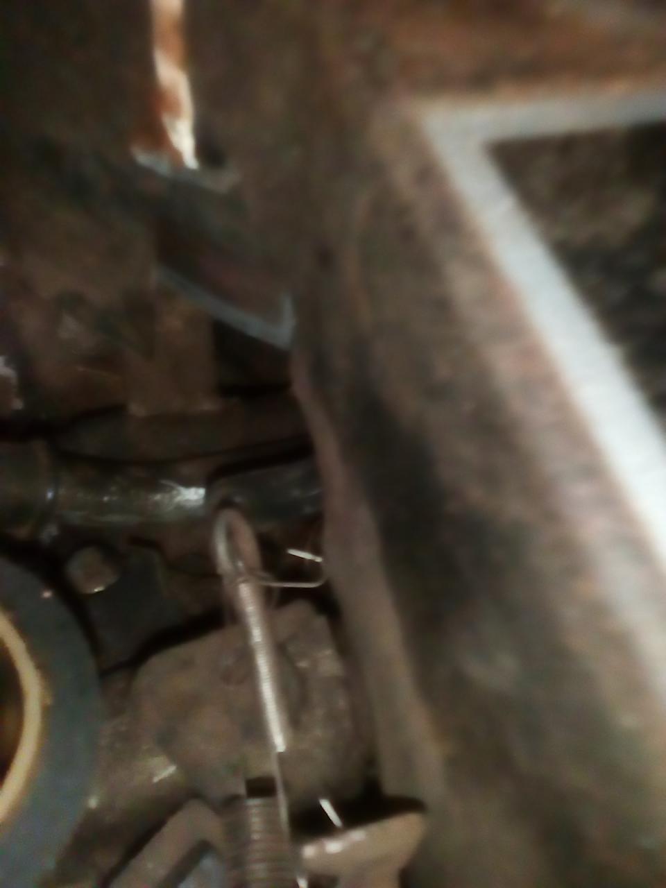

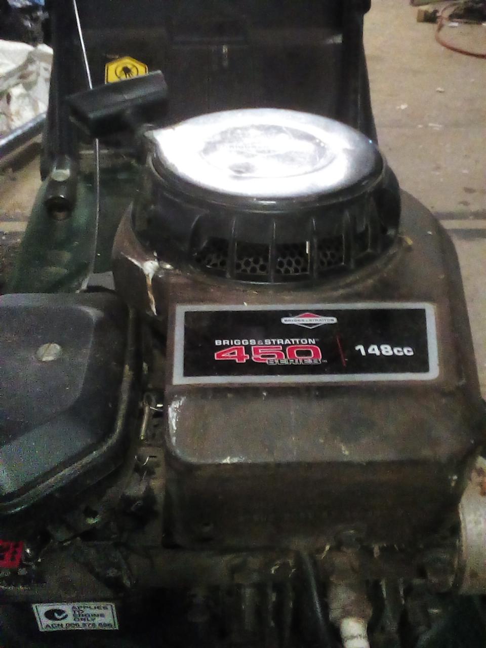

this is my latest buy a victa lawnkeeper with a 450 series b& s motor on it ,
runs not to bad ,bit sluggish, so after giving iit a run round the yard yesterday ,though seems to use a hell of a lot of fuel for a 2 stroke ,my other old victa that I sold ,thats the one I powder coated ,it used 1 1/2 tanks to do this yard, and the lawnkeeper used 3 tanks of juice ,bit thirsty, so last night I was prowling through u tube to find videos of this beast and the usual problems ,firstly I will take off the carby and give a good clean ,new air filter ,get new springs for the Governor as these ones have been stretched and twisted and maybe a new plug and that should sort it.

"though seems to use a hell of a lot of fuel for a 2 stroke " \
The Briggs is a 4 stroke and if it is running ok then leave it alone, changing the air filter is probably the only thing that will help with the fuel consumption
+ a big one to this.
Odds on that the air cleaner foam has never been washed out, since new. So it may need replacement.
This makes the engine run very rich, and greatly accelerates bore wear as well. Used to see this on many small Briggs engines that used this air filter setup, back in the 1970's.
