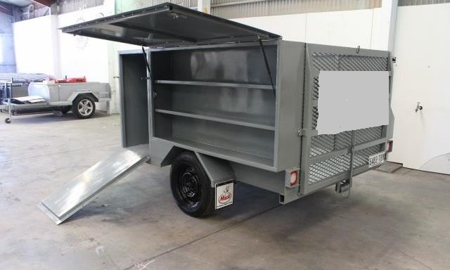

I'm building a mowing trailer for my grandson and I'm wondering if anybody has any suggestions as to what could/should be added before I start sheeting it up. It carries 3 catchers in the front section, 2 mowers and 2 whipper snippers in the main section, has a shelf for odds and sods, oil,rags, funnel etc. He wants a couple of jerry cans fitted on the outside but I'm not sure if that is a good idea because they would be exposed to the sun unless I built a cover over them. Open to any suggestions.

Dunno, maybe a slide out ramp so the mowers can be wheeled in and out?
Hope he has a four wheel drive or large ute to tow that with.

My only suggestion would be to frame up the sides and make them lockable cupboards, ideal for trimmers, blowers, pole saws chainsaws, brooms , shovels etc, otherwise its dead space housing a 2 guards and a spare wheel. Obviously the spare wheel would need to be moved to the underside.

My suggestion would be to put wheels on that green mower, would make it so much easier to use. smile If you use the steel type jerry cans they have no problem being out in the sun.

Ok I guess I should have put wheels on the green mower, I was just making sure everything will fit. Yes Bigted, I have thought about the lock up shelving, but at the moment I want to get it finished before I loose interest as I need to get it out of my driveway because SWAMBO's car is getting closer to the street and that can get dangerous

Hi Carreon, I have only recently finished building one very similar to the pic but the hours I spent building it would just be staggering. $1000 in materials and weeks of work
