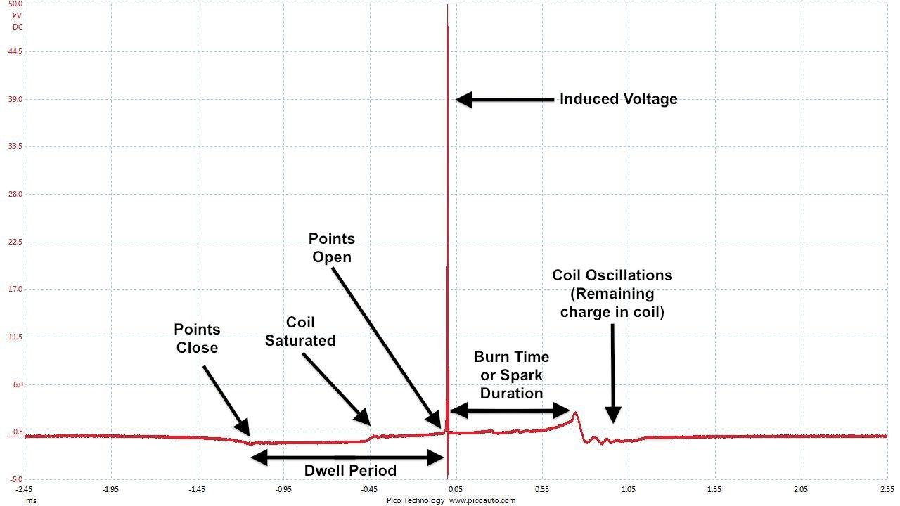

Hi LRT, is the Victa waveform from one of the coils we had here that we proved worked fine. I wouldn't go to too much trouble trying to straighten the crank, I have a pile of full crank motors out the back, just not sure if you can use the early cup type starter crank in the side pull motors. Never looked into that. They have the points ignition and not sure if you could use the side pull flywheel on the early crank. Never know till you have a go.

Hi Jeff,
Yes the first waveform is taken from the Victa that wouldn't go.
Unfortunately I haven't got a waveform of Norm's rebuilt engine as the computer was playing up and had already arranged the delivery of the mower.

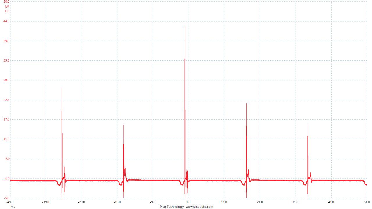

Here is the oscilloscope waveform of a Victa Utility 460 "Powertorque" engine:
Immediately you can see the induced voltage (spark voltage) is a lot higher than 2kV !
Of course there is always a small variation in the induced voltage due to variations in the fuel-air ratio, fuel quality, engine speed, engine load, ambient temperature, etc.
Unfortunately, I can't measure the primary voltage and current on this coil as it is the later type with the built in module.

It's typically in the 300-350V peak region, and is somewhat rpm-dependent, for these magneto ignitions.

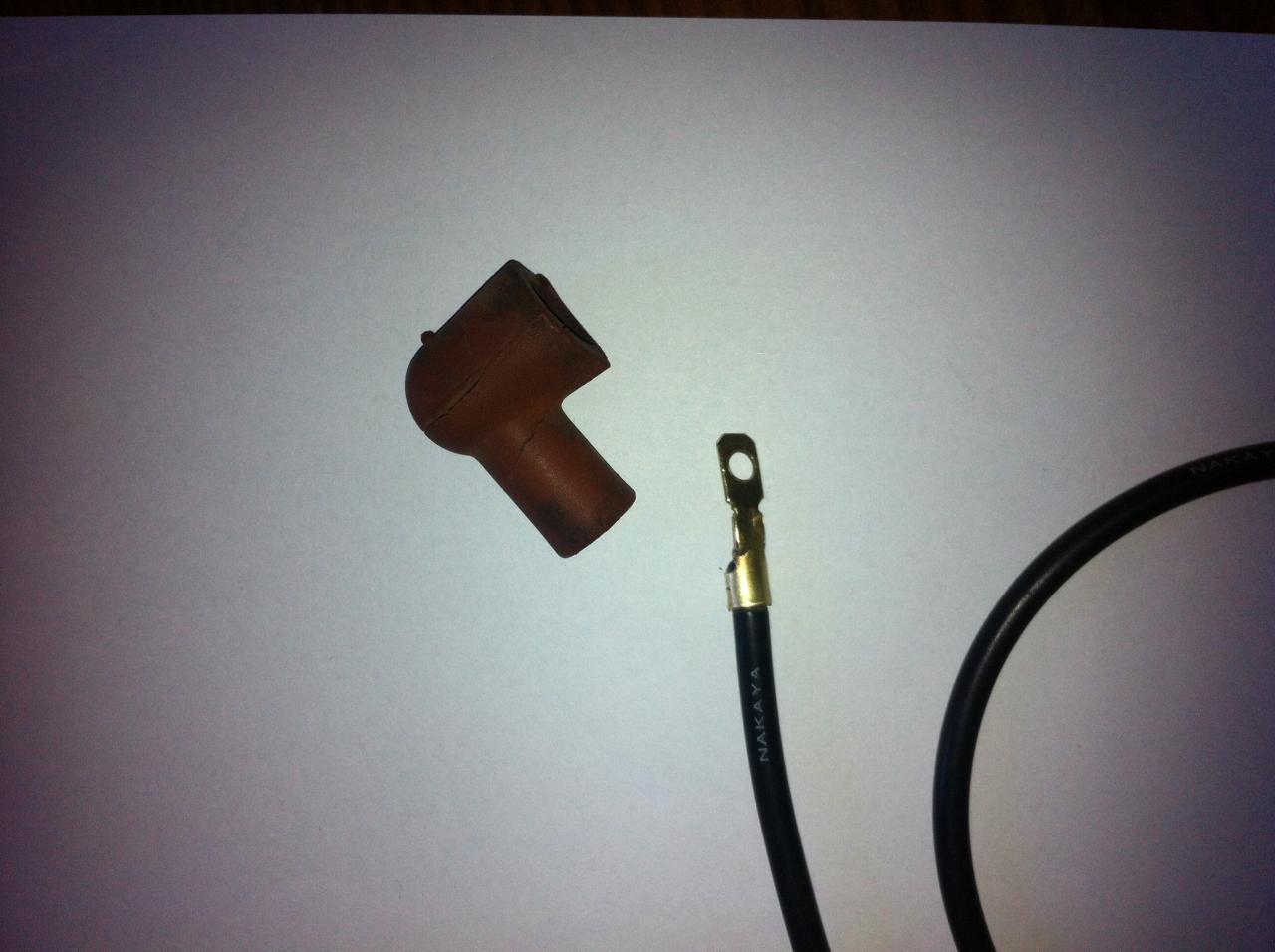

The brass tag will fit in the red boot with a little persuasion. Then remove the top on the spark plug. See the pictures below:

Thanks LRT,
Looks like ODK is the way to go. Beautiful photos by the way.
