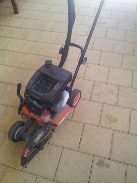

Yup, that's an early 160cc full-crank Victa Tilt-a-Cut edger; the later models had the PowerTorque engine. Some good threads on these TaC units are over in the ODK 'Edgers' section, too.
They're a great edger, particularly when fitted with the 'segmented disc' cutting blade - which does a better job, as well as being much safer than the 'bar' type blade.
This one:
Well worth a little 'fettling'! I've actually been on the lookout for one of these [for cheap, of course] wink .

Thanks for the answers guys, weirdly mine has the pull start at the front of the engine and it pulls out to the right

Nah, not weird really; that just means that yours is the 'late full crank' engine, with the 'side pull' geared starter.
Almost certainly, it will have electronic ignition rather than mechanical contact points, too. yay

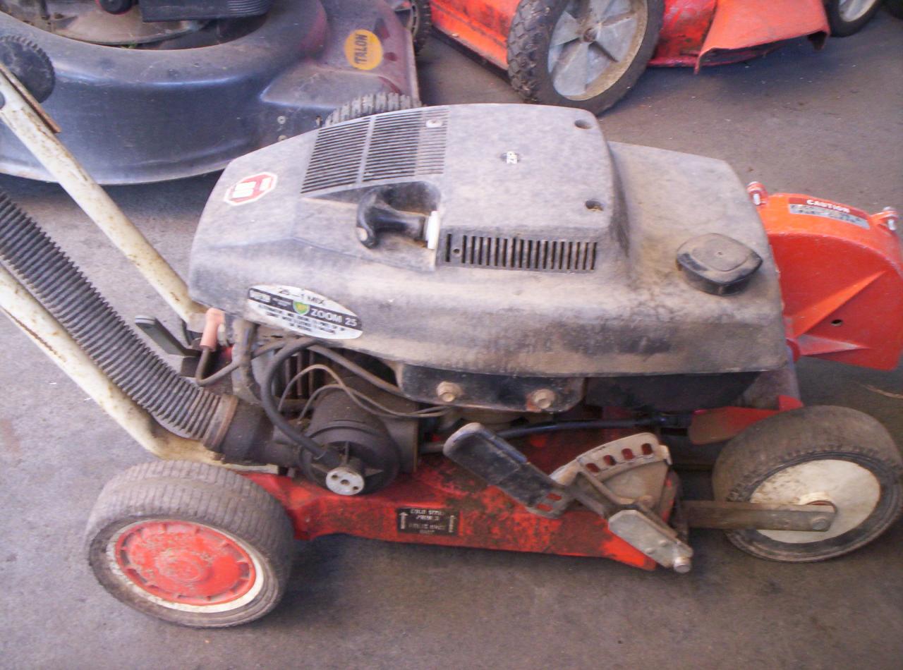

Normally that series motor was always mounted East West (head facing side), which is why the fixed side starter is located on the odd spot on your machine, as the motor is mounted north south instead.
The motor and cowl setup on the machine that preceeds yours (see photo below), was normally mounted the same way as the TaC so the starter faced the rear as normal.
I found the following pic via Google images showing the round blade Gadge mentioned.
