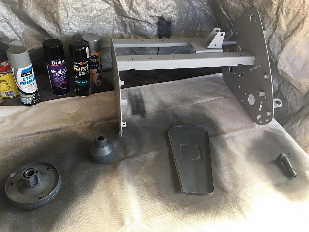

so, I'm down to bare metal and was to get some primer on ASAP. Any tips for types of paints? clear coats to make it stronger? Can I get it powder coated? or stick to enamel spray on? Thanks in advance.
Posts: 2,998 Likes: 16
Hi DB,
I would be using a Metal etch Primer and then straight enamel Hammertone. Forget Powder Coating it's not the best on steel where abrasion and piercing of the coating is inevitable and also moisture in between the base metal and the thin plastic coating. Powder Coating is done for ease of production on a mass scale.
Cheers, BB.

Joined: Dec 2016
Posts: 24
thanks for the advice lads. I had to get the stripped parts in primer to avoid any rusting, but will look into the small suction feed gun. BB - now your making me feel bad. I had a bit of practice using some black hammertone (Can) on a piece of scrap steel and it seems to be a bit of an art form in itself. I couldn't get it right. If I go down the path of chasing the colors (green) then I best practice my technique a bit more otherwise its going to end up pretty crapola. ![[Linked Image]](https://www.outdoorking-forum.com.au/forum/uploads/usergals/2017/02/full-10905-33208-img_20170226_152556.jpg)

Joined: Dec 2016
Posts: 24
BB, you have talked me into keeping it original!! So I have everything sitting in etch primer ready to go. (I'll post pics soon) Now i just need to find some paints/suppliers in Perth...... or maybe just run with some of these....lol http://varietypaints.com.au/collect...acolor-hammertone-spray-paint-deep-greenI still have not decided on a spray gun, but it seems most prefer the gravity feed over the suction? haha again this all seems like a larger learning curve then the bonnar itself!
