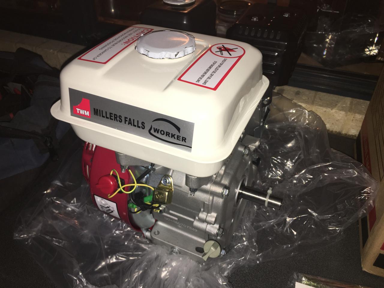

Plenty of inspiration... Chonda arrived today...bit bigger than expected but all good. ![[Linked Image]](https://www.outdoorking-forum.com.au/forum/uploads/usergals/2017/01/full-10905-32253-img_2485.jpg) ![[Linked Image]](https://www.outdoorking-forum.com.au/forum/uploads/usergals/2017/01/full-10905-32254-img_2483.jpg)

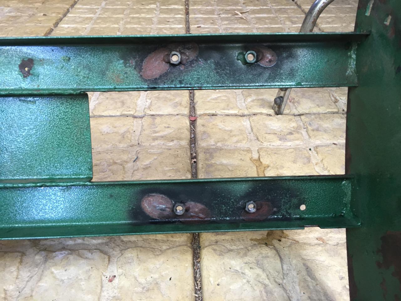

On a side note, I also got stuck into the frame with a sand blaster (just a machine warehouse one) and that original green powder coat is pretty bloody stubborn in some places. Might have to bang a sanding pad onto the grinder.
Posts: 2,998 Likes: 16
Hi Dee Bee,
If you are referring to the frame that's illustrated in this thread then I'm going to be the bearer of bad news............................it's not Powder Coating, that's merely enamel paint. Powder Coating didn't come into use until around 1985 when Rover issued that awful lime coloured Kermit Green in PC.
Cheers, BB.
