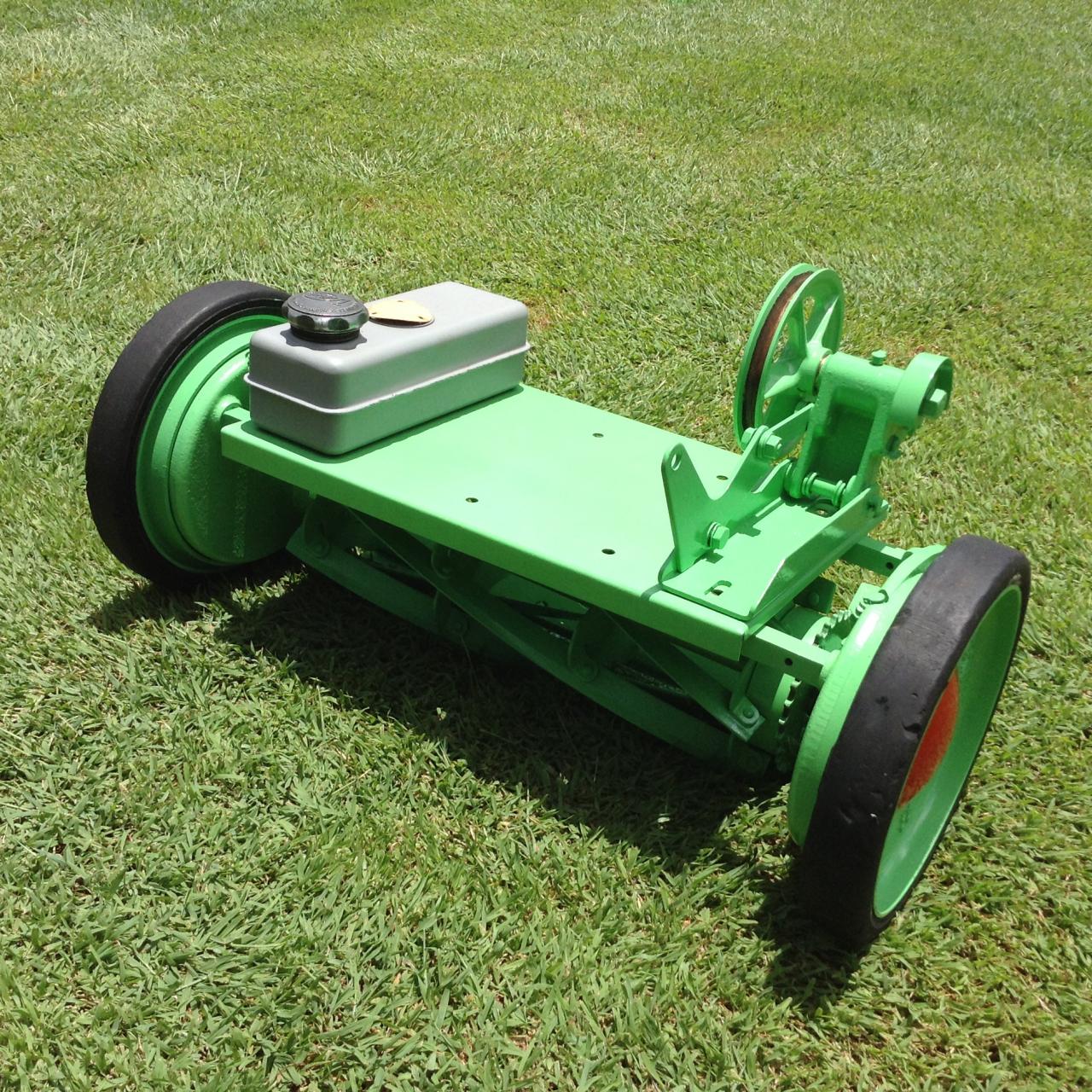

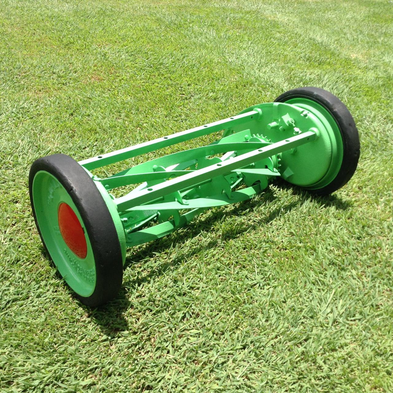

A little more progress today. With apologies to Jack for the colour on the hub caps. I know it should be more orange but that's as near as I could find at Bunnings. It could have been worse though Jack - I was so close to painting the reel red as well. There's a lot of green on that mower!

G'day CarinaBob
These are the best images we have of a Qualcast P1 restoration!
Absolutely fantastic!
I spoke with his Holiness, Pope Francis today.
He noted your colour choice and said, "the Qualcast orange is an orange, has
CarinaBob not been to Valencia?"
I said, "No, but CarinaBob has been to Bunnings..."
His whole tone changed. He said, "I bless this new colour!"
[I think he may have confused Bunnings with 'Bunny' - Easter.]
This is a great post - in helping others - but also that it
is heading towards a resolution - the images of its display in July.
Many thanks for sharing this restoration.
p.s. I'm so glad you didn't go for a red reel.
His Holiness said that was the Devil's colour!
I can't repeat what conversation ensued...
CarinaBob - have you considered making a reproduction catcher?
Unusually, these were offered as standard.
