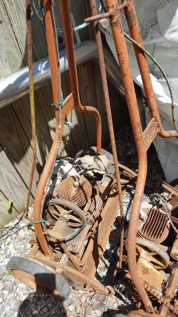

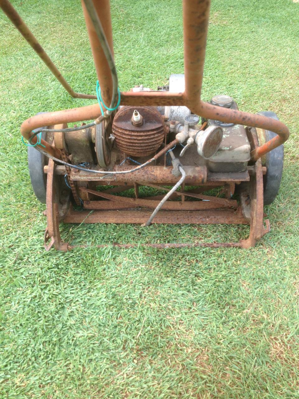

I was fortunate to pick up these two Qualcast P1 mowers before Christmas. One is badly rusted in some areas but will be a good parts machine. The other is still very sound and with some work I'm hoping it will come up well.
I've had holidays so have managed to make some progress. The mower is completely disassembled and I'm currently working on paint stripping, electrolysis bath, priming and re-painting and turning up new rollers.
I'll try and post some more pictures as things progress.

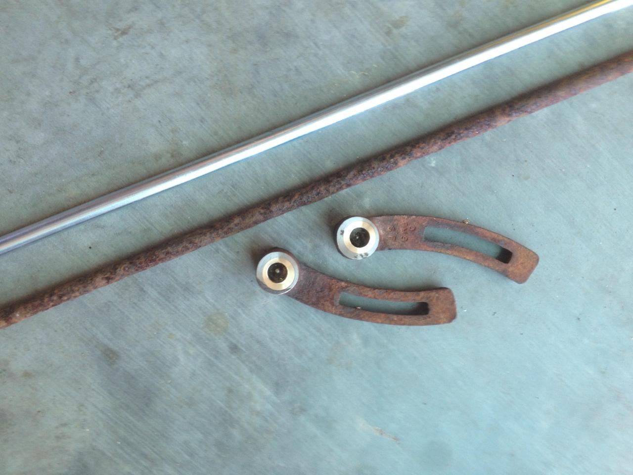

The roller carriers were badly flogged out so I bushed them up with some brass. This old girl's grass mowing days are done so the brass should hold up long enough to see me out. Some new galvanised bar from Bunnings should make a good new axle,

I'm not planning on sharpening anything for a couple of reasons. Firstly some of the screws holding the bed knife to the sole plate were quite rusted to the point where the threads were a bit dicey. I turned down some new screws but I wasn't able to tighten them as much as I would have liked. Secondly, after putting so much effort into restoring the mower I don't want to be mowing any lawn with it. I'm too lazy to clean up the mess! Having said that, I plan on having everything functional on the mower - it just won't be cutting lawns anytime soon.
