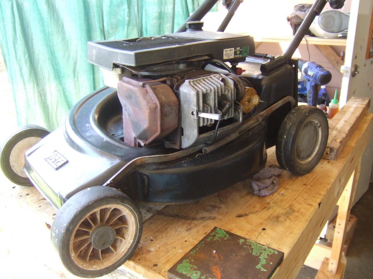

I am getting a powertorque going, the reason it stopped was starter. I am just going to do a decoke, rings are good.
But that starter was hard to unloosen. I tried as in manual, hold nut in vice and use spanner , wouldn't move. I put a socket in the vice and it held the nut much more securely and used two spanners to loosen the nut... worked.
speedy

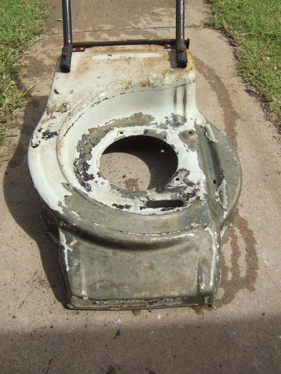

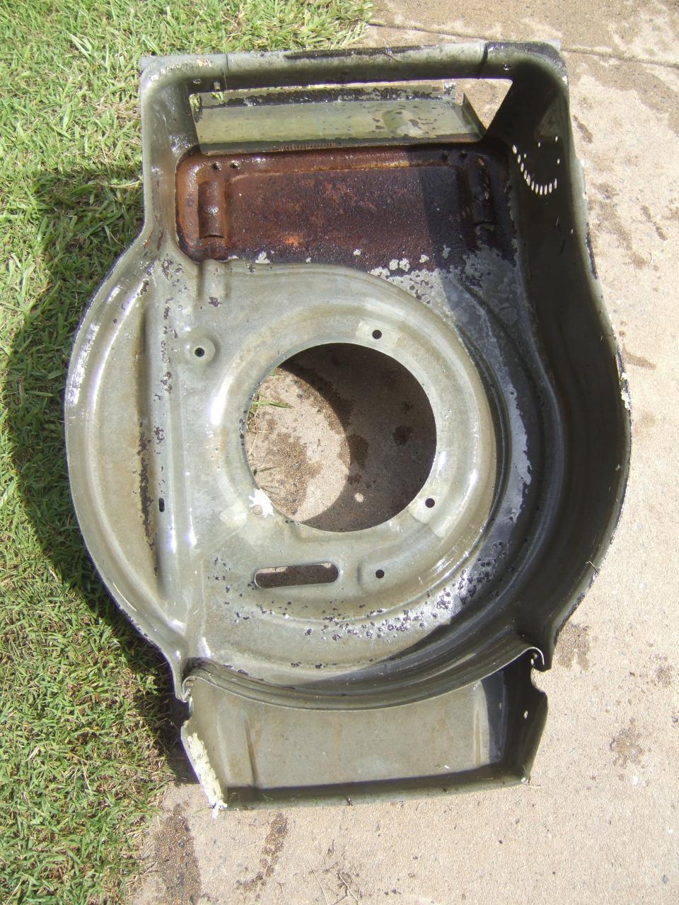

Now I'm just soaking the base in mixture half and half molasses and water for two weeks.....

You don't need to use 1+1 dilution with the molasses bath. Anywhere from 1+5 to 1+10 seems to work well, too.
Being a tight arse, I mixed my first one at 1+10, and I've seen no reason to change... Though it can take a while, if the rust layer is thick [earth tools etc].
speedy #81288 15/01/17 05:03 PM
Posts: 1,233
Likes: 32
Thanks Gadge, I will fill it up a bit more.....hard to find a large container laying around.

after 11 days in the soup........ I will sand the rest off. It was a major test , works well. I just need a bigger bath.....
