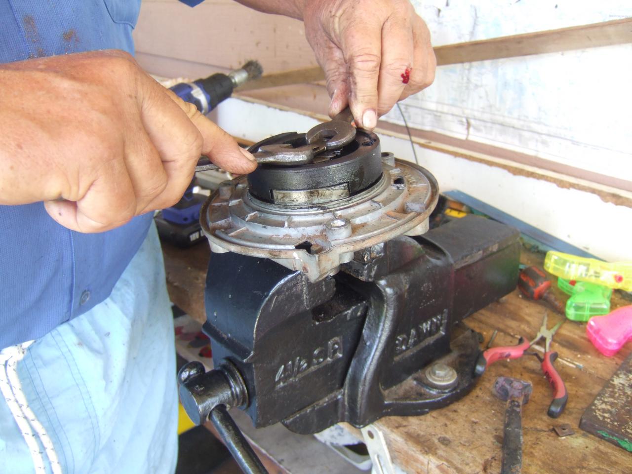

I am getting a powertorque going, the reason it stopped was starter. I am just going to do a decoke, rings are good.
But that starter was hard to unloosen. I tried as in manual, hold nut in vice and use spanner , wouldn't move. I put a socket in the vice and it held the nut much more securely and used two spanners to loosen the nut... worked.

Speedy, good trick. I like it. Thanks for sharing.
I still get a lot of powertorques through for refurb so your idea of the socket in the vice will be used!

Is that wire brush head your tool of choice for the coke removal?
Was the skinned knuckle the motivator for the socket solution?
I would have thought that a round item like a socket would be prone to slip inside the jaws of the vice.

Skinned knuckles , guess they helped me think. Big vice will squash that socket.

Posts: 445
Speedy your trick worked a treat last night on some pretty tight starters I fixed up. The socket in the vice trick gives a lot more leverage.
