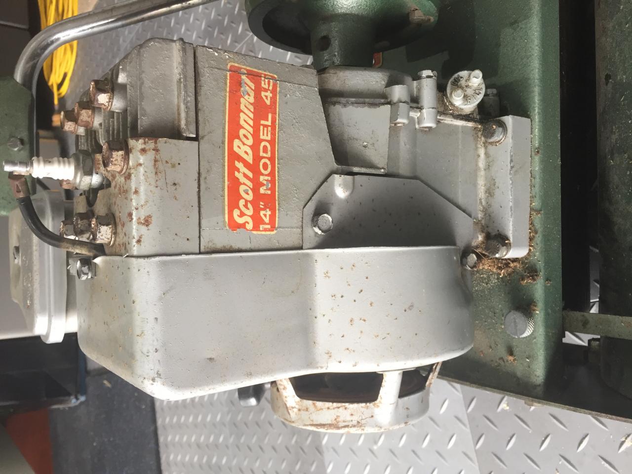

Hi everyone This is my first post and a new thread on our family Scott Bonnar. My grandfather purchased it in 68-69 and then passed on it to my father. Ive been thinking about this mower for quite sometime. I came across ODK a few months ago and after reading everyones resto stories my desire to do ours could not wait any longer. Back when I was a child we would only get out the SB to cut the cricket pitch or cut out a putting green. The rest of the time it just sat unused in the shed. On Sunday I picked up the mower. I am now the 3rd generation holder of this mower. My plans are to get it sharpened and running again. Then I want to scalp my lawn and sand it to get it level. While the lawn is regrowing I will get the body and reel painted. I'm open to your suggestions on whether to repaint the motor or keeping the patina. ![[Linked Image]](https://www.outdoorking-forum.com.au/forum/uploads/usergals/2016/10/full-10705-30777-img_0365_resized.jpg) ![[Linked Image]](https://www.outdoorking-forum.com.au/forum/uploads/usergals/2016/10/full-10705-30778-img_0336_resized.jpg) I will post more photos after I resize them. Don

That's one of the first model 45's to be made as the engine is an early 1968 issue. Can't quite read the code that you've put up as it goes out of focus.
It's in fabulous condition and really hasn't done that much work. Give it a good clean and relube and you'll find after a reel and bed knife grind it will be as good as a new one. It's in much the same condition as my original 45 that I started with and I used it like that for over 30 years until someone stuffed the barrel of the block when re-ringing it which was it's only downfall as it was puffing smoke like "Puffing Billy".
Cheers, BB.

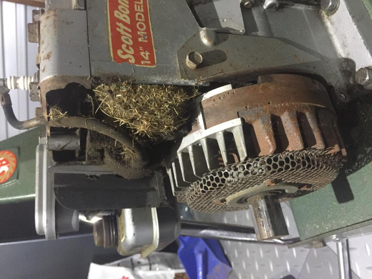

First job was to remove the reel and bedknife and get it off for sharpening. Here are some close up photos ![[Linked Image]](https://www.outdoorking-forum.com.au/forum/uploads/usergals/2016/10/full-10705-30827-_20161028_214853.jpg) ![[Linked Image]](https://www.outdoorking-forum.com.au/forum/uploads/usergals/2016/10/full-10705-30828-_20161028_214713.jpg) Not long after dropping them off I got a call to say the bedknife would have to be replaced. Its hard to see from the photos above but the left and right tips were bent up. I can only assume this was the reason my father could not adjust it to get a nice cut.

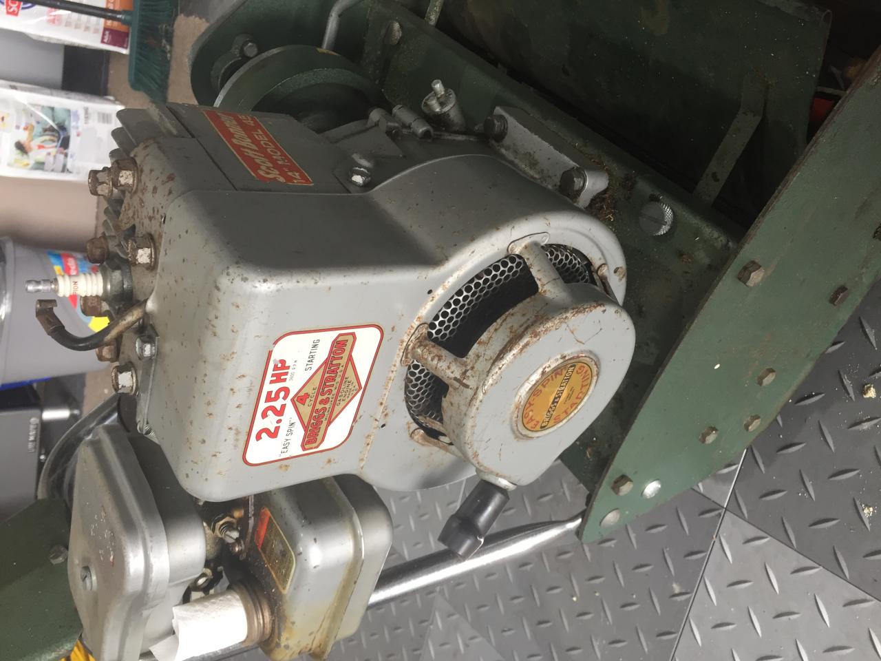

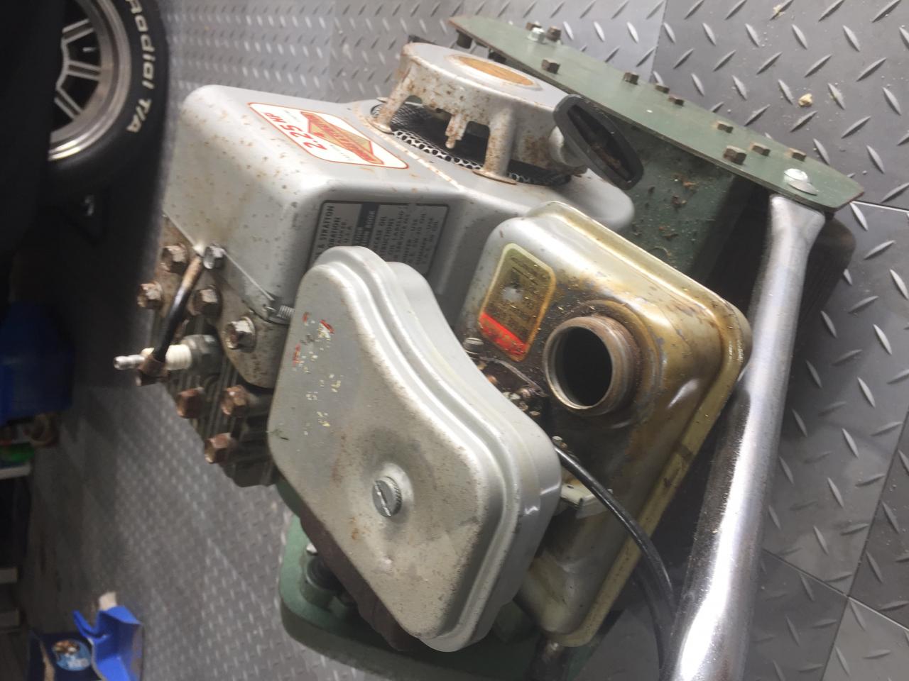

Next step was to see if I could get the engine started. Any old fuel had already evaporated so I filled the tank with fresh petrol. I then took out the spark plug put about a teaspoon amount of fuel in the cylinder. With the choke out and full throttle I gave the starter a pull. The engine sluptered a little and stopped. I then pushed the choke in and gave it another try and it fired up.
It was pumpung out a little bit of smoke but not to bad.
I will post a video soon when I work out how to do it.
Donny
Posts: 2,998 Likes: 16
Hi DonnyW,
I thought that this might be the case as the outer corners looked a tad suspicious.
Regardless a new bed knife will see it right for many more years to come.
One thing your bed knife photos clearly show and that is that Scott Bonnar painted their sole plates in the same colour as the overall chassis.
This has been a topic of debate many times over here in the forum but yours being an original paint job is proof of settling this argument for once and for all.
I hope that you are having new bearings installed onto the reel as if you are using the old ones there will be an amount of wear on them and you'll never be able to adjust the reel accurately and it won't be machined accurately either.
The only bearings you can obtain for these reels are sealed "RLS5" bearings which are far better than the original open sided units that allow grit to get into them and shorten their lives rather rapidly.
Cheers, BB.

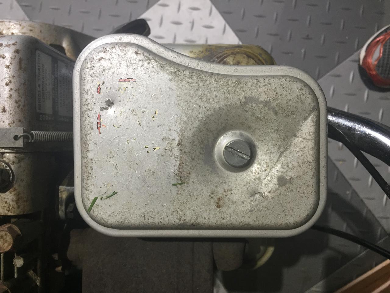

Question What would be the best way to remove corrosion from throttle controller? ![[Linked Image]](https://www.outdoorking-forum.com.au/forum/uploads/usergals/2016/10/full-10705-30854-_20161030_100432.jpg)

Lawn Freak
Some scrunched up alfoil and some water works pretty well for the throttle controller, clutch lever and chrome on the handlebars. You can use some vinegar or Coke if the corrosion is really bad, just wash it it off afterwards. It is hard work, but will give a decent finish providing the chrome isn't too far pitted.
Hi Guys,
Honestly I've always used fine steel wool. It will remove all the unsightly stuff and take off the high spots that you can feel, but regardless of that it's the plating that is breaking down and allowing moisture to get to the base metal which is what is corroding.
Well that 17 inch model 45 is looking brilliant Simon, but then we've become used to your level of workmanship, it's simply first class and better than any factory finish that we've seen.
Cheers, BB.

From a historical perspective, it is a real treat to see an original,unmolested Model 45 14". You have given us a great story, and great photos of the Maker's serial number and the original instruction sheet. Amazing!
Would it be possible to confirm the engine model type and code. I guess the spec was 60102 0144-01 XXXXXXX.
This is certainly a collectible machine and well worth preserving. Looking at Simrice's magnificent machine reminds us of the unique position the Model 45 holds in our lawnmower history - it is both vintage and contemporary. It holds its own with any residential reel mower made today.
This topic goes to the provenance of your machine, now in the custody of the third generation. It has been very well maintained too - just look at the condition of the sprockets.
You are in good hands with Mod BB's and Simrice's advice.
Good luck with your restoration. ------------------------------------- Jack

![[Linked Image]](https://www.outdoorking-forum.com.au/forum/uploads/usergals/2016/10/full-10705-30871-img_0376.jpg) This is the best I can do with a photo of the model type and serial number.
Posts: 88
Am I correct in saying the engine was built 5th August 1968?

You are spot on with that date Cirillo.
Regardless of the current condition of the bearings I'd still put new sealed units on the reel shafts. The original bearings are open sided and allow dirt and grit in and thus the degredation has already begun.
Cheers, BB.

Hi all I really appreciate your tips and feedback especially as I'm a newbie to this site. Simrice, you are a champion for your tip on using alfoil and water. Check out the results ![[Linked Image]](https://www.outdoorking-forum.com.au/forum/uploads/usergals/2016/11/full-10705-30890-_20161101_172719.jpg) ![[Linked Image]](https://www.outdoorking-forum.com.au/forum/uploads/usergals/2016/11/full-10705-30891-_20161101_172757.jpg) ![[Linked Image]](https://www.outdoorking-forum.com.au/forum/uploads/usergals/2016/11/full-10705-30892-_20161101_172531.jpg) Thats the best I could get on the throttle controller. It really needs to be rechromed as it has all been eaten away by the corrosion. The rest of the clean up is coming along nicely. Cant wait to receive all the new parts including the new enclosed bearings for the reel and trying it out on my lawn. Freebird, thanks for the heads up on lightly oiling the chrome work. I have applied a nice film to protect it for now. I had a good play with the old bearings. There was no play in them at all but they did not spin as freely as I think they should which would be consistent with your feedback BB. I suspect they have accumulated a bit of grime. Next time I will replace bearings before getting a reel sharpen. The things you learn in this new journey. Whats everyones thoughts on the reel to reduce further rusting. Would you suggest oiling it or using some sort of rust coverter solution being careful to keep this away from the cutting edge. Any secrets out there for removing the rust and rejuvenating the engine? For now I want to keep it all original but want to make it as clean and tidy as possible. Keep the feedback coming. Cheers Donny ![[Linked Image]](https://www.outdoorking-forum.com.au/forum/uploads/usergals/2016/11/full-10705-30893-_20161101_172938.jpg)
