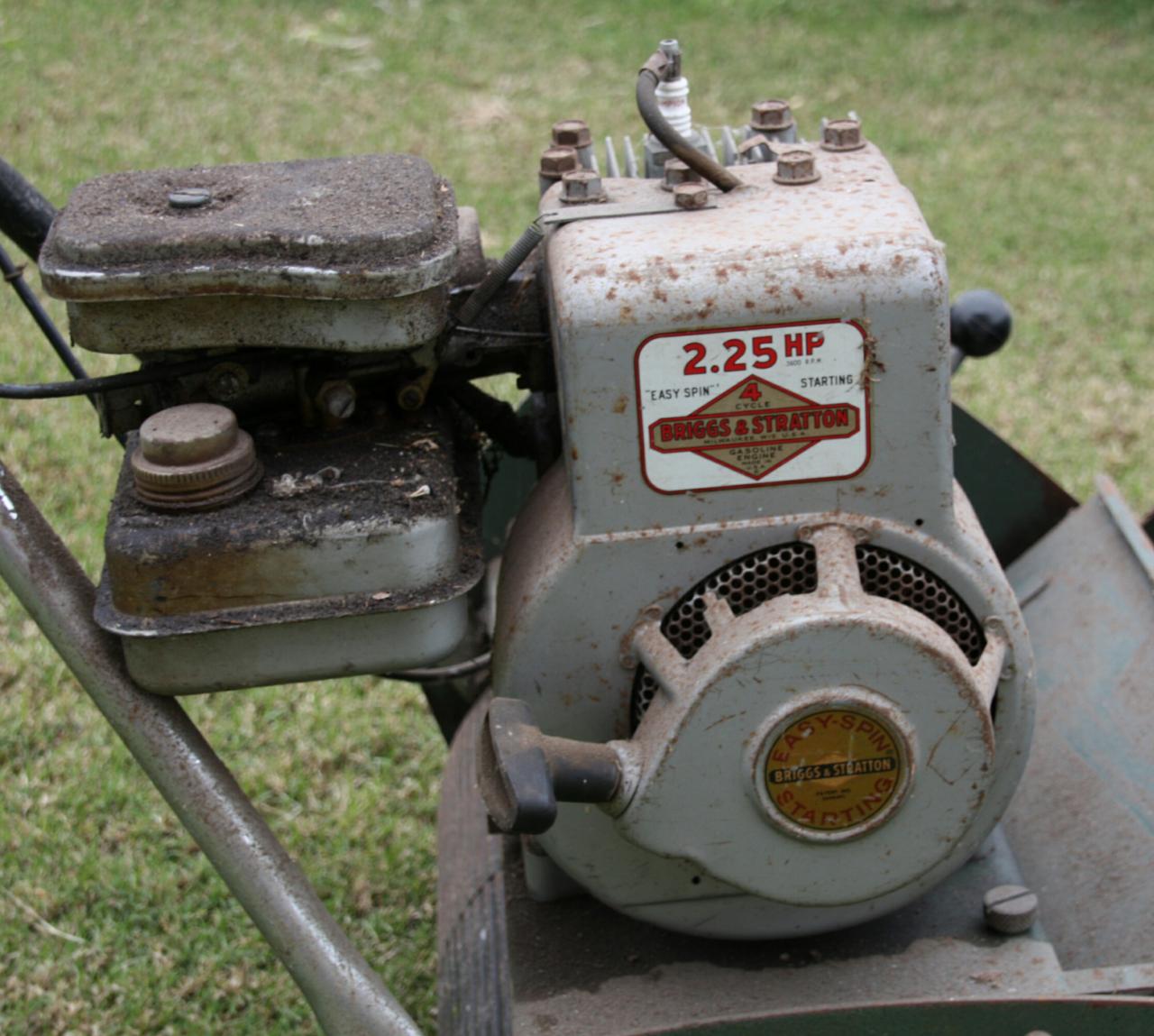

Next step was to see if I could get the engine started. Any old fuel had already evaporated so I filled the tank with fresh petrol. I then took out the spark plug put about a teaspoon amount of fuel in the cylinder. With the choke out and full throttle I gave the starter a pull. The engine sluptered a little and stopped. I then pushed the choke in and gave it another try and it fired up.
It was pumpung out a little bit of smoke but not to bad.

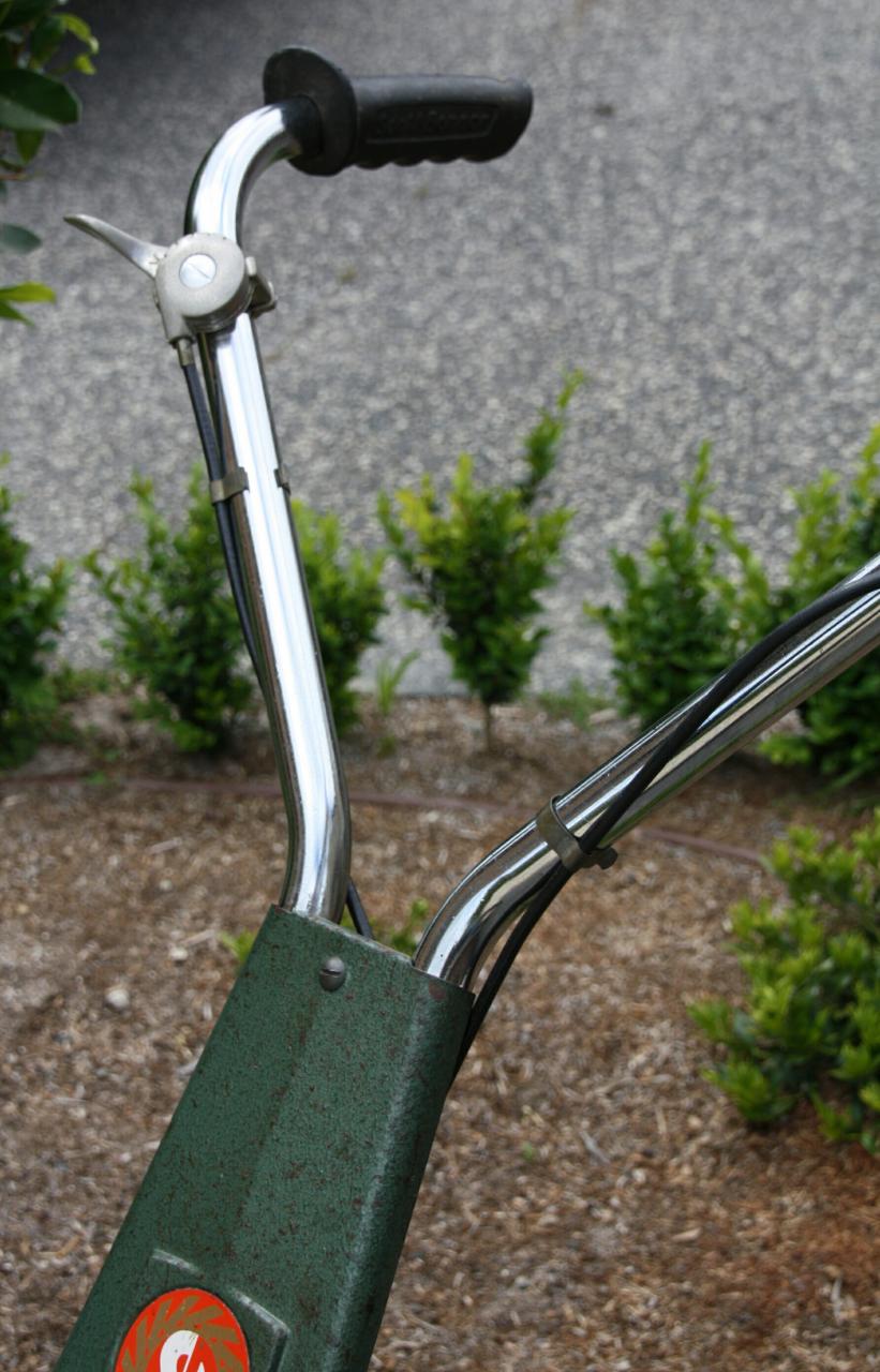

Question What would be the best way to remove corrosion from throttle controller? ![[Linked Image]](https://www.outdoorking-forum.com.au/forum/uploads/usergals/2016/10/full-10705-30854-_20161030_100432.jpg)

Some scrunched up alfoil and some water works pretty well for the throttle controller, clutch lever and chrome on the handlebars. You can use some vinegar or Coke if the corrosion is really bad, just wash it it off afterwards. It is hard work, but will give a decent finish providing the chrome isn't too far pitted.

Honestly I've always used fine steel wool. It will remove all the unsightly stuff and take off the high spots that you can feel, but regardless of that it's the plating that is breaking down and allowing moisture to get to the base metal which is what is corroding.

From a historical perspective, it is a real treat to see an original,unmolested Model 45 14". You have given us a great story, and great photos of the Maker's serial number and the original instruction sheet. Amazing!
Would it be possible to confirm the engine model type and code. I guess the spec was 60102 0144-01 XXXXXXX.

![[Linked Image]](https://www.outdoorking-forum.com.au/forum/uploads/usergals/2016/10/full-10705-30871-img_0376.jpg) This is the best I can do with a photo of the model type and serial number.
Posts: 88
Am I correct in saying the engine was built 5th August 1968?

You are spot on with that date Cirillo.

Hi all I really appreciate your tips and feedback especially as I'm a newbie to this site. Simrice, you are a champion for your tip on using alfoil and water. Check out the results ![[Linked Image]](https://www.outdoorking-forum.com.au/forum/uploads/usergals/2016/11/full-10705-30890-_20161101_172719.jpg) ![[Linked Image]](https://www.outdoorking-forum.com.au/forum/uploads/usergals/2016/11/full-10705-30891-_20161101_172757.jpg) ![[Linked Image]](https://www.outdoorking-forum.com.au/forum/uploads/usergals/2016/11/full-10705-30892-_20161101_172531.jpg) Thats the best I could get on the throttle controller. It really needs to be rechromed as it has all been eaten away by the corrosion. The rest of the clean up is coming along nicely. Cant wait to receive all the new parts including the new enclosed bearings for the reel and trying it out on my lawn. Freebird, thanks for the heads up on lightly oiling the chrome work. I have applied a nice film to protect it for now. I had a good play with the old bearings. There was no play in them at all but they did not spin as freely as I think they should which would be consistent with your feedback BB. I suspect they have accumulated a bit of grime. Next time I will replace bearings before getting a reel sharpen. The things you learn in this new journey. Whats everyones thoughts on the reel to reduce further rusting. Would you suggest oiling it or using some sort of rust coverter solution being careful to keep this away from the cutting edge. Any secrets out there for removing the rust and rejuvenating the engine? For now I want to keep it all original but want to make it as clean and tidy as possible. Keep the feedback coming. Cheers Donny ![[Linked Image]](https://www.outdoorking-forum.com.au/forum/uploads/usergals/2016/11/full-10705-30893-_20161101_172938.jpg)

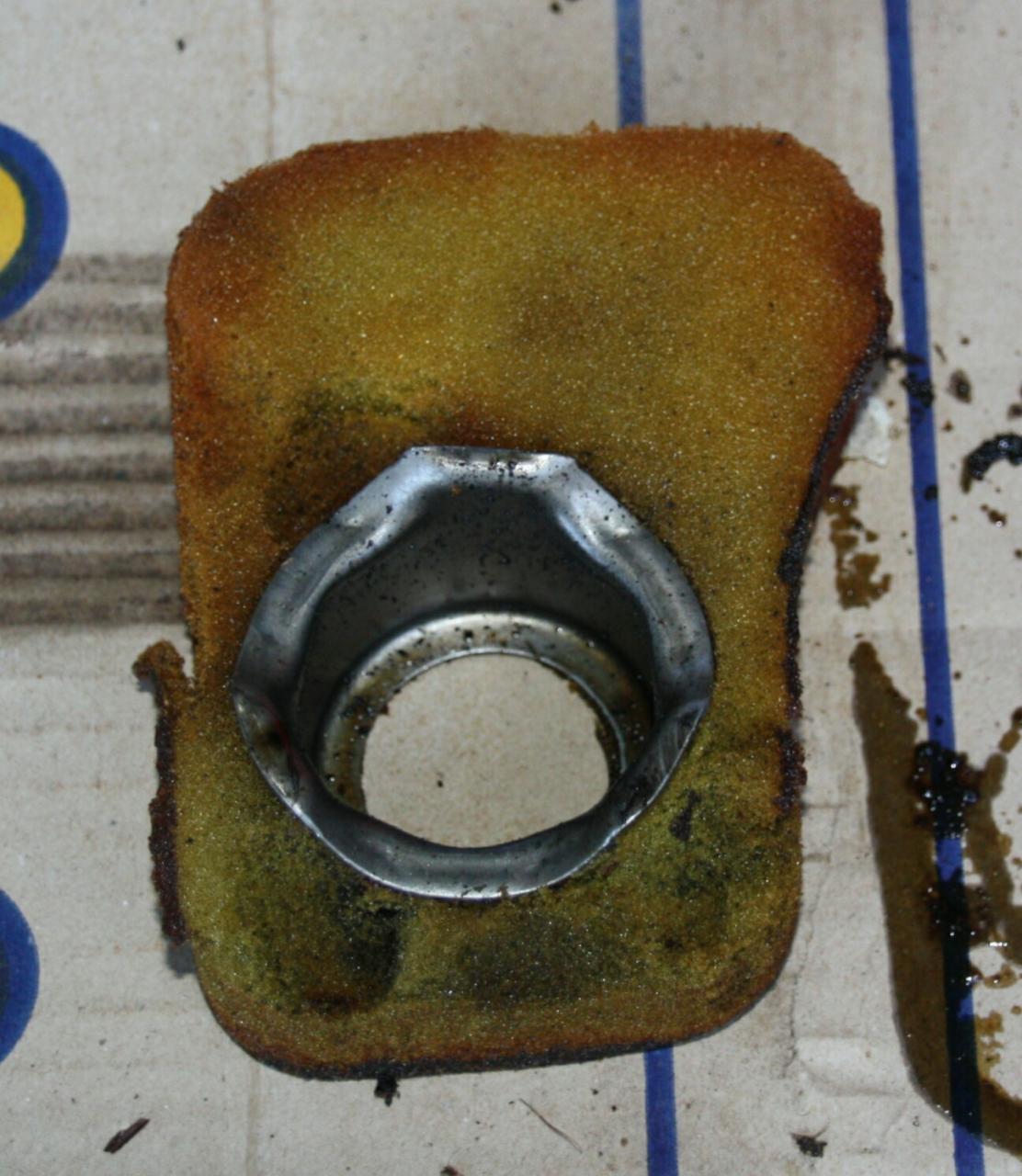

Oiled up the new air filter and lubricated the chains.
The engined started easily, it only takes half a gental pull of the starter. One adjustment it needs is the throttle. When the throttle is at the lowest point it is still running quite fast. I can see that the cable has fully release and then some. Is there an adjustment I can make?

hi donny great news you have you mower back in action again if your shure throttle cable has some slack and engine idle is till to high next step is to remove aircleaner, for under the aircleaner assembly you will see throttle linkages governer spring ect look for the throttle arm lever this lever will have a idle speed screw that controls idle speed when you move throttle lever to slow position try backing the idle screw out a bit to see if that slows it down a bit

Thanks Freebird for your help. When I next started the mower it worked fine so no further changes were required. For the last few weeks I have been researching rust. So many methods available on the internet but most worked well on unpainted parts. What I wanted was to remove the rust with out damaging the paint and original stickers. I ended up purchasing a product called Evapo Rust. It's a non acid based product. I tested first on the air filter lid. Here is how it turned out. ![[Linked Image]](https://www.outdoorking-forum.com.au/forum/uploads/usergals/2016/11/full-10705-31332-img_0410.jpg) Next I removed the cowl and submerged it in the solution. Here are the results. ![[Linked Image]](https://www.outdoorking-forum.com.au/forum/uploads/usergals/2016/11/full-10705-31333-img_0406.jpg) ![[Linked Image]](https://www.outdoorking-forum.com.au/forum/uploads/usergals/2016/11/full-10705-31334-img_0408.jpg) ![[Linked Image]](https://www.outdoorking-forum.com.au/forum/uploads/usergals/2016/11/full-10705-31335-img_0409.jpg) ![[Linked Image]](https://www.outdoorking-forum.com.au/forum/uploads/usergals/2016/11/full-10705-31336-img_0411.jpg) ![[Linked Image]](https://www.outdoorking-forum.com.au/forum/uploads/usergals/2016/11/full-10705-31337-img_0413.jpg) ![[Linked Image]](https://www.outdoorking-forum.com.au/forum/uploads/usergals/2016/11/full-10705-31338-img_0414.jpg) ![[Linked Image]](https://www.outdoorking-forum.com.au/forum/uploads/usergals/2016/11/full-10705-31339-img_0416.jpg) ![[Linked Image]](https://www.outdoorking-forum.com.au/forum/uploads/usergals/2016/11/full-10705-31340-img_0417.jpg) It's not perfect but it has cleaned up well considered the age. Please let me know if you notice anything else in the photos. What should I now do to these surfaces to prevent rusting again. Also the starter cable is now grabbing a lot and not retracting very well. Is there any good threads on here describing how to diagnose this and get it back to normal. Appreciate your advice DonnyW
