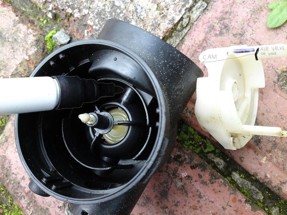

One of my pictures shows the throttle position in the stop position and poppet is not fully open
if it is something is wrong with your carby.

I have worked on hundreds of these carbys and never had this issue you are describing,
my first image of the carby shows full throttle
the second image shows half throttle
the third image of the carby shows stop position,the plastic part can not move any further in the clockwise direction.

The images I posted showed the poppet valve could not be fully open when throttle control is in the off position,
in this image the texta mark on the cam and where the texta points to on the carby body show the fully stopped position,the cam cannot rotate any more in an anti clockwise direction and the 3 leg piece
cannot drop into the deep V.
I did not comment on the the cam profile you drew because I knew it would not work,that cam is all ready designed into the plastic,it' [Linked Image]
s made to match with the air valve at a certain throttle control.
Putting ramps in that do not match the air valve position is a wast of time.If you wish to prove
