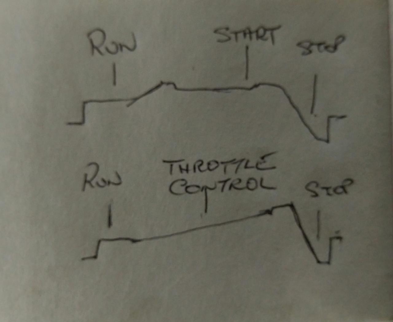

The first drawing is a profile of the cam that raises and lowers the poppet valve, the second is of how I believe it should be to make it work giving full throttle control. Does anybody have any thoughts on this before I modify this cam?

Thanks Max, but as you can see from my drawings when you move the cable to the engine stop position the three leg piece drops into the deep vee allowing the poppet to go wide open, but you do not notice this because in that position the ignition has been cut,so the motor stops, if you have the ignition wires disconnected it will go full revs.My idea is to file a slope between the start position and the run position so that a gentle transition can be achieved with the poppet from closed to open and this does away with the governor which effectively does not work. Thoughts?
NormK #78208 28/09/16 02:37 AM
Posts: 8,215
My idea is to file the blacked out section from the cam in the three places that raise and lower the cam. Any thoughts?

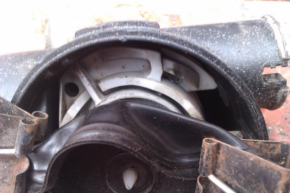

I have worked on hundreds of these carbys and never had this issue you are describing,
my first image of the carby shows full throttle
the second image shows half throttle
the third image of the carby shows stop position,the plastic part can not move any further in the clockwise direction.

Speaking for myself without evidence of what NormK says about the carby,I did not wish to further discuss it,Quote "when you move the cable to the engine stop position the three leg piece drops
into the deep v allowing the poppet to go wide open, but you do not notice this because in that position the ignition has been cut,so the motor stops, if you have the ignition wires disconnected
with the governor which effectively does not work."
The images I posted showed the poppet valve could not be fully open when throttle control is in the off position,
in this image the texta mark on the cam and where the texta points to on the carby body show the fully stopped position,the cam cannot rotate any more in an anti clockwise direction and the 3 leg piece
cannot drop into the deep V.
I did not comment on the the cam profile you drew because I knew it would not work,that cam is all ready designed into the plastic,it' [Linked Image]
