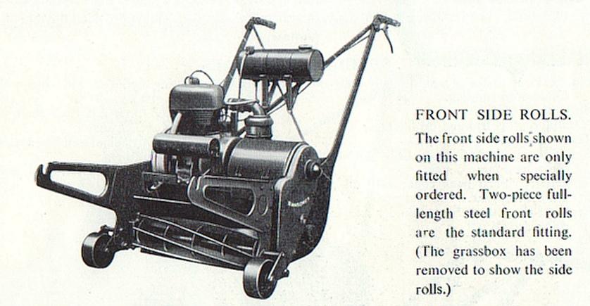

Euro reel mowers have stuck with one piece or multiple front
rollers for fine lawns. They accepted the argument that the front
roller would hinder the cutting of higher grasses, and so
offered side rollers or wheels on commercial machines for parks
and road verges...
The thing is, that USA lawnmowers favoured the side roller/wheel
designs - even for good lawns. I think this is closer to fashion than fact.
