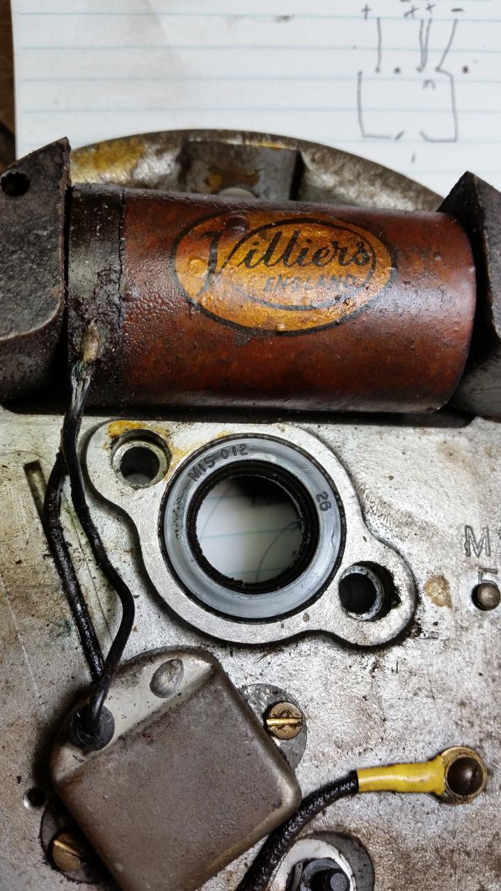

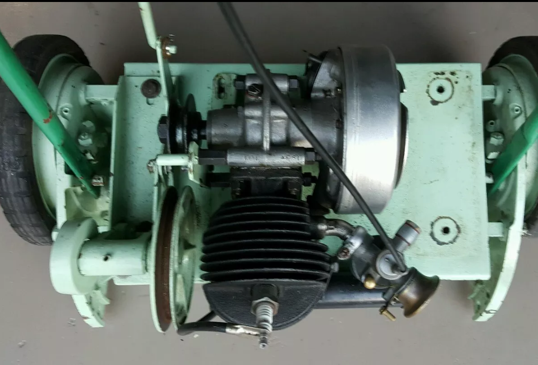

Hi I'm trying to get my qualcast with a villiers 4G motor going.
It is fitted with a Junior carburettor which is from the 5G.This is how I purchased it and was assurred that it used to work.
It had weak then no spark which was traced to a faulty coil which I replaced with a spare I fortunately had.
It now has spark and fires occasionally when rotated with a drill but never quit gets going and stops.
It has some compression and The points are clean and set to the proper gap.
I have tried a new plug.
Could it be the condenser or perhaps the points still ?
Does anyone have any other ideas on what stops these motors running?They seem very simple.I have cleaned up the carb and it's getting fuel through the tickler as well.
I'm running out of ideas...... [Linked Image]
thanks
Mike

Thanks I will have another look on the weekend.Those old coils are really expensive and I can't just buy one to try.Where can they be rewound as I have 3 open circuit second [Linked Image]
ary coils in my parts bin?

Here are contact details for a few rewinders who handle magneto restoration stuff. I haven't dealt with any of them personally, so can't comment on their service.
http://dropbears.com/motorcycles/peter-scott/
http://antiqueautoelectrics.com.au/
http://www.codrewinds.com.au/
There is one mob in the UK who have a couple of cheap Villiers coil types, but I dunno if they list yours. They also have the Villiers condensers.
http://www.feked.com/electrical/ignition-system/ignition-coil/
Some measurements of your coil would be helpful - core and body, diameter and length.
