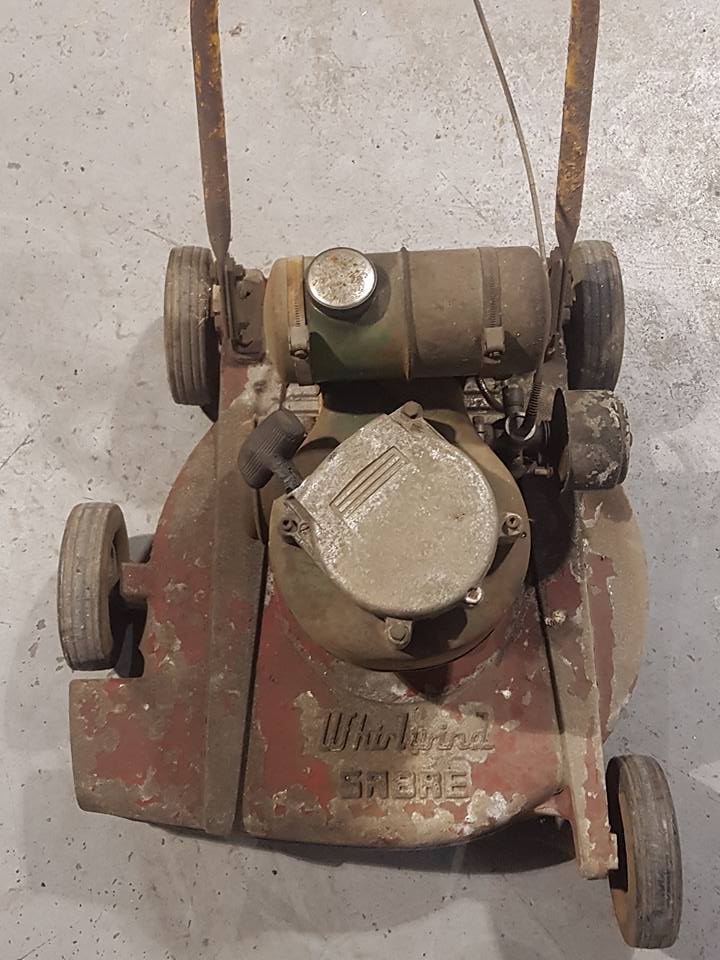

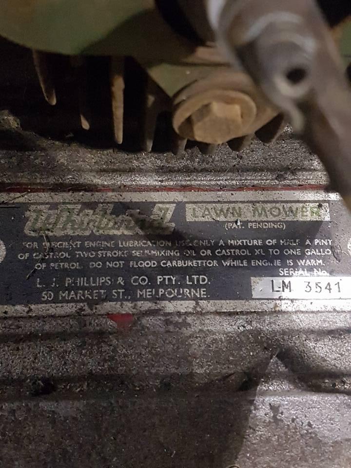

Tonight a third Whirlwind was posted on my page! This time a Sabre.
Reminds me of the Qualcast.
Cheers Adam and Jack!
Thanks for reading!

There is some evidence that the Sabre was made in 16 inch and 18 inch sizes.

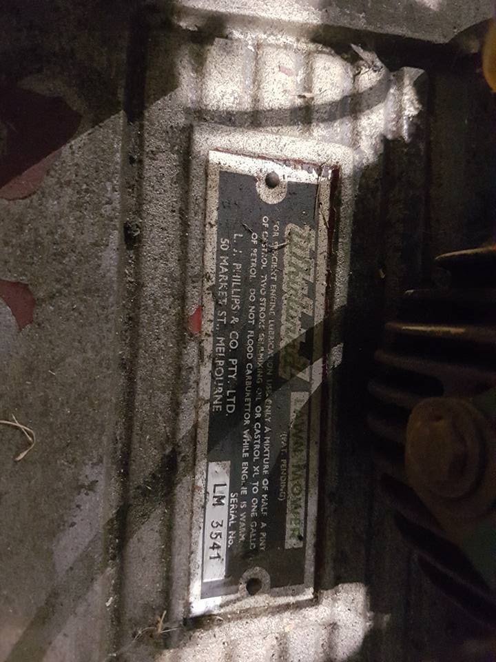

The reference to Market Street refers to LJ Phillip's office, rather than
their factory at Mentone.

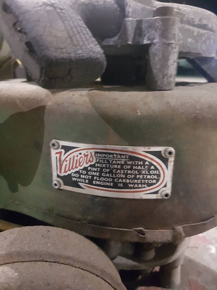

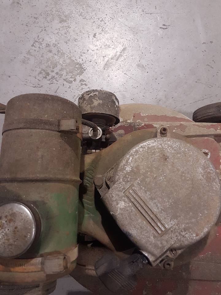

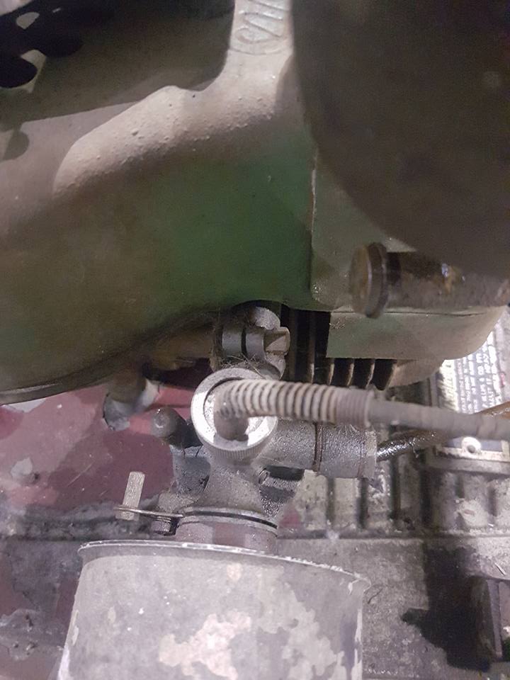

One curious thing is that it appears to have a Villiers engine, but with
a Kirby recoil starter. Is that possible and original?
The answer is yes. Here is a 1957 advertisement.

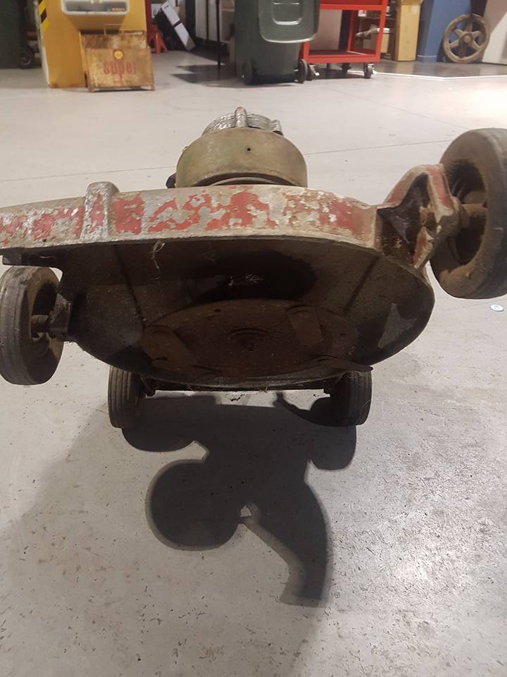

Any other photos of this machine would be welcome (including underneath).

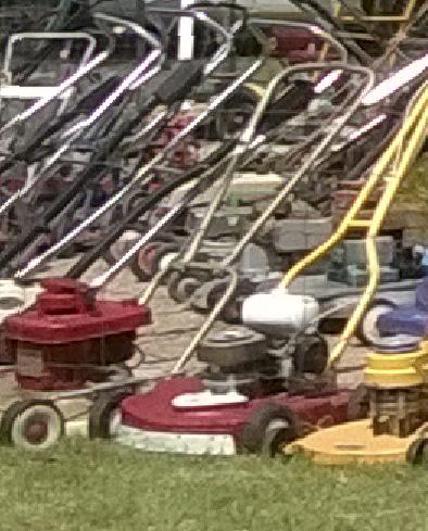

Also at Caboolture I saw an interesting J.A.P. engine, it was the same type as the one on the Qualcast, but it had an alloy base plate, which looked like a section of a Qualcast base! I have his number written down if I do want it.
Do you recon it could have been a store engine? It didn't look cut, it looked cast, but it was the same as the Qualcast. I will hopefully be heading to his place after August as he is local, hope he is enjoying his trip to Alaska!
I think we would need to see a photo.

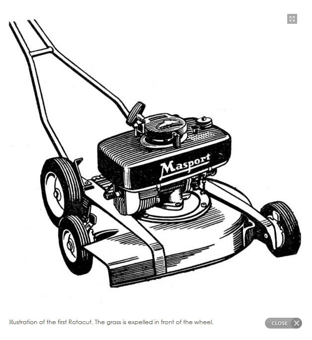

To my knowledge, it was Mason & Porter's (Masport) Rotocut that introduced
this Lawnboy chassis to Australasia. This was Masport's first rotary, and
it was introduced for the 1955-56 season.

The Off-set Wheel Design
Let's say about half-a-dozen AUS manufacturers experimented with the
offset-wheel design in the 1950s. An obvious question is why this
design preference did not survive to see the next decade?
I have seen someone ask the question: "what was the advantage?"
The better question is, "what was the disadvantage?"
Australia rejected the offset-wheel design because it was too difficult
to accommodate what Australia accepted - the single-point height adjuster.
I think it is a fair statement in saying that Australia led the world in
domestic rotary mower design in the 1960s and 1970s.
The single-point height lever was entirely suited to our conditions,
and much more convenient to use! To have this system on offset-wheel
chassis made no sense at all. Here, we adopted the conventional four-square
base, that easily matched the lever and segment design. Victa had this
from 1960, and all the key players followed suit.

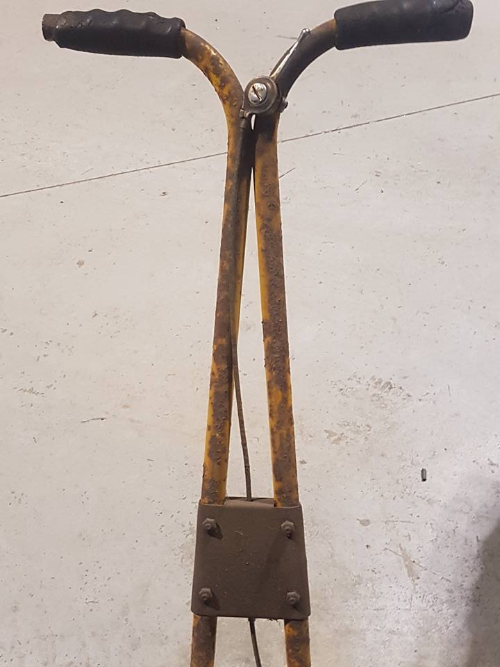

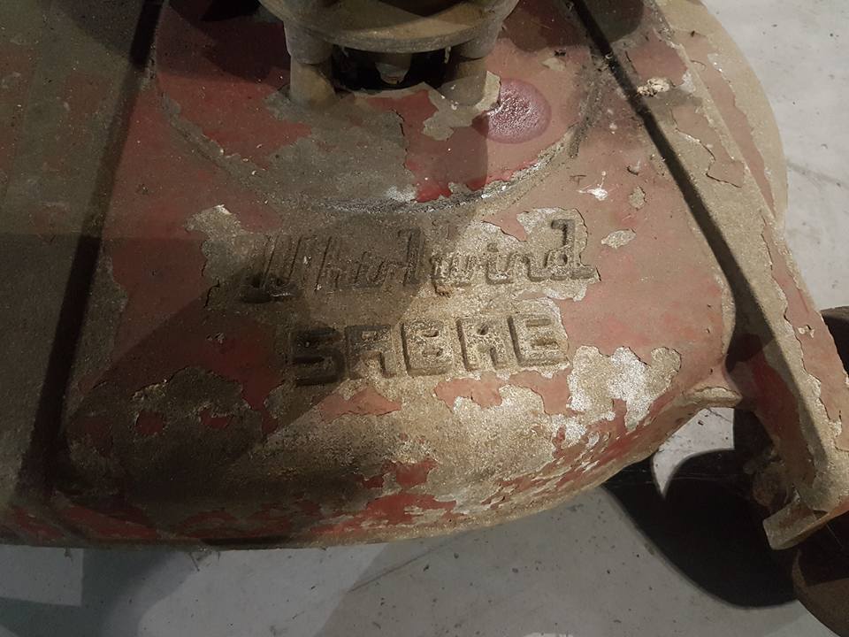

New pictures are in!
Thanks for reading!

Fantastic pictures for the record Kye. Thank you and the owner.
A most unusual colour scheme - red, green and yellow.

Moderator and NZ Historian Alan M has given us a great record for the
Masport Rotacut ...
https://www.outdoorking-forum.com.au/forum/ubbthreads.php/topics/92269/masport-rotacut.html#Post92269
This is the right time to raise the question:
It is clear that the North American Lawnboy influenced some AUS and
NZ lawnmowers. But was that influence direct or indirect.
Alan (link above) has clearly made the connection between Lawnboy and Masport's Rotacut.
My best guess, now, is that the NZ machine influenced the later AUS designs
that appeared here as Whirlwind Sabres, Pye-Tecnicos, and Qualcast Powa-matics.
