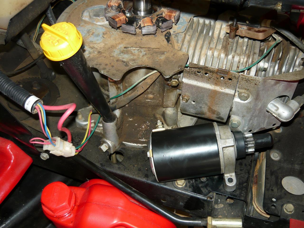

I have a MTD 38� Cut Yard Machine 6 Speed Ride On Mower (13A1762F670) with a Tecumseh 13.5hp (0V358EA-206940F) engine, but the mower now has a couple of small problems.
1. The starts motor a Tecumseh 37425 has a bent armature.
2. The Flywheel (611253) has broken magnets and a cracked Flywheel nut (650594).
Just wondering if anyone out there has any second hand parts that would fit this series mower and does anyone know if you can buy replacement magnets for this Flywheel maybe.
Thanks in advance for any help given.
cheers2 John

Am I correct in saying that the Alternator on this engine (stator & magnets under the flywheel) are ONLY used for charging the battery ? (Some stators have a separate charge coil as part of the ignition system on the stator, it looks like this one doesn�t)
The CDI module must have the charge coil built into the encapsulated ignition module by the looks, the only wire from the module apart from the Spark plug lead is a dark green wire which is used for the Ignition Shut-Off. (it grounds this wire)
On the white connector from the stator���
Red - Alternator D.C. + Lead goes to Red/Black stripped wire & a looped Red wire not connected.
Yellow - Alternator A.C. Lead goes to Blue wire
On the same white connector from the CDI module......
Dark Green - Ignition Shut-Off Lead goes to Yellow wire
So what�s wrong with just taking all the broken magnets out of the flywheel (now NO charging circuit) and just starting it from a separate car battery (because the on board battery is dead anyway) straight onto the starter motor and just charge the car battery up later separately.
The only problem I can see with this idea is that the flywheel maybe out of balance with no magnets on it.
Your thoughts please����
lol"I know just fix it properly"
cheers2 John

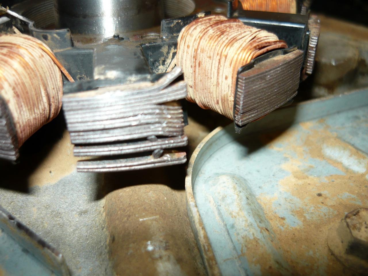

On closer inspection of the Stator, its had it too...........
There are 3 damaged ones with coils & 2 without
Almost now cheaper to buy a new 13.5hp engine, or just put it all back together and wait until i can find some second hand parts to fix it from somewhere.
