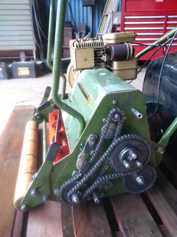

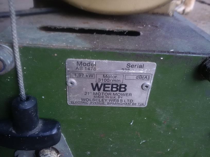

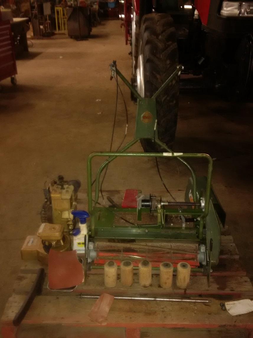

Either way, I am wondering if anyone here can help me? I've recently purchased a Webb AB 1478 21" Cylinder Mower (impulse absentee bid at an auction that got lucky). I am wondering if anyone knows much about them? There's not a whole lot of information on the internet about them (even a digital copy of an operating manual is almost impossible to get) and I want to get as much information about it as possible before I decide what I'll do with it. I have my trusty 14" 45 which I use regularly at home but this is a 21" machine so if it's any good I may use this one and restore my 45 properly.
Here are some photos of it anyway.

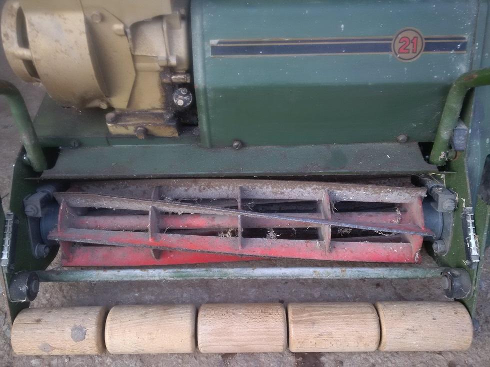

It seems in decent enough condition. It doesn't start yet and the throttle control is fairly but the chain and sprockets don't show an great deal of wear. Obviously the blades need sharpening but the bottom blade seems in good condition too.
Any help would be fantastic!

We can say that the engine is pre-1982 [easy-spin start]. We can give the engine's exact production date, and pointers to a parts list, if you could post the Model, Type and Code numbers from the cowling.

I'd say that the fuel tank will need to be thoroughly cleaned out, and maybe the carby fuel pickup strainers as well.
But Briggs engines are generally fairly easy to fix, if they're not worn out - and that machine doesn't look like it's done a lot of work.

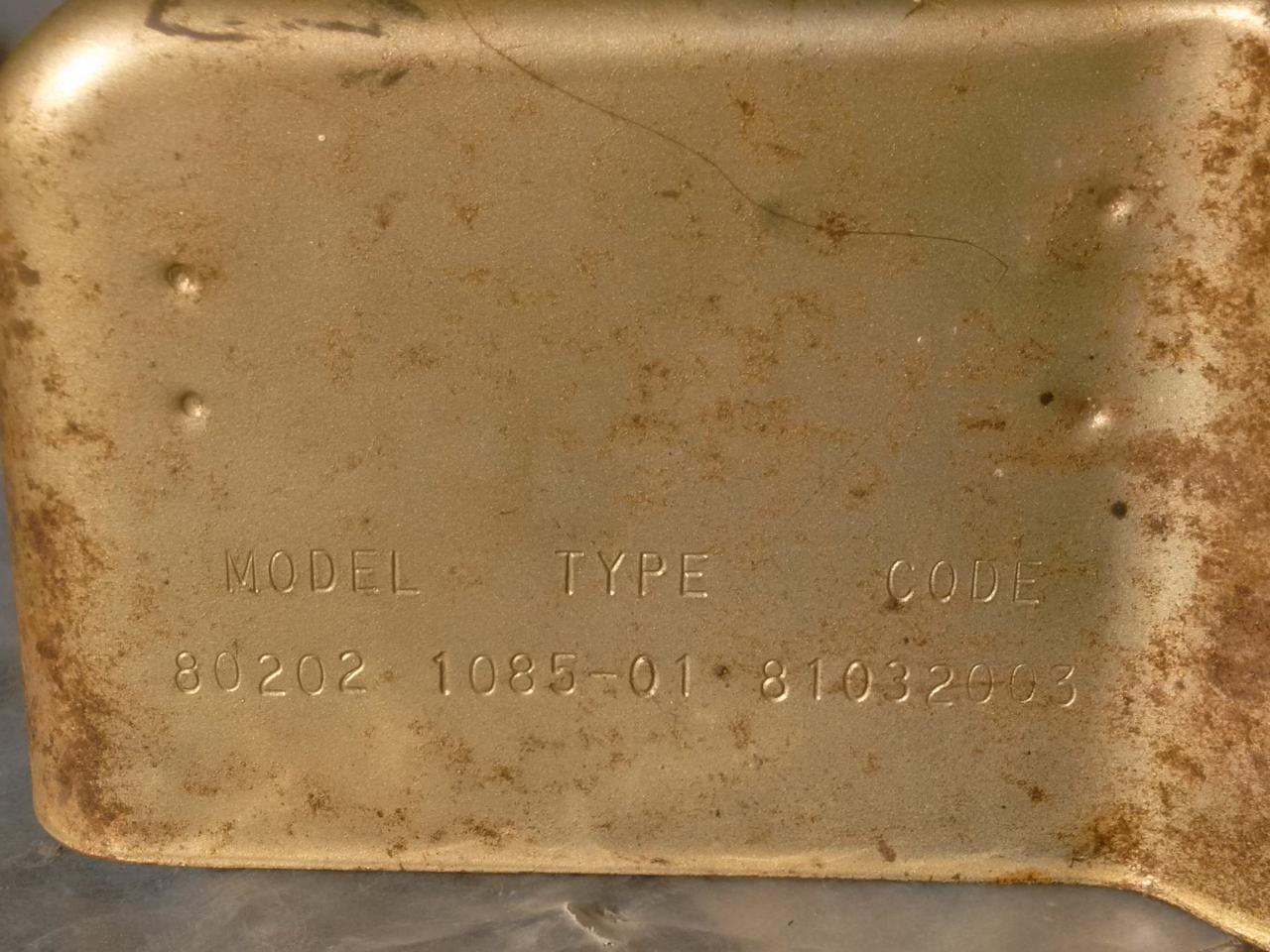

Here are the numbers from the cowling. I found them eventually
[Linked Image]obviously this engine was built 20 March 1981 (my birthday is 20 March 1984).

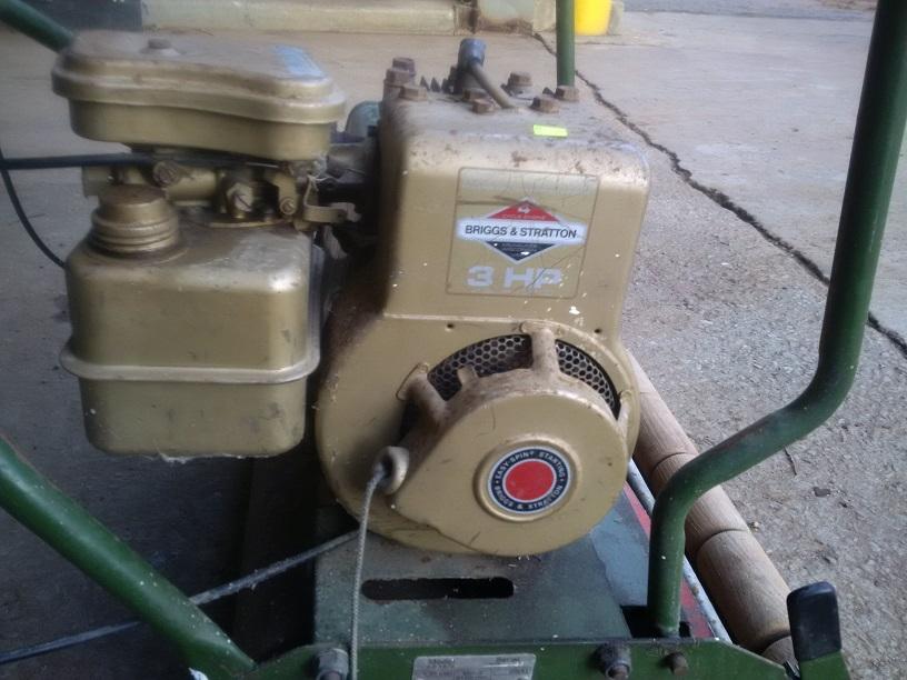

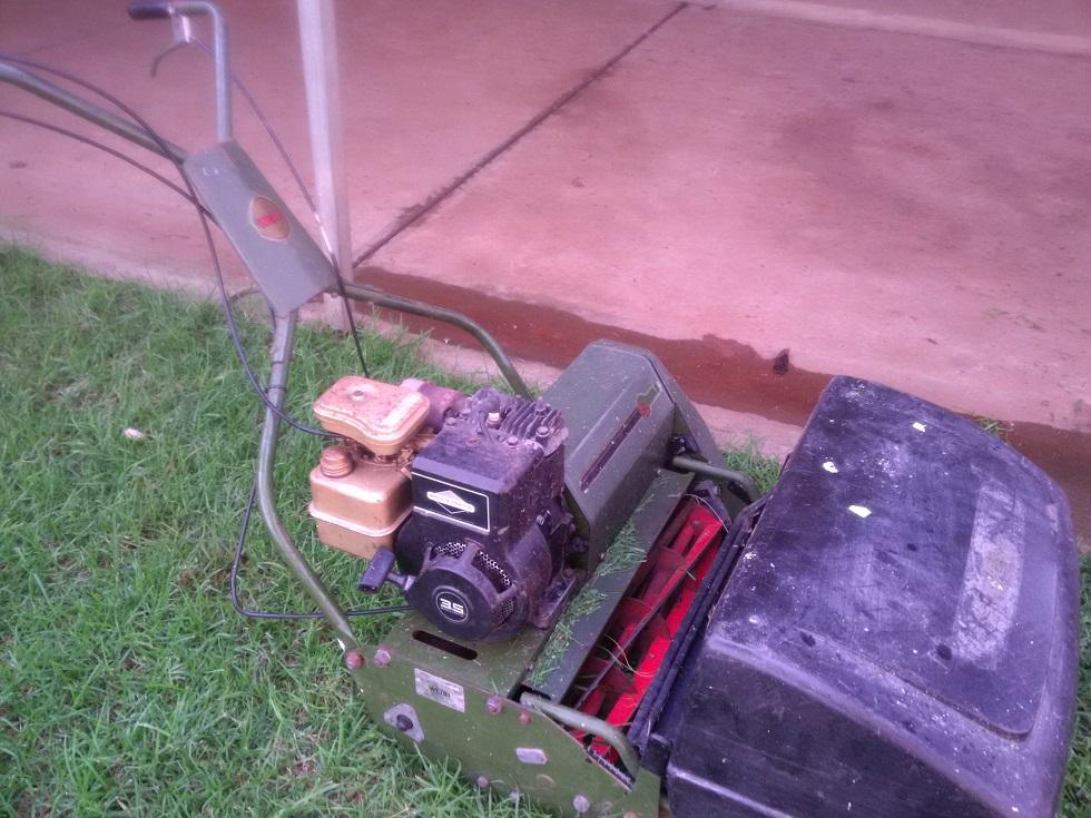

After some thought and an offer of a recently rebuilt 3hp briggs motor for free (more the later wink ) I've decided to put a whole new engine on there. Here it is now. Sorry about the quality of the photo, the sun was too bright so I had to shut the shged door and my phone doesn't take brillian low light photos.

So the guy who offered me the motor also had a rebuilt 3.5hp briggs and stratton motor that didn't have a carby and fuel tank. He offered that one to me too. So I thought the extra .5hp would be better than a kick in the guts so I took that one. The machine runs great! I gave it a little test on a patch of old and over grown Kikuyu lawn in my parents back yard and it pulled through like a tractor. Just need to get the blades sharpened and it'll be perfect!

So I finally got my Webb back this week.
It needed a new bottom blade, one of the blades on the reel was pretty bent so that got a decent straighten out and it was all set for me. The old bottom blade was so worn you couldn't even notice where it should have bent upwards at the tip.
It runs great, and now it mows great too!
