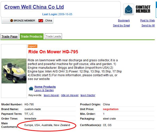

OK For those who are interested in this ride on, I found out what it is and where it came from.
I was made in China by a company called Crownwell China Pty Ltd. It's model number is HG-795
Here's a link top their website where a picture on my ride on is shown as well:- http://harryshanghai.en.ec21.com/
Thanks for the help I got here..
Steve

Hello Steve
That's a bit of detective work there!
It shows the degree to which garden machinery has become the province
of mega-factories that sell their products to 'manufacturers' who
then claim the make as being of their own manufacture.
The interesting thing about that link is:
The address is certainly not a factory.
And 11-50 employees didn't make all those products.
I guess Crown Well is the sales, distribution & export company.
The fact that they make their products for various 'customers' in
"Europe, USA, Australia and New Zealand" shows how complex it is to
identify what actual brand your machine was sold as. The brand name
is 'custom made' to suit the customer. A different bonnet, change
of colour, and other cosmetic changes, and X company has a new mower.
I guess my question is: how do you get spare parts without knowing
the actual 'customer' it was sold to? It could be any number of 'makes'.
All very confusing for the poor consumer. frown
Yep, for sure that is the main problem with an 'orphan', such as this one. Just as well it was cheap!
I'd say it's unlikely that this model was marketed by any of the major brands, but of course I could be wrong.
The other headache with these 'generic' products out of China is lack of documentation.
Stuff that we would regard as fundamental, like owners/service manuals and illustrated parts lists, are just not something the Chinese see as necessary to produce, if left to their own devices. They are much the same way with providing spare parts, too.
