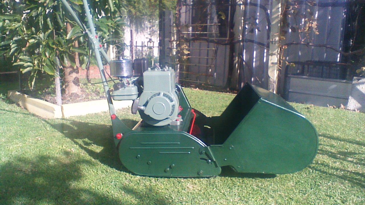

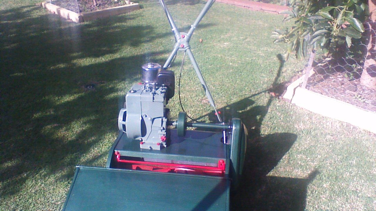

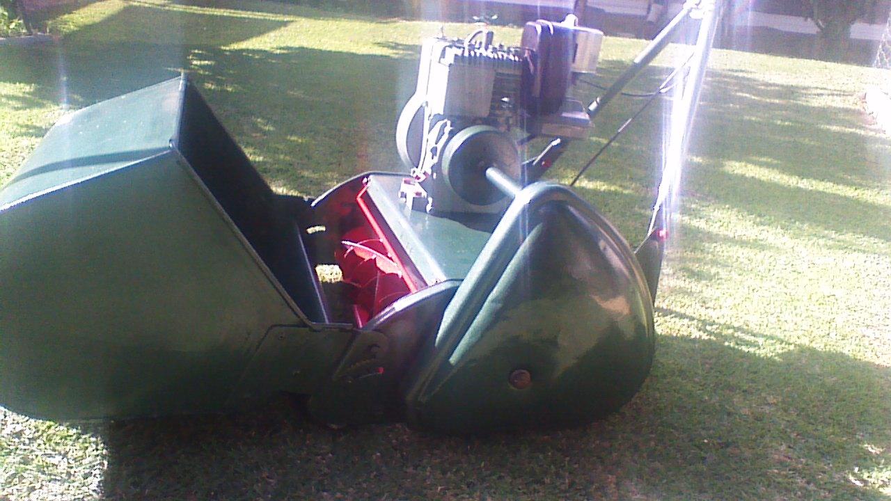

Here is the old girl looking a bit better in her close to original colours, yes I gave the Briggs a coat of paint to match the original colours so it looks more original than it is.
Thanks Gadge, I have messaged our decal man along with photos and sizes of decals for my Scott Bonner 590 and he is in the process of making them up [Linked Image]
If it don't go its not good.
Here is the old girl looking a bit better...
A bit better would be an understatement Andy.
She looks sensational!
I guess, now, the issue is the longevity of those plastic bevel gears.
I have not been able to ascertain whether Masport still uses these
gears on current machines.
p.s. That lawn looks pretty good too.
