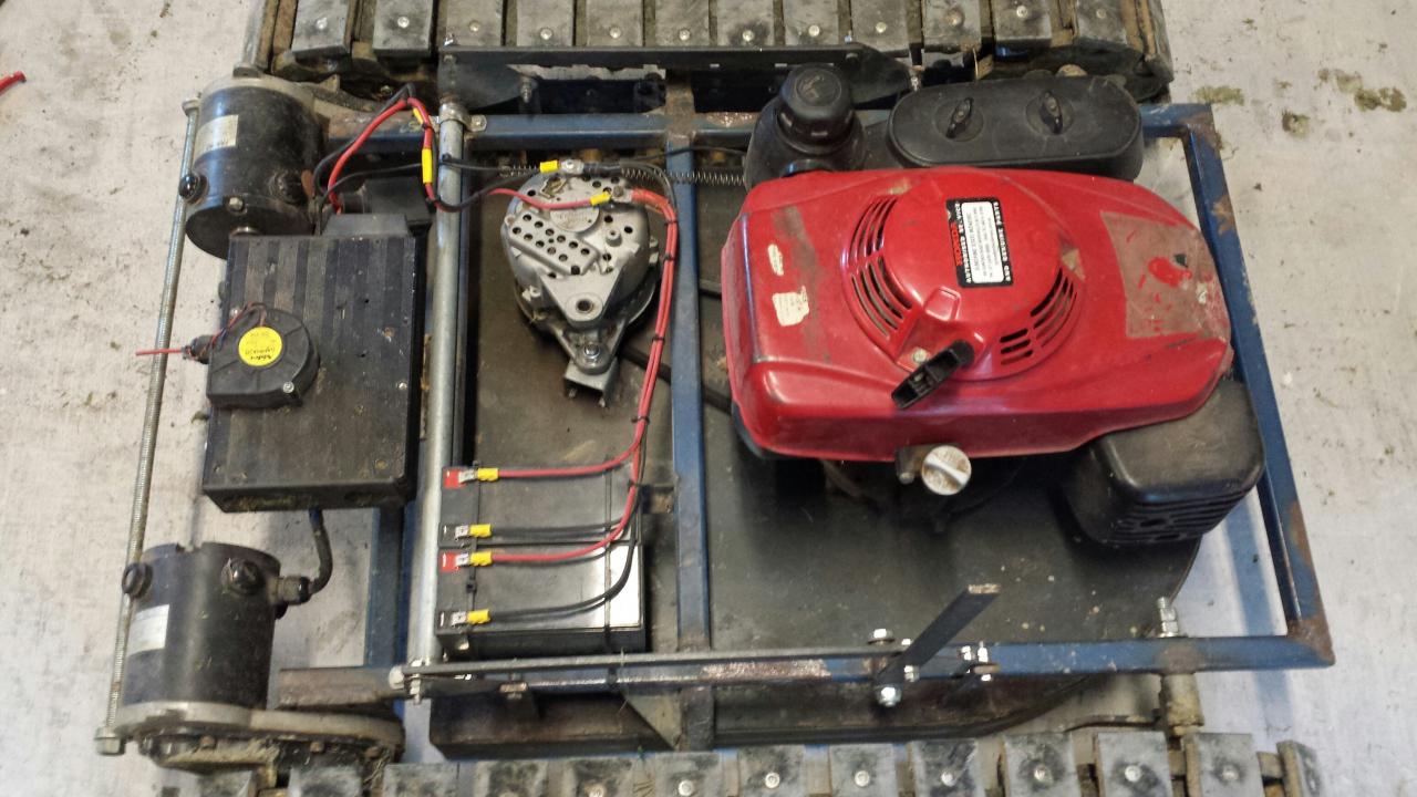

this is my latest toy and contraption I put together over the past 8 months with help from youtube.
5.5 hp Honda power plant courtesy from my neighbour , 80 amp mitsubishi alternator from the local weekend markets two wheelchair motors , batteries and electronics of flea bay, 50 bucks worth of steel 200 hrs of sleepless nights and one sore back trying to get it back into the shed after countless unsuccessful trial runs, lol
I will gladly help out with info if anybody wants to attempt a build like this.

But seriously, I'm in awe, wish I could attempt something like that, let alone succeed! How did you manage to make the tracks??? good1

Regarding the tracks, they are made from old quarry conveyoor belts and hardwood timber blocks with ends rounded off in a wood turning lathe.

Brilliant job well done, where did you mount the alternator?

Brilliant piece of engineering, I can see bigger versions being used by contractors who mow the high slopes on the sides of freeways. Basic but very functional. I can see the need for the big alternator because it has to run the drive motors and the dual pulley on the motor is perfect to use to drive it because it wasn't needed to drive the mower. What did you end up using for the control box setup. 200 hours, I can see every bit of that

Motor controller from the wheelchair was knackered so I gutted the controls and kept the box. Bought a Dimension Sabertooth 2 x 25 amp motor controller anf fitted that inside the box. I had an old fan from a dell computer that came in handy for cooling.
