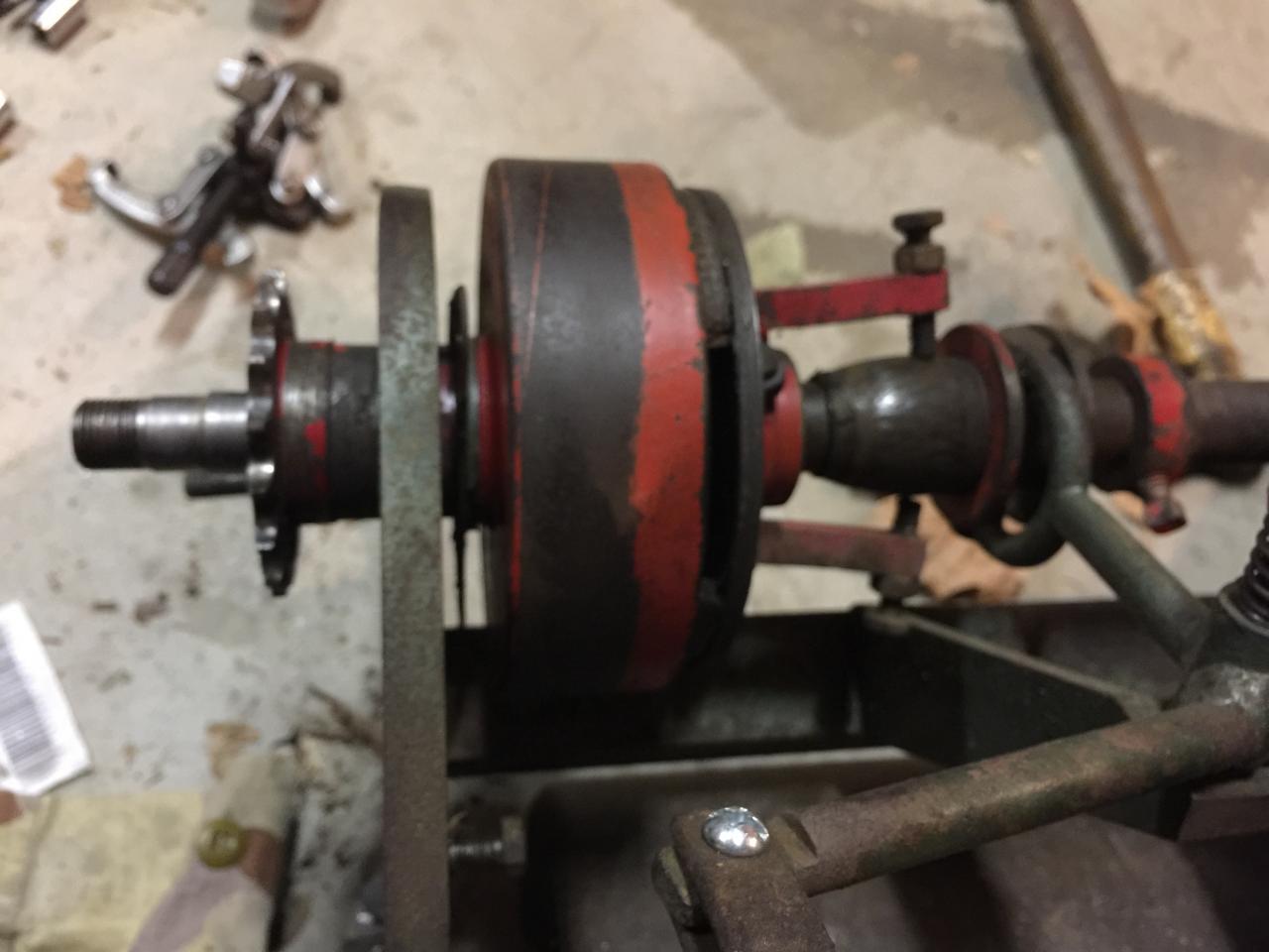

Two things have got me stumped and I hope team ODK can offer some advice
1. how do I separate the clutch outer drum from the gear? Note the bad wear pattern on the drive gear, see point 2.
2. this bearing is FLOGGED out and needs replacing, how does this come apart?
Any help would be very helpful.

well i managed to replace the flogged out bearing the crank handle socket is effectively the nut (59) on above once this was undone. was able to replace the bearing. For others bearing part no 64 is a bearing no.6203 40mm x 17mm x 12mm.........and cost $4.20 from veales.
this pic is part '59'
everyone likes pics and i think it is beneficial to other supercut owners to document this!

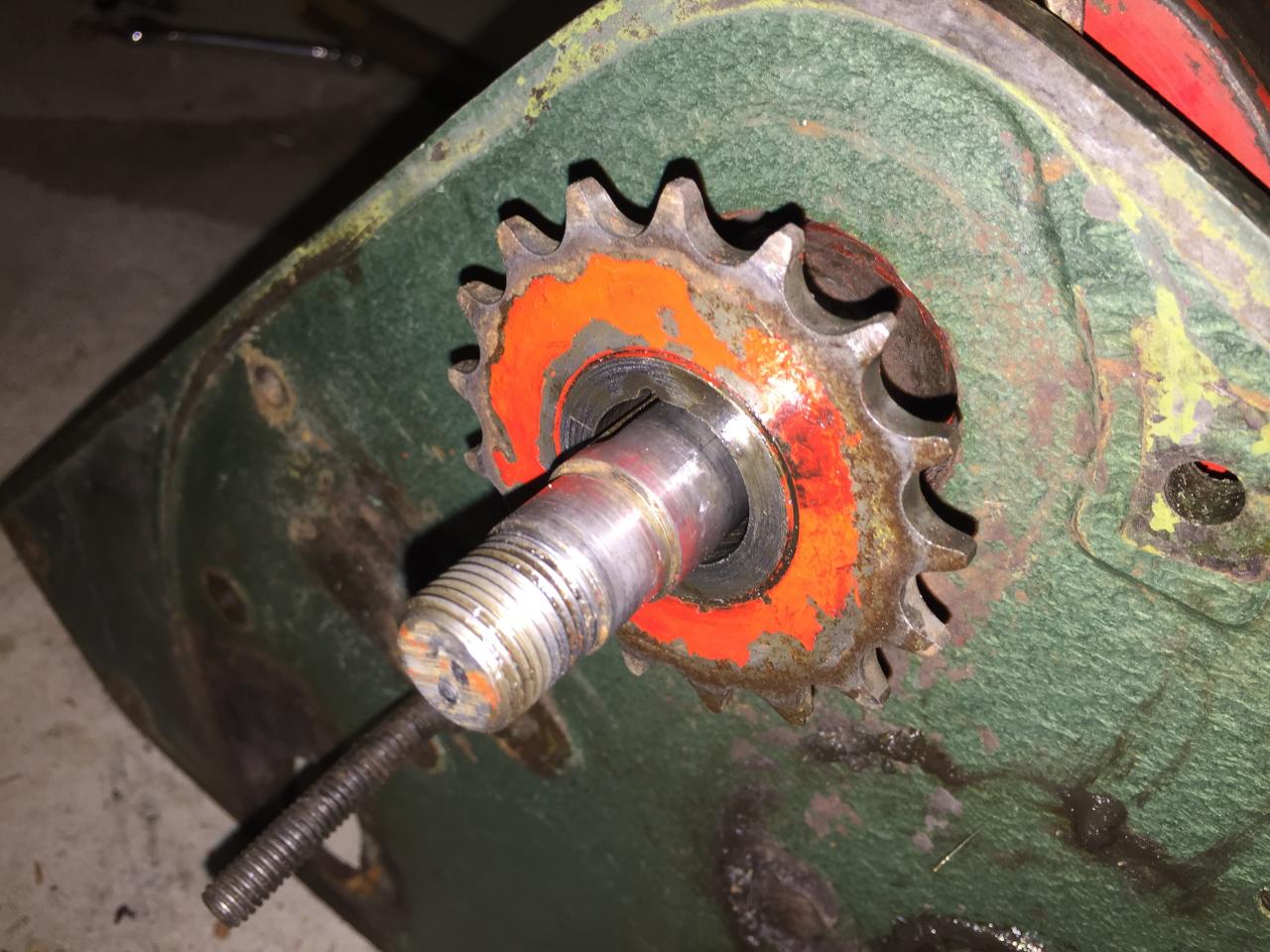

Hi all, Just wondering how you removed the reel on the Supercut? I have read the manual and it does not say anything about removing the drive sprocket but I can�t see any other way to remove it. It appears the drive sprocket maybe screwed on? If so it is supper tight and does not want to budge. Any help appreciated.
Also my drive sprocket has lost a tooth. Does anyone have a spare?
Drew
Hello drew2229au
The sprocket will be screwed-on and it will be a LH thread.
A swift shock with softwood and mallet in a clockwise direction
should release the thread.
You can 'lock' the reel when doing this by placing a similar
wood block in the reel spirals.

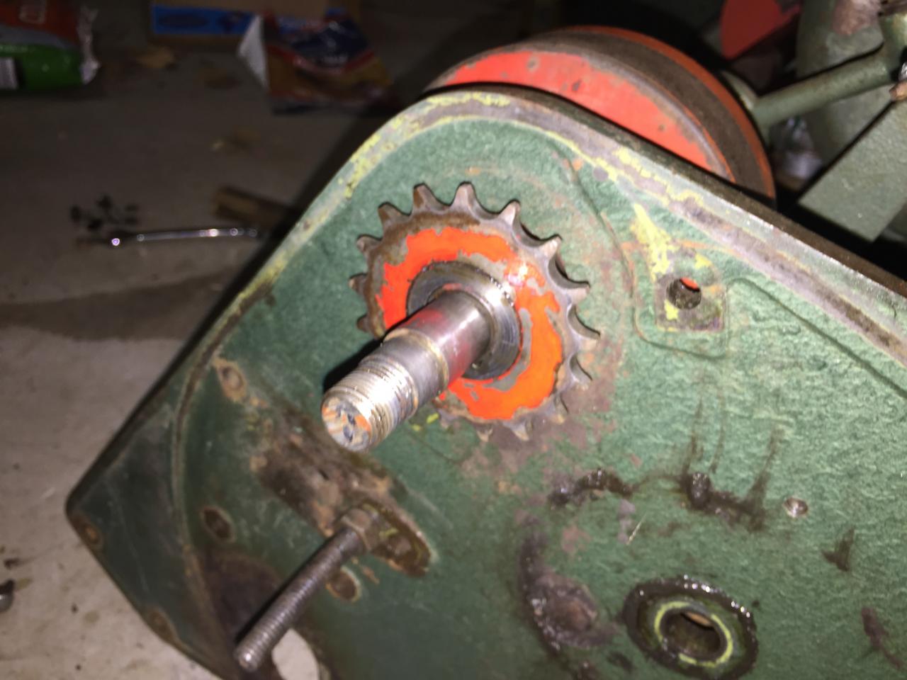

I do have a spare drive sprocket. $30 + Postage. Let me know.
Joined: Sep 2015
Posts: 24
Hi all, I have been trying to remove the front drive shaft. I have removed the drive gear assembly and want to remove the reel drive sprocket. Problem is the drum wants to come with it. Obviously the drum transmits drive to the sprocket. I can't see any grub screws and I'm guessing it maybe splined?
Hi drew2229au
I need a bit of clarification here.
What do you mean by 'the drum'?
