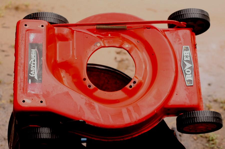

Here are some shots of the mower.
Posts: 693
Yes, I have one of those.
I can get it to Redcliffe for you probably some time after the school holidays. As you can see, corrosion free, still even has most of its underneath paint and only some "kerb" scratches along the edges between the wheels. Comes complete with the wheels and height adjuster delivered for $20. Without the wheels etc, $30 :-) If you are interested PM me your phone number and when he gets back to Redcliffe my mate will ring you and arrange a time for you to pickup.

That looks pretty good. What about the alloy base? I guess a catcher might be a problem with that option.
Posts: 693
Yes, the alloy base is a completely different set up and your catcher wouldn't fit. The handles on the alloy mount to the side of the rear chute and the base is quite flat except for the final upsweep. Regarding one of your earlier comments, yes Rover did make a 2 Stroke utility, flat circular base like a Victa and used the Suzuki engine. I got the remains of one from the dump and fixed it up with an old B&S and flogged it at a local auction.

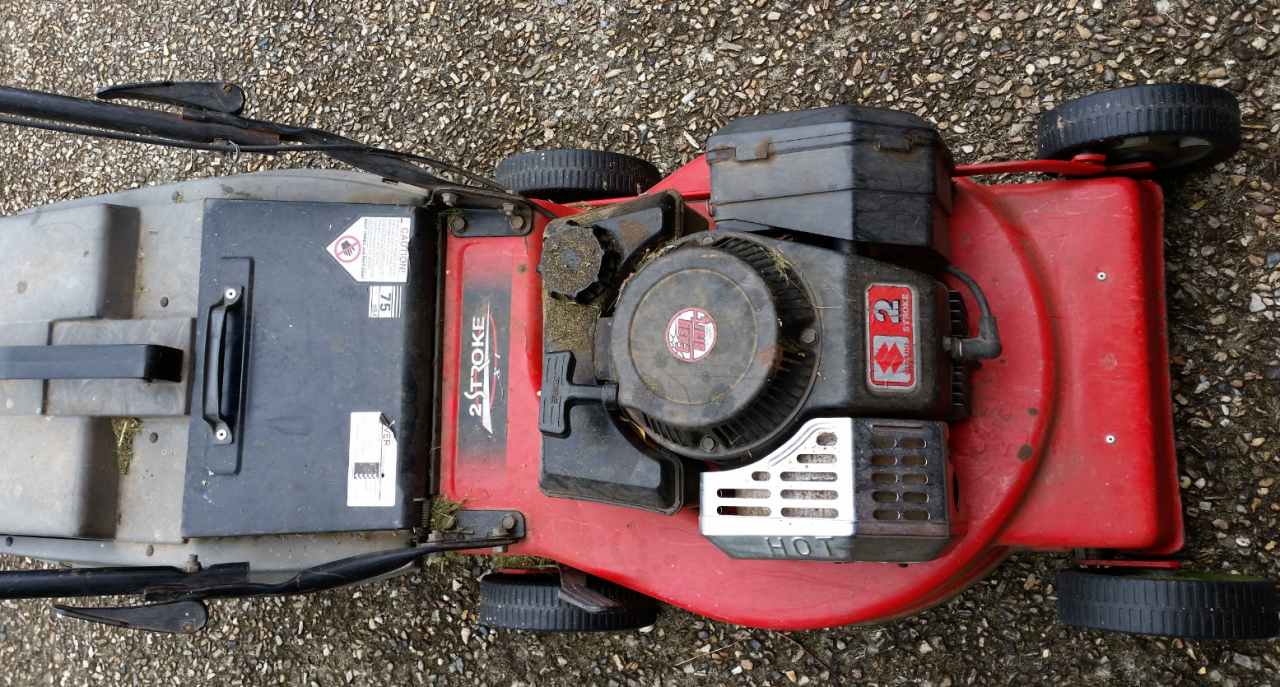

Posts: 8,216
I got working on one of these today, interesting machine, I had to do a carby strip and clean and as usual the governor springs had been attacked b y some previous owner. Quite a good machine in good condition except for the front lower edge of the base has been broken off due to abuse which is a surprise because of the condition of the rest of it. I have it starting fairly easily now, it had no hope of running when I got it, needle was stuck solid in the seat, which is still a bit of a problem because now it won't shut off and the motor is surging on the governor, not sure if this is related to the needle not shutting properly. All in all as stated earlier a good machine

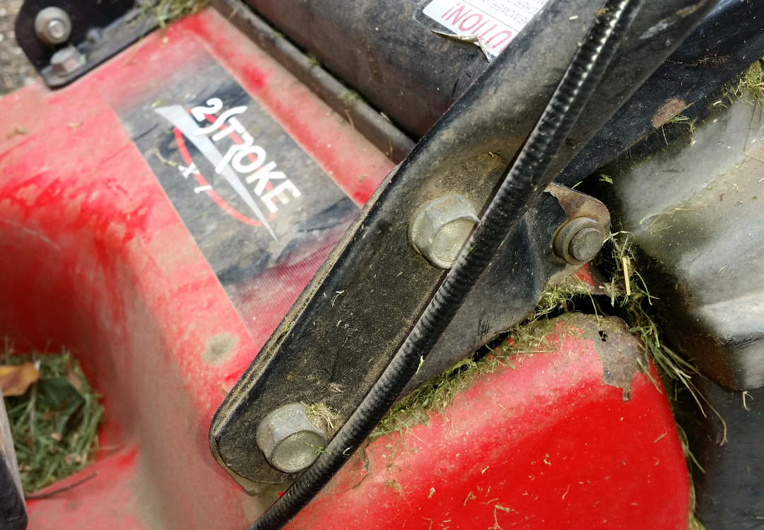

Hi Trev, I have this motor running fairly well now and it starts easily but somebody as usual destroyed the governor spring in a vain attempt to do whatever these people think they are going to achieve when they have no idea as to what they are doing. It is the top spring in the pic that I would like to know where it is supposed to go, the left end is in its correct place by the look of it it is the right hand side that has been all botched up
Posts: 962
Hi Norm, im pretty sure it goes in the same hole as the governor linkage in the governor arm.
Posts: 693
Yep, they just parallel each other to stop governor flutter.
Posts: 8,216
Thanks Bigted and Trev, the spring had been all bent and they had it sort of in the hole half way down the governor arm. Great motor, must have been a bit of a flutter by Rover to enter the 2 stroke market, I guess the idea didn't last too long, although there is the odd one on Gumtree and ebay. My opinion on the 2 strokes is that they are a grass cutter/lawn mower, the 4 strokes are for lawn mowers

Ok so I fell for it once again. I got a Suzuki 2 stroke motor with a pile of powertorque motors I picked up earlier in the week. I went to bolt it onto a Greenfield base I had sitting here that had a Briggs Quantam motor on it. I couldn't believe the bolt holes are not Briggs pattern, which means that the Rover Suzuki 2 stroke mowers must have had a different bolt pattern. This I find hard to believe
