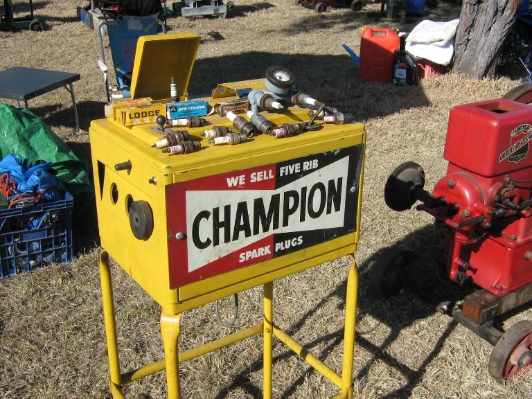

how does this thing work?
Spark plug cleaner, the seller wants 280

Yes, these are indeed a mini abrasive blasting unit, powered by an external compressed air supply.
Bad karma for a small engine shop. To quote my 1981 version B&S Repair Manual [their emphasis]:
Spark Plug Cleaning
Clean spark plug with a pen knife or wire brush and solvent and set gap at 0.030" (0.75mm) for all models. If the electrodes are burned away, or the porcelain is cracked, replace with a new plug. DO NOT USE ABRASIVE CLEANING MACHINES.
They were particularly verboten with Victa, as the sticky 2-stroke fouling could trap abrasive grains. To later cause disaster, when they re-emerged in the bore...
The only places I've seen that actually used this type of machine were aero engine maintenance workshops.
Aero engine plugs, as well as being large and expensive, are very prone to lead fouling when 100/130 [or even 115/145!] octane number leaded aviation gasoline [avgas] is/was used.
Not so much a problem with the current 100LL [Low Lead] avgas, but even that has twice the lead level that the old Super grade leaded motor spirit had.

It's also a tester. Vibrator and coil provide HT. plug is screwed in where shown in the photo and the spark end viewed thro the little viewing glass just in front. Compressed air is applied to the chamber the plug is screwed into. The gauge is supposed to give an indication of pass or fail based on compressed air charge and gap (?)

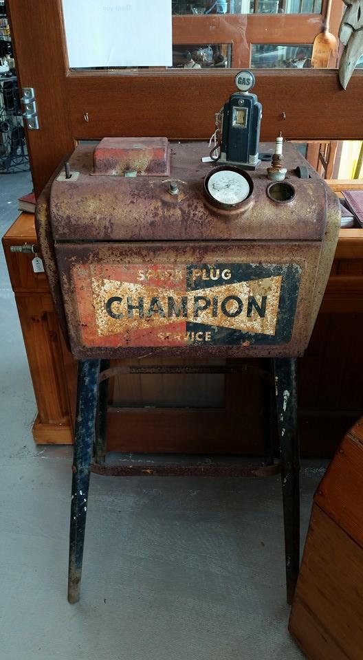

Yes I have a restored one different model and work as above
I use mine to test magnetos
