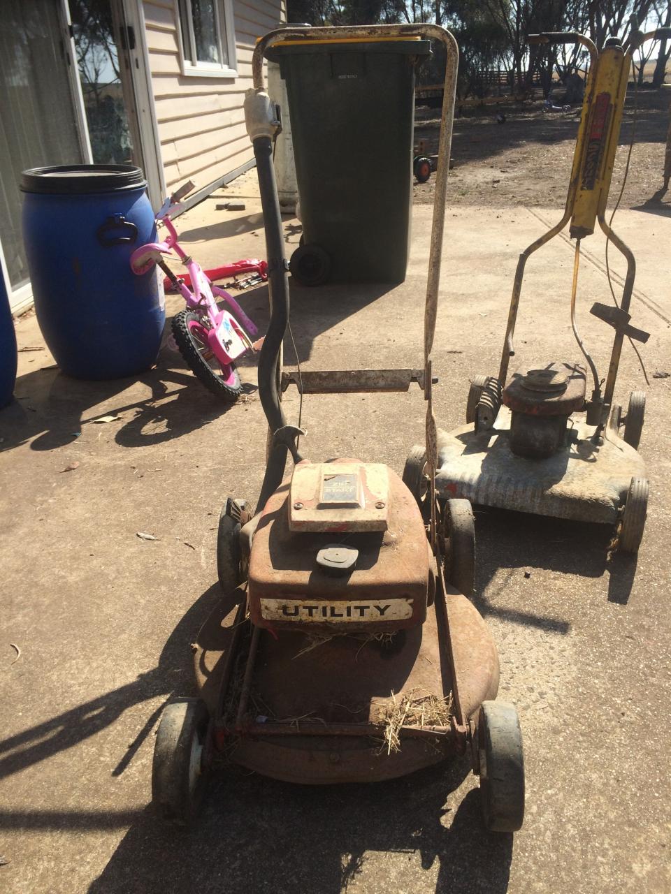

I acquired these beauties yay and was hoping for a little help confirming their identity.
If I'm not mistaken the Victa is an early 70's 125 utility. Probably not a great deal more to say on that.

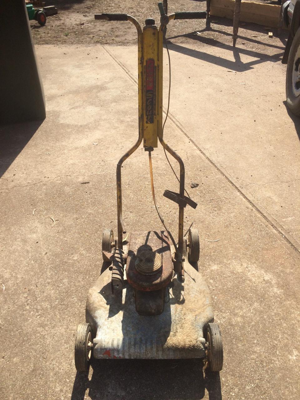

On the other hand there's the mid 50's Lawn Scout.
I tried the search here on ODK and apparently there's some trick to driving it as I turned up nothing. However doctor Google brought me back here to one of Mr.Davis' postings on these machines. Does anyone know anything more of them? I had always been reluctant on "other brand" vintage mowers thinking they'd made their own motors and I'd never get parts or info on them then after reading about Popes Pope with the Villiers it all seemed to make more sense if the manufacturers used readily available motors already in production, like the Villiers. Then reading what Mr.Davis had to say I reckon it might be a long shot to find missing bits.
Any suggestions where I should start before trying to get them started? Just a carby clean, check for spark and perhaps some spray in the inlet to make sure she's lubed up before turning them any more?

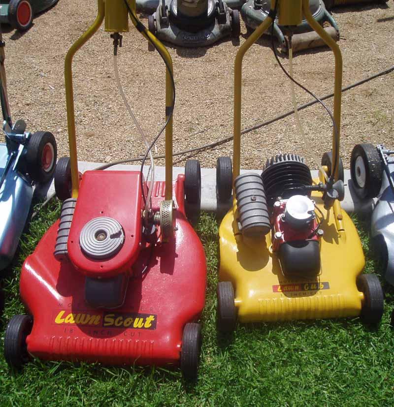

Image: Patrick, Vintage Mowers

So that's what she would have looked like in her former glory. Theres traces of red paint on the deck and half a muffler. I don't like my chances of matching the other half of the exhaust but you never know.

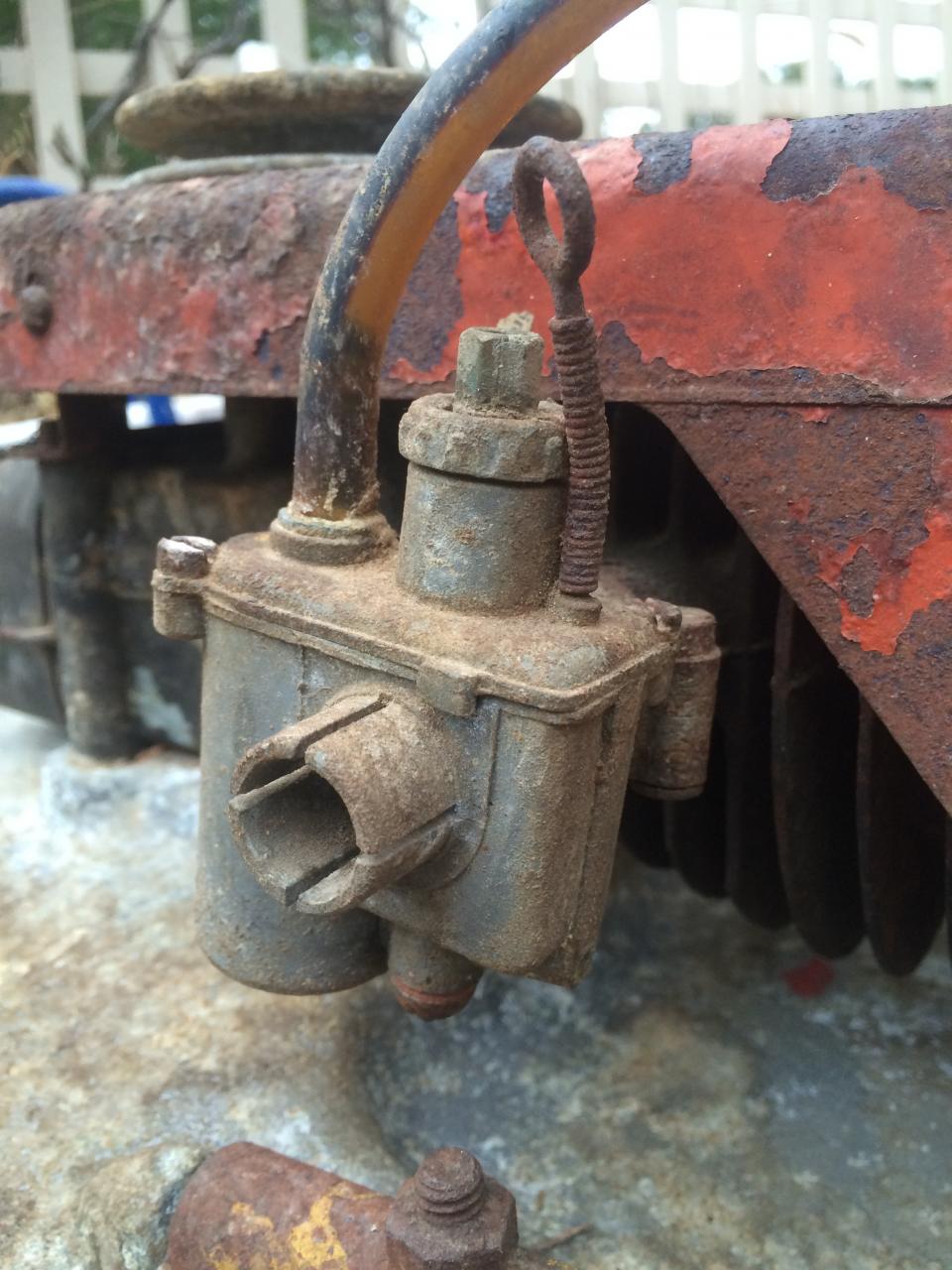

G'day AusAnzani firstly congratulations on your restorations they truly are to an exceptional standard. To be honest mate I have done nothing more than to turn the pull start by hand to make sure she wasn't seized. I wanted to find out a little more before i start pulling it to wee bits and can't find parts.
I can see I am missing the air cleaner and outer half of the muffler.
The carbys going to need some sorting.
The electrical cover at the front still looks solid.
I'll pull the cover off later for a look and to make sure that crankcase seal you speak of is still solid.
Is there anywhere I might be able to track down the muffler half and points or whatever else I may need?
Mufflers for these are not easy to come by. I have however seen 1 or 2 at various swap meets over the last 3 years. Might be your best option.
What you've got there is the older style carby. Does it sit properly over the intake or is there an interface of sorts between them. I do have one but it belongs to an older style CG outboard that I want to restore one day.

G'day AusAnzani thanks for the help. The carby is held on with a hose clamp so looks like plenty of room for improvement. I had started to think it might be a bit daunting but you've given me back some confidence. Thanks again mate.
